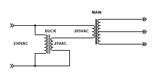

My Beard P50 power amp heaters are AC. ECC82 + EEC83 + KT88
I have no diagram but the AC appears to come direct from a secondary winding. I was getting 6.7acv which is on the high side. My mains comes in between 239-242v which is probably why the heater tap is a little high.
Today I have added an Isolation transformer. I was hoping it may also drop the volts a little. However, it is adding around 5v. I have not rechecked the heaters but I expect it has nudged this a tad higher.
What is the best way to bring the volts back towards 6.3v?

Here's a bucking transformer connection to reduce the voltages by about 10%.
A 12VAC transformer would reduce the voltages by about 5%.
The buck transformer's secondary current rating should be greater than or equal to
the main transformer's primary current rating.
If you don't already have one, add an inrush limiter on the primary side. You'll drop a volt or two on the primary. ]
The power amp is AC to the heaters. My pre amp is DC.
Both would benefit from reduced inrush I think providing there are no negatives to this. I do hear a start up surge through the speakers a few seconds after power on and sometimes an over glow on the valves.
Where and what would I be best fitting?
I can't give you an exact answer as to which IRL to use. See the attached specs.
Choose an IRL that is rated a bit higher than the rating on your fuse. If your fuse is rated at say 4 amps, choose an IRL that has a 5 amp rating. The resistance decreases as the IRL warms up. Look at the table on the right side of the specs.
It will go somewhere between say the power switch and the transformer primary.
I don't think an IRL will give you all of the voltage drop you need. But it will give you a bit and provide of a soft start function.
You might need to add some resistance between the trans filament winding and the tubes. Hard to say exactly. I'd use two resistors, one on each lead from the trannie. You'll likely wind up with something between 0.1 and 0.5 ohms, likely with at least a 10 watt rating. Add up the total filament current drawn by the tubes and use ohms law to calc. the resistance needed. It might not give you exactly what you need but it will be a starting point.

I fitted a bridge rectifier to each mono side (uses separate transformers for each channel).
Its what I had in a draw. Wired as per the previous link.
With the Isolation transformer in place I rechecked heater voltage. It was 6.9vac. After fitting the rectifier I now have 6.1vac.
I also fitted 500r pots to add humdingers. Those don't make any difference to the low level hum I get.

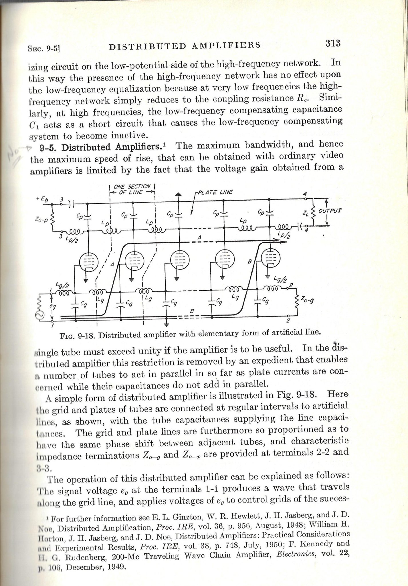

TEK found that the tubes in the vertical amps of their 540 scopes had a problem called 'interfacing'.Still curious about a more extensive explanation of cathode “poisoning”.
A layer of material formed under the outer layer of emitting material, in circuit it looked like
a poor conduction layer in parallel with a capacitor under the surface.
The problem was fixed using 6DK6 tubes, my recollection there were 12 of those in the vertical amp.
The amplifier in this case is a PP Distributed design, something we won't find in audio.
But there could be tubes, both new & used that might have the 'Interface' problem.
