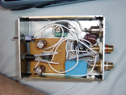

I have a 6DJ8 running in a low voltage application. (15V) In this application, heater supply is diverted from the 15V. I am using LM337 in current source setup to give me about 300mA like the tube spec sheet tells me.
I believe I am feeding the tube with that much current should be OK with the tube. But then I checked the voltage drop across the tube heater; which is running around 11.5V or so.
I feel the voltage drop is coming from the heated filament which is compensating for the heat emission to the manageable level. But the I am no specialist. I am pretty stumped at this time.

Tomo said:But then I checked the voltage drop across the tube heater; which is running around 11.5V or so.
Hot or cold?
I don't understand this. If you genuinely have 11.5V across a 6DJ8, the poor thing should be lit up like a lightbulb. Surely you would notice if this was so instead of a dull orange glow? Are you sure you are measuring across the heater pins with the valve in place?
The tube is running at 11.5V HOT. But then it is fairly dark glow to me.
The important thing is that there shouldn't be more than 300mA (266mA) across the current source which is connected in series with the tube heater filament. (Voltage drop across the current source is 3.5V. So 15V total.)

I am running a LM317 CCS for each of my 6922, set at 300 mA, very much like your 6DJ8's, and all is fine and dandy.
Don't take this the wrong way....are you actually measuring the 11.5V across the filament or just assuming that from your 3.5V measurement? And your current set resistor for the 317 is about 4 ohms?
Hey,
Yeah, I did use the RADIOSHACK multimeter to measure both locations. The filament at about 11.5V and current source at about 3.5V. (voltages across them)
I used 4.7ohms with LM337. So 266mA to be exact.

The 6DJ8 has a 6.3V heater. If you're measuring 11.5V across the heater, and the poor thing isn't glowing extremely brightly (for a small signal valve) there most certainly is something wrong.
Humm,are you sure it's a 6DJ8,and not a 12A_7? (or some other 12V tube?)
Seems like a 6.3V filament wouldn't hold up long at 11+V

The resistance of the heater will increase as it heats up, however the heater voltage requirement is based on the steady state (i.e. hot) condition of the heater. It should be drawing 365mA at 6.3V, which is around 17 ohms hot resistance. This resistance will be less when it cold.
When fed by a constant current supply, the voltage will rise slowly, increasing as the heater wire gets hotter and finally settling at 6.3V. Provided your measurements are correct, you are getting around 43 ohms hot resistance. Either your measurements are wrong, you have a different valve, or the 6DJ8 is messed up.
You misunderstand. For that to happen, the resistance of the heater would have to change from a few tens of ohms when cold to 10K when hot. This does not happen, no heater wire has a temperature coefficient that large.

I found my mistake. I wired the LM3X7 wrong. The spec sheet tells me ADJ must connect to ground and VIN is the current output. What I am supposed to get was that the ground mark is really a positive supply and the current is flowing to the negative sink.
Anyways, it's working like it's supposed to. Here is the picture. You can see the current source is wired wrong. 😛
Thanks a ton for the help,
Tomo
P.S. It was supposed to be a small experiment. ...
