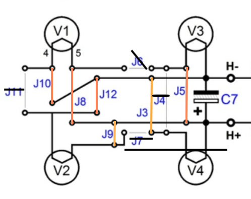

Is anyone able to decipher this jumper diagram for a Broskie Aikido amplifier?
I have built the board with 6.3v DC H+ and installed jumpers J8, J5, J9 and J3 to wire the heaters in parallel exactly as John Broskie suggests. However, only valves V3 and V4 are lighting up.
Can anyone with a sharper eye determine if the instructions are incorrect or incomplete?

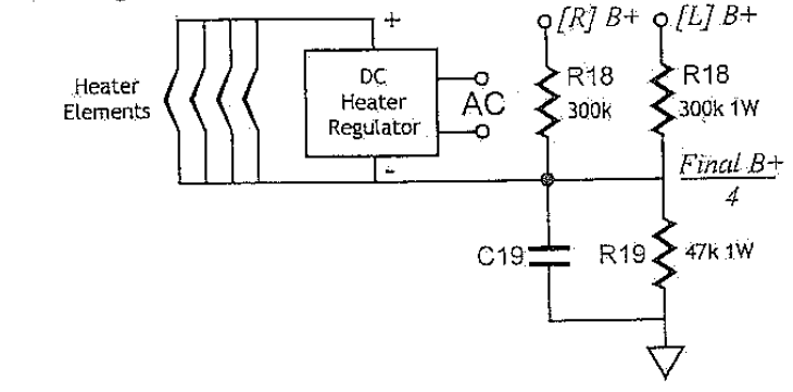

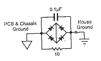

On another note (also unclear in the manual) - if there are separate B+ and H+ supplies, should both of the negatives be taken to the center/star ground on the PCB (which also joins to the chassis?).
I currently have two DC socket terminals, one for the heaters (6.3v DC H+) the other for the plates (24v DC B+). Either or both could be grounded in the chassis but I would add that they both have separate earth pins in their external PSU cases anyway.
Re the jumpers, for anyone reading this in the future - it needed J10, J11 and J12 as additional to Broskie's instructions (J5, J8, J9 and J3).
With only J10 and J12 added, the heater on V2 failed to light. Adding J11 fixed this.
So the final solution for using a separate heater power supply for parallel wiring is J3, J5, J8, J9, J10, J11 and J12.
