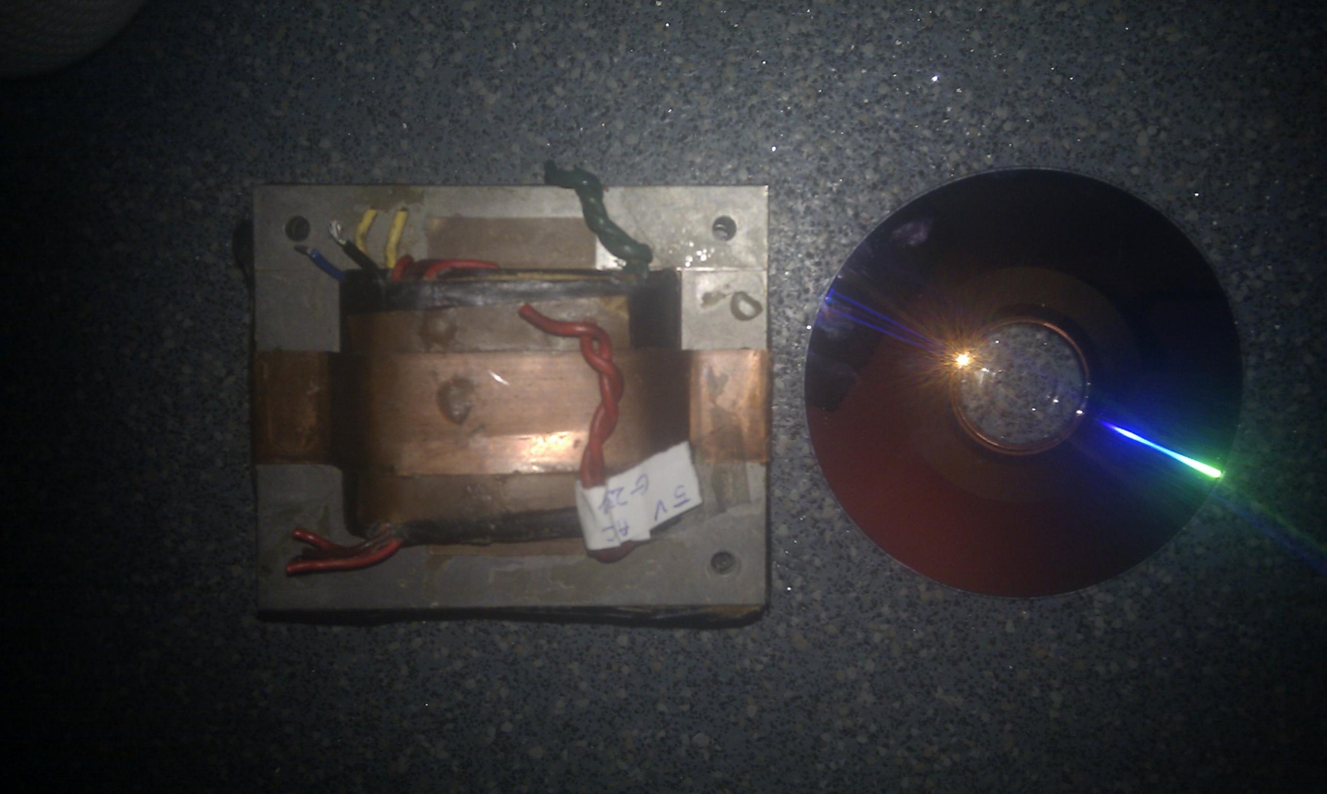

I've been playing around with a voltage doubler as I have a pair of vu meters that require 12vac or 12vdc ish to drive them. I,m about to build a PP UL amp using 4 ecl86's
My power supply (attached photo) has a couple of thick green heater wires (top right) 6.3Vac
A couple of yellow wires (top left) 6.3Vac
It has a pair of thick red wires (bottom right) 5V for rectifier tube.
The amp I'm building also requires a - 7 V ish rectified DC...
Would really like some suggestions on how to go about supplying all the different voltages without underpowering the ecl86 heaters (which I beleive draw 700-mA) and also without compromising audio.
Is it unrealistic to think that the PSU green heaters wires could power all 4 heaters?
Or could I heat two tubes from the yellow and two from the green and then take a rectified - 7 v from one lot and approx 12vac or 12vdc from the other?
Anyone had any experience with this?

If you're taking somebody else's word for those secondary voltages it wouldn't hurt to check them for yourself; that's not the usual color code. It's more likely to find 6.3 volts on the green pair, 5.0 volts on the yellow pair. Measurements without load can fool ya too.

Thanks Chris, I will check the greens! I've been playing with the yellows already tonight and they were approx 7.75 unloaded, I built an amateur (noob) voltage doubler and got 19Vdc from them unloaded...
It still does not answer my question of what topology I may think about for my PSU...
P.s. the thick reds are definatley 5V as they were connected to GZ34 in old amp, the rest of the heaters were split between the greens and the yellows. The greens had an exrtra tube connected to them too...
cheers Stuart

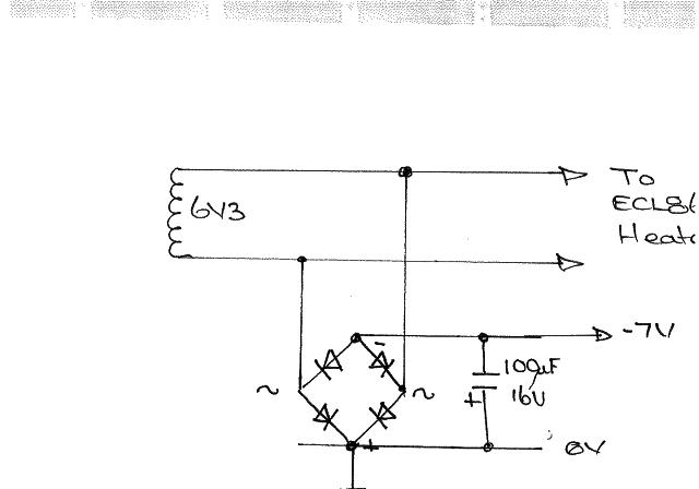

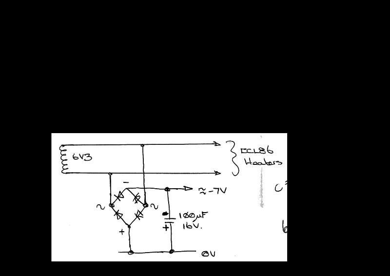

Stuart,
As long as you don't overload an ENTIRE transformer then overloading a single winding by anything up to about 50% usually doesn't matter too much.
I would:
Use the High Voltage Windings and the 5V winding for your tube rectifier as "standard"
Use one of the 6.3V windings (one with finer wire if they are not the same size wire) into the voltage doubler which will give you approx. +16V (give or take a volt) and then run a 12V regulator IC off that for your 12V supply
Use the second 6.3V winding to provide all 4 ECL86 heaters, also connect a bridge recifier across the winding connected to the 2 AC connections, connect the +Ve output to 0V and you will find that the -ve output will be around -7V, use this for the 2 CCS supplies. They only drawaround 1.5mA each (3 mA total) so a 100uF/16V electrolytic cap would be fine. Put a 100nF low voltage polypropylene across it too. The voltage (-7V) isn't actually that critical.

Hi Ian, I didn't get back to you sooner because I wanted to be able to draw you a diagram of how I thought it would go... however, I couldn't quite picture it, so a diagram of the heater 6.3Vac and the bridge for the ccs would be great when you have a moment.
I presume I drop the IEC mains inlet ground to chassis as soon as it enters the amp. I then have the CT from the 270- 0 -270Vac winding for the GZ34 recitifer, I would normally fix this to the chassis with a fuse? I think what you are describing is running the CT (0V) all the way through audio section and dropping to ground at the end of the 0V bus?
In which case does the 0V from the 6.3Vac bridge join with the CT to run through the amp?

Lovely, that is what I imagined it to look like - thanks for the confidence boost
Would you run the 0V through the amp and ground it after it had been past the PI?
And stick the HT winding CT to ground through fuse imediatley or join it to 0V line from your diagram?

Can anyone tell me if the 0V from the recitifed 6.3Vac as shown above goes on to eventually be grounded at the chassis? I'm confused as I would normally connect the CT from the high voltage secondary windings of my transformer to ground and this would also make the 0V for the B+
cheers in advance, Stuart
