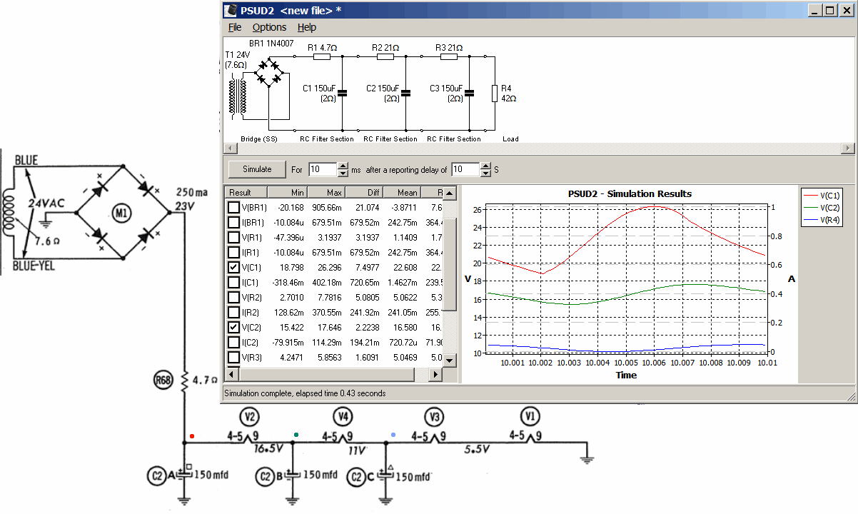

I'm trying to resuscitate an early-60s Bell T-338 reel-to-reel with an integrated RP-320 preamp. In the course of the inspection prior to replacing the electrolytics, I noticed that the heater wiring for the two 12AX7/12AT7 pairs differs from the published schematic.
The heaters are driven by a 24V winding from the main transformer. This feeds a Selenium bridge type rectifier. The output of the rectifier goes to a 4.7Ω resistor, then splits. One leg goes to a 150 mfd cap (one section of a can; all 150mfd caps are in this can), the other to the heater of the first tube. This is where the actual wiring departs from the schematic (both circuits shown in attachments; V1 and V3 are 12AT7, V2 and V4 are 12AX7).
On the schematic, the 4 tubes are wired in series, with the heaters on each tube in parallel (voltage to pins 4 and 5, out pin 9). The sequence is 12AT7: 150mdf to ground : 12AT7 : 150mfd to ground : 12AX7 : 12AX7 : ground.
The preamp is wired with two tube pairs in series (the two tubes in each pair are in parallel). The heater on each tube is wired in series (in pin 4, out pin 5, pin 9 not used). The sequence is 12AT7/12AT7 : 150 mfd to ground : 150 mfd to ground : 12AX7/12AX7 :ground. Yes, there are two caps in parallel between the two tube pairs.
Since this whole thing is driven by replacing the caps, I'm curious about having two caps in parallel between the two pairs. In particular, I'd like to know if this was a matter of expedience (using the existing component) or if there is a valid reason for using 300mfd instead of some other value. Or more to the point (since the can is being replaced and I can do what I want), should I consider some other value for all three of these caps?
As an aside, the transformer has a 24V .250A winding which is used only to drive these 4 heaters and a separate 6.3V 1.2A winding which is used only to drive the heaters on a 6V4 and 12AU7 and an indicator light. This seems an unusual transformer (at least, I can't find a replacement with 520V, 24V, and 6.3V secondaries). Is there a reason for running the 12AX7 and 12AT7 heaters on DC? Is there a reason for not using one 6.3V source (rectified and/or not) to drive all 6 heaters?

I would replace the selenium rectifier assembly (which will be weak and drop too much voltage)
with 1N4005 silicon diodes, and increase the value of the series 4.7 ohm resistor to get the correct
filament voltage. It will have to be significantly higher in both ohm value and wattage (use a 5W).
The tubes with DC operated heaters are likely input stage tubes that would be more sensitive to hum.
There's nothing special about the paralleled capacitors, just replace them with the same or higher
capacitance and voltage ratings. If possible, when replacing double the capacitance and the
voltage rating for each part. The more the better, and try to use high ripple current types.
But do check when finished for the proper filament voltages being present.

I'm guessing that running the heaters at 11V was intentional, as this seems to be not uncommon in that era, especially for low current applications.
The schematic indicates that the rectifier drops 1V. Dunno if that's accurate or not, as I want to replace the caps and do a little more inspection before powering it up. In any event, getting 12.6V from a 24V winding would require both a rather large resistor and rewiring the circuit to run all 4 tubes in parallel (since it's not clear how get the 25.2V required to keep the current layout with the heaters in series).

Just keep the circuit topology as it is, replace the capacitors, and verify proper voltages.
Then you can (if desired) replace the selenium rectifier with silicon diodes,
and replace the 4.7 ohm resistor with a larger value/wattage to restore the
correct voltage on the filaments. You could likely even increase the filament voltages
to 12.6VDC by choosing the proper replacement value of the 4.7 ohm resistor.

How would one keep the topology and increase the filament voltages to 12.6V? The transformer secondary puts out 24V. If the topology stays the same, there are two tubes in series, each requiring 12.6V if run at full voltage; that's 25.2V, correct? How would one go from a 24V output to a 25.2V input?
The original schematic may well have provided the least ripple voltage on the heaters to V1, V3. But the 'as wired' schematic provides redundancy of operation if a tube is pulled or a heater circuit opens (although remaining tube heater voltages may increase a bit).
Operating the heater from DCV attenuates a couple of sources of hum that may eek their way in to the signal path at the front end. V1 and V3 are likely to be the first preamp stages, and so their gain exacerbates any hum ingress, and hence they get the better hum filtering (think of the filtering as a CRC filter with the middle R being the V2 - V4 heater).
The selenium rectifier would be subtly better than a silicon pn diode (even with added R) for commutation noise, however that would be offset by using modern replacement filter caps. If you are replacing a multi-section can with separate caps, then you may be able to achieve lower commutation noise by wiring the new caps so as not to include common chassis current path - that may be a bit tricky to understand, and may be easier to explain if you include a photo or 2.

The lower current requirement of the 24V supply may be related to the selenium rectifier parts available at the time, and their PIV voltage and load current capabilities. A 6.3Vdc supply wouldn't have been capable of generating from a 6.3Vac winding back in those days due to diode drop, and the need for a physically larger stack than there is room for. What is a concern is that selenium diodes age, and so they should be replaced rather than retained.
I'm with rayma that cap value is not critical, and I'd suggest even 100uF (or 200 or 220uF) instead of 150uF is fine and would come down to what you can easily get (but I recommend 35V caps), and that you are unlikely to notice any hum difference unless you have the right measurement tools.

V1, V3, the can, and the rectifier are all grounded at the same point (one lead from the rectifier to the can, a second lead from V3 to V1 to the can to the stereo 1/4" monitor jack). V2 and V4 heaters have no direct chassis ground, as their heaters connect to V1 and V3.
Is it sufficient to replace the three can sections with two 100uF sections (one before V2/V4, one between V1/V3)? It seems that there are slim picking for something 200/220uf rated 35V or above; everything seems to be either low-budget generic caps or as big as the existing can.

You can use PSUD2 to indicate the ripple voltages when using 100uF for each section, and it is about 9Vpp with the cap experiencing 260mA ripple, which may get close to ripple limit for some caps. The V1/V3 then have 2.5Vpp ripple on them. That may be noticeable given it is twice mains frequency.
When using 2x100uF for each section, the first cap has 6Vpp with 300mA ripple (now managed by 2 caps). The V1/V3 then have about 0.8Vpp ripple on them. That may be acceptable in comparison to what was in place.

I would do the following:
- Replace the selenium rectifier by a silicon bridge or four separate Si diodes, as yet suggested.
- Replace the 1st filter capacitor by a 220 µF 35 V electrolytic.
- Replace both 2nd ones by a 220 µF 35 V also.
- Adjust R68 to get not more than 25.2 Vdc at the 1st filter capacitor when the tubes are fully warmed up.

Plan is to make a bridge rectifier from 4 1N4005s. I used glass passivated (1N4005GP-E3/54) because of the higher heat rating.I would do the following:
Do you mean replace the two parallel caps with two 220 µF caps (effectively making a 440 µF cap) or replace the two sections with a single 220 µF? FWIW, the updated design (see attached schematic) specs the first cap at 150 µF and the second at 500 µF.- Replace the 1st filter capacitor by a 220 µF 35 V electrolytic.
The transformer secondary is spec'd at 24V. The schematic allocates 1V loss across the selenium rectifier and the 4.7Ω R68/R161 drops that to 22V (because they presumably want to run the heaters at 11 V). I'm not trying to be stupid here, but how do I get 25.2V from a 24V secondary?- Adjust R68 to get not more than 25.2 Vdc at the 1st filter capacitor when the tubes are fully warmed up.
Is there anything magic about 11V? I realize that was done back in the day in low-demand applications, but if the rectifier output is 23V, why not dispense with R68 and run the heaters at 11.5V? Why not dispense with it now and run them at whatever full output from the silicon bridge turns out to be?
Manufacturers often found that input stage noise levels could be lowered by using a lower heater voltage. The disadvantage is the tube performance/life can suffer as it is lower than 12.6 - 10%. So it was a conscious decision then, and can be now!

They are astonishingly "equivalent". Which confirms the notion that if your budget for uFd and Ohms has not changed, you should get the same result.
I simmed both but only captured the first because there is so little difference.
300uFd was a LOT in those days. This is not clean DC on all tubes, only the end pair. Which is logically the lowest-level stages in the box, probably mike preamp and head preamp. The ripple here is 1/3 Volt with very low upper overtones (low buzz).
11V was VERY widely used on 12AX7 and kin working at less than datasheet conditions. Even lower has been used when working at super low plate current. Several of the ills of hot cathodes are less when less-hot.

Yes, Konga Man, I should have been more clearly, as I'd recommend you to buy two 220 µF 'lytics and replace either the 1st and the 2nd one(s) by just one of them. If there's ample space, you could also increase the capacitance if you want.
Rectifying 24 Vac by a diode bridge into a reservoir capacitor leads to a idle DC voltage that calculates to 24 V*sqrt2 - 2*VF. Assuming a diode forward voltage of 0.7 V you'll get 32.5 Vdc. Hence, there should be some headroom to adjust the heater voltage by a suitable R68.

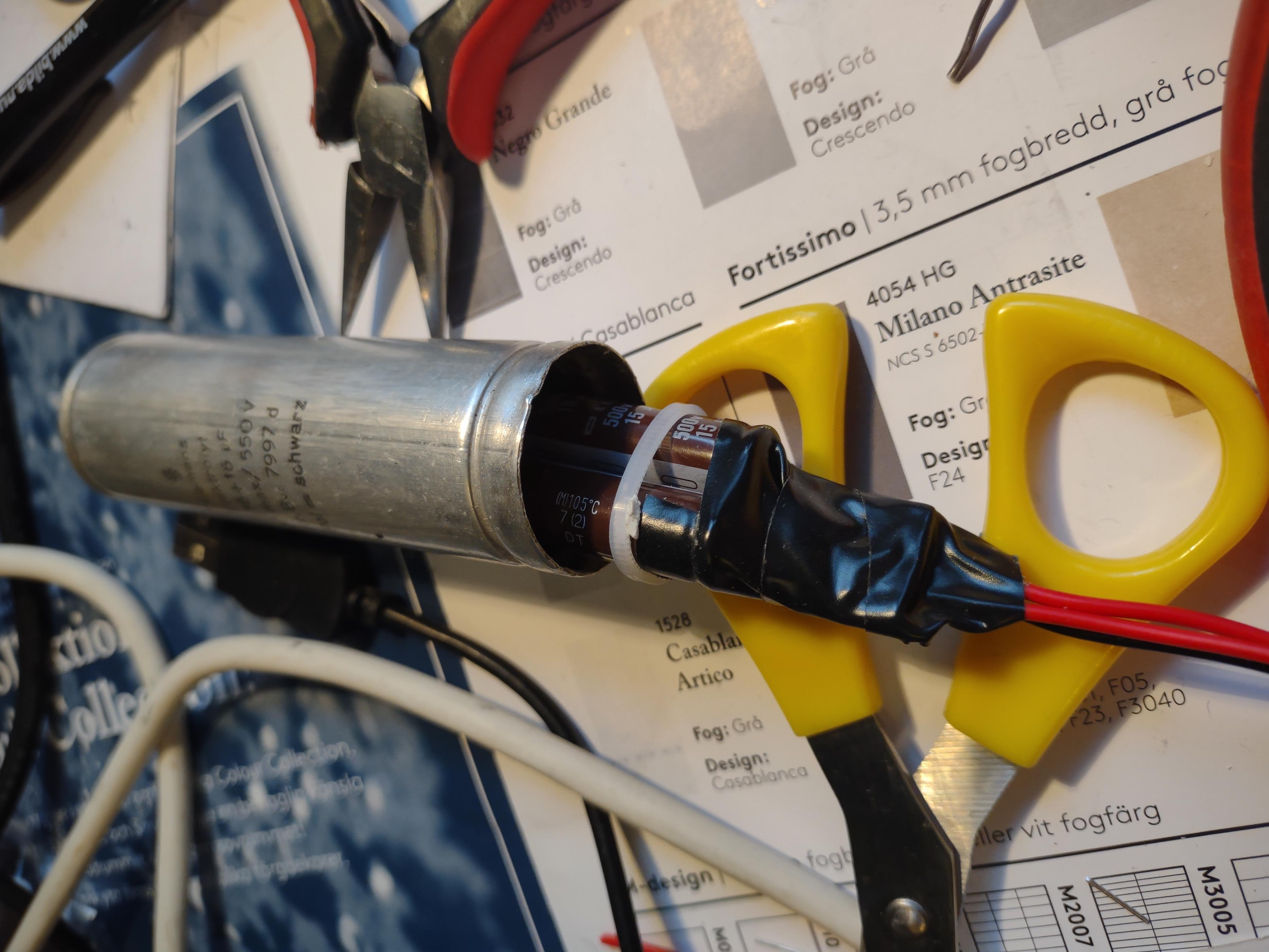

Hayseed sez they can build a 150µF/500µF can (i.e. spec values) for the heater circuit. I'm not wild about dropping $35 on it, but there's not much room underneath and two separate caps would (IMHO) present a less than optimal appearance up top. I'd guess I could bump that first section up to 220µF without a problem.

150µF electrolytics are not hard to come by. I had my first go recently at hollowing out some can caps and 'stuffing' them. They were both '48 vintage 16uF + 16uF 500VDC cans, and the new 500VDC/105C rated, low ESR, long life 16uF radials just rattle inside there. Even if appearance is not an issue, there is some extra real estate for bulky caps inside the can, and the solder lugs are normally integral to the wiring.
