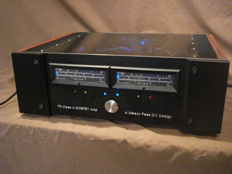

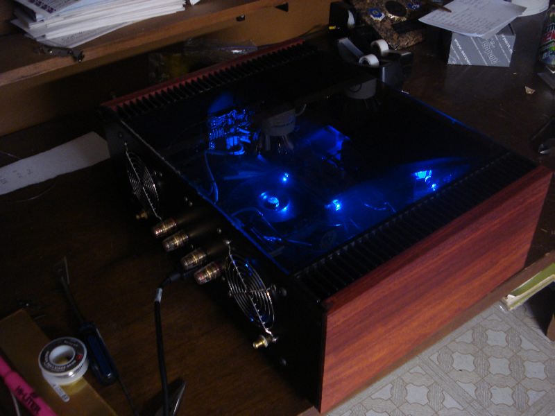

My F-5 case was built from three pieces of 1/8" aluminum plate/sheet for the bottom, front and rear. The left and right sides made use of drilled and tapped holes in the Conrad heatsinks. The top was bronze tinted plexiglass (which I had handy in my scrap bin). The aluminum plate was left over from some of my car building projects, so my cost was basically the heatsinks and Allen head button screws.
I got the front engraved and anodized. The two "cheeks" on the front panel were also scrap 1/2" aluminum I milled down.
All told, my cost was the two heatsinks and my labor. (I'd rack that up as "a labor of love" though....)

Fantastic looking.
It is good to see you are not afraid of fans as some are. With fans you can bias that sucker up! I enjoy seeing the artistry of other members with their case builds. Truly diy to another level. I will agree most will want to buy a ready to use case and for most the cost savings of building yourself will not be that great if any. I have one store case and one I built myself but it looks nothing like this. More of a Frankenstein looking case but it works. The electronics do not know the difference.
Bare, to make things "easier" on myself, I had customers cuts made to size. It adds a few bucks to the cost.
With the correct blade, it can be cut on a table saw as well. I sure didnt do it, but the member who supplied the sheet material did. As to the ventilation, having no means to do it my self short of drilling a bunch of messy holes, I elected to space the top and bottom covers about a 1/4 inch or so.
