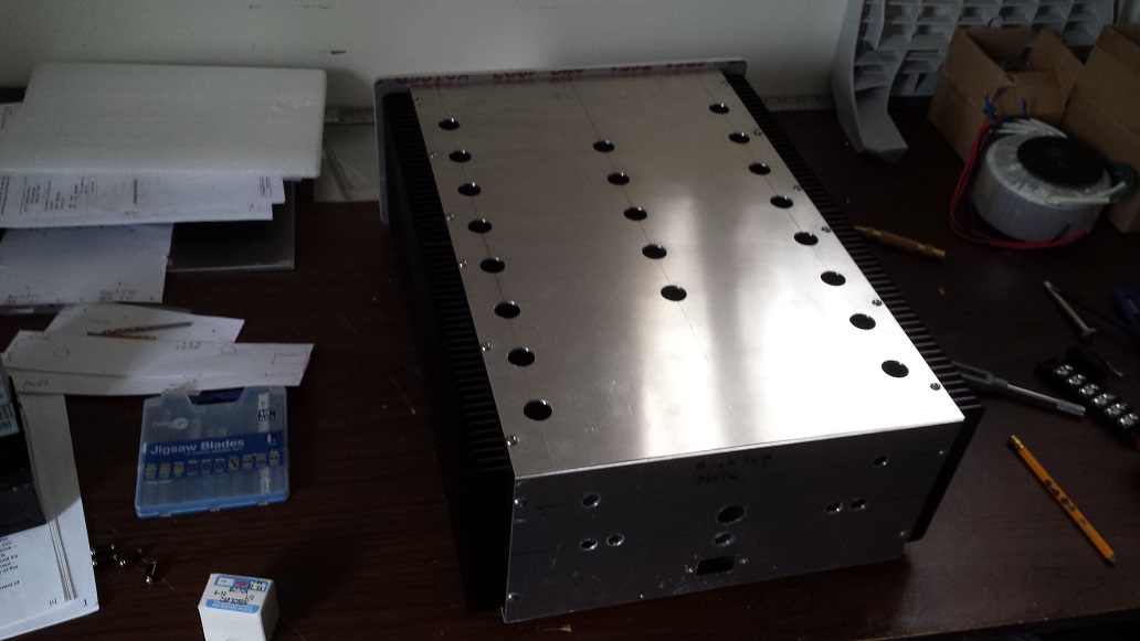

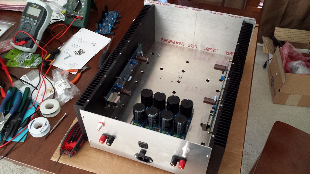

For example, a 10mm 6061 aluminum face plate cost me $46. The top, bottom and back .09" 6061 aluminum plate cost another $70. Then there's the hardware to put it together: feet, screws, nuts and bolt, etc.
Approx. internal dimensions 12x19x6. This is where the plate sizes come from in my build example.
Four 4U style case heat sinks (6" high) cost me $100. I'm now at $200+. Took me 2 weekends to put together. If I paid myself $2 an hour for 8 hours for 4 days it's $64. Now I'm closer to $300 for the case. See my point?
This isn't to discourage you from building, but help surmise what goes into building a case.
Again, just my experience. You can tell me to go pound sand, if it makes you feel better. 😉

I don't think it looks better than what the store offers. I didn't gain any satisfaction in DIY'ing the case. It was all about saving a few bucks, but in the end, didn't really save anything.

Really.. that much for your Ali sheets? Or did you additionally have CNC/laser work done?
I just bought similar materials; top, bottom, front, back in 1/8" 6061 (Albeit my front plate was a mere 1/4" thick) 8' of 1x1 ali angle .. My Ali bill was 40$ (cdn) Total.
Not fully understanding why yours was so much. Is it perhaps Huge?
Nope.. it does seem as ~ 3, 4 " longer, but not as tall as mine. odd.

Similarly, my F-5 build has a face plate about 2/3 as thick as the 10mm, still quite heavy, top bottom and so forth from 1/8", all from 6061 a friend on another site got from his metal supplier as scrap.... had to wait for pieces the right size and so forth but all was 50 bucks. Still had to get heat sinks, and do all the drilling, tapping and so forth, many hours of hand hurting, tons of aluminum shavings everywhere.
Cheapest way out is Chinese chassis, but you will need to drill and tap the sinks, plus crappy specs will likely require you to sand nice flat spots where the mosfets go.
