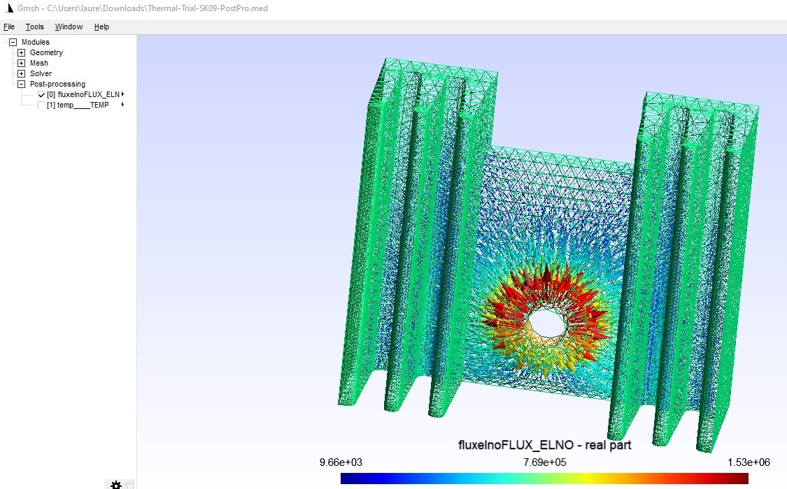

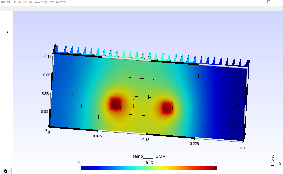

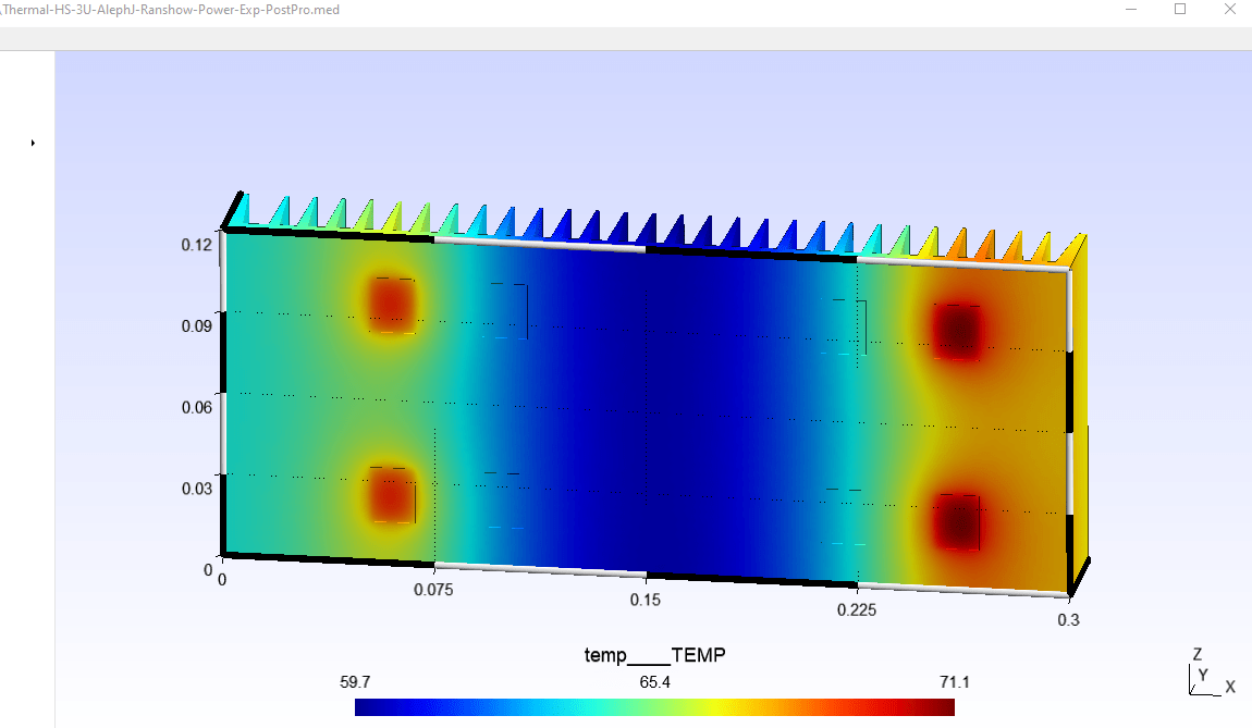

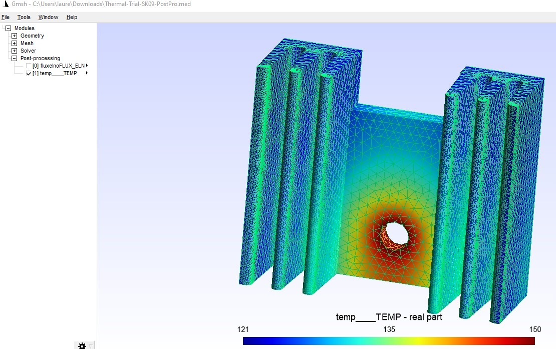

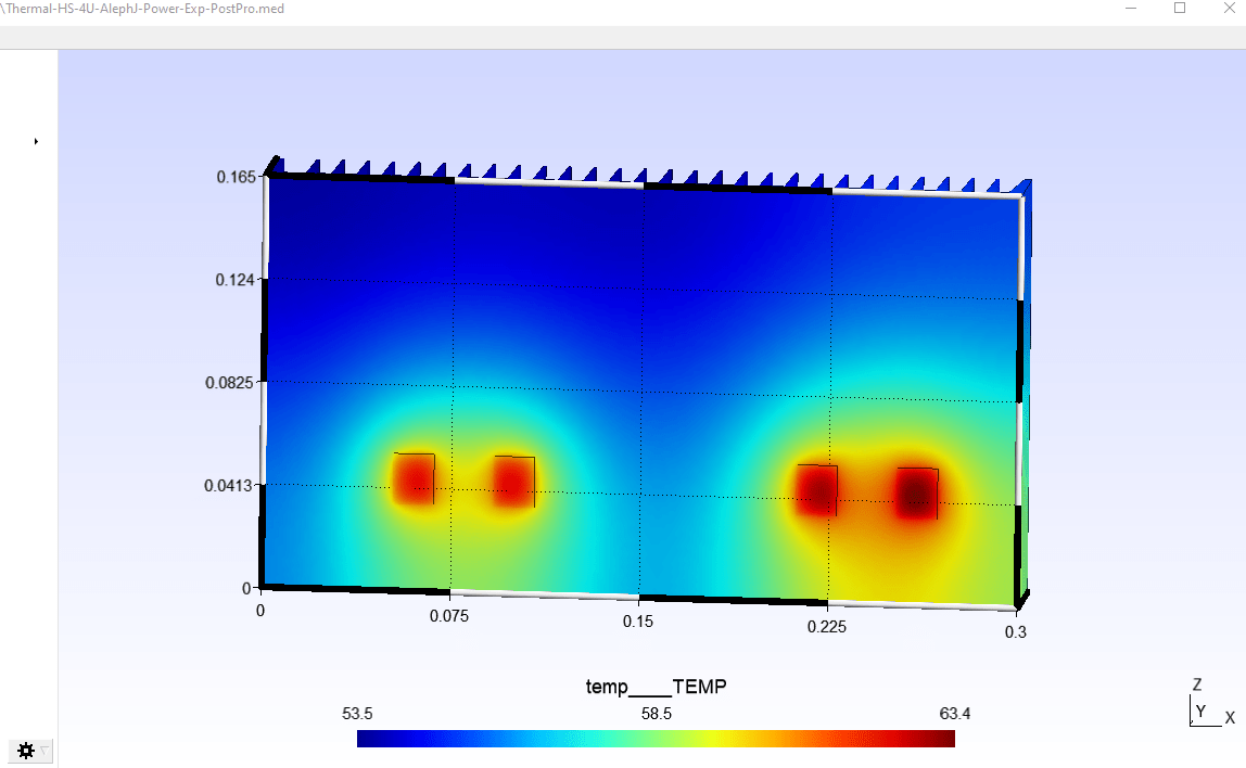

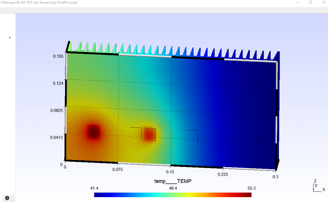

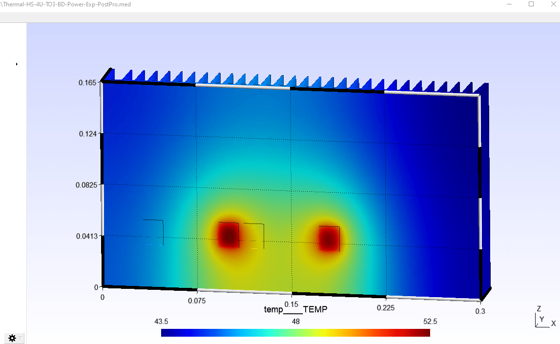

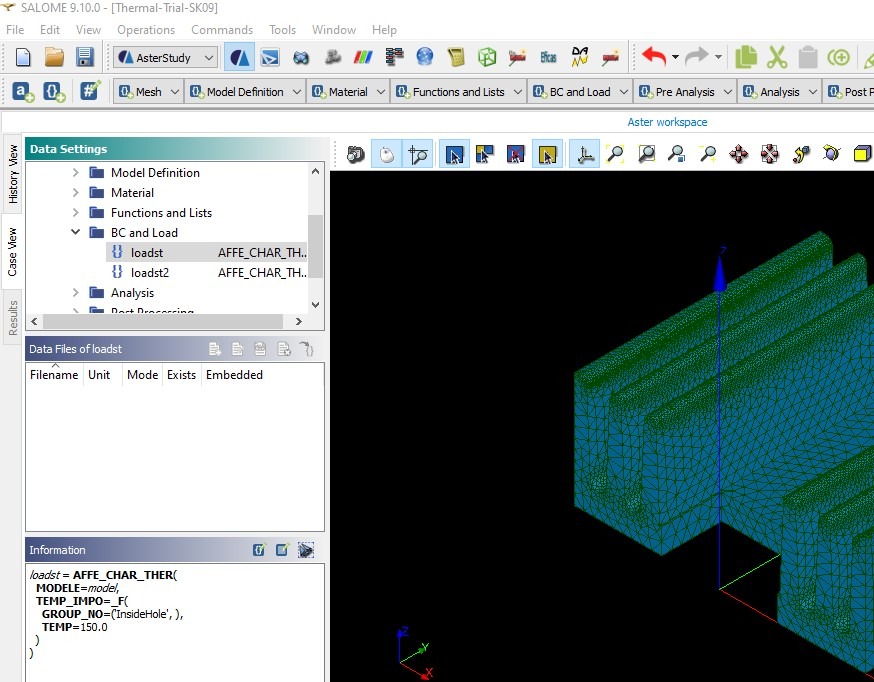

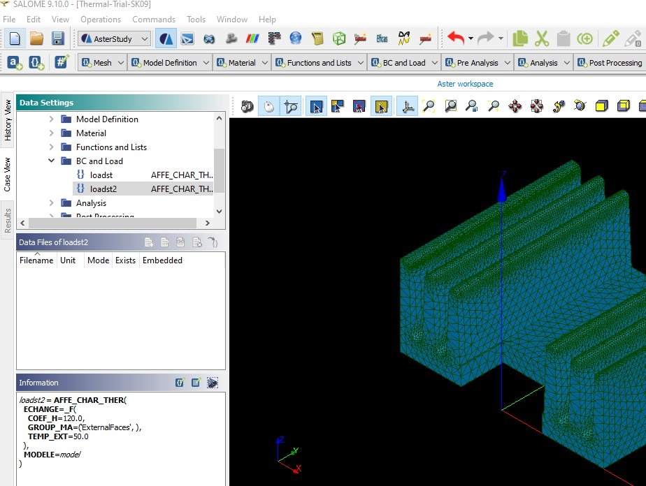

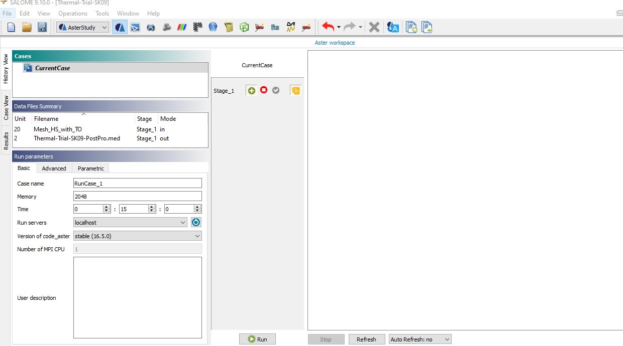

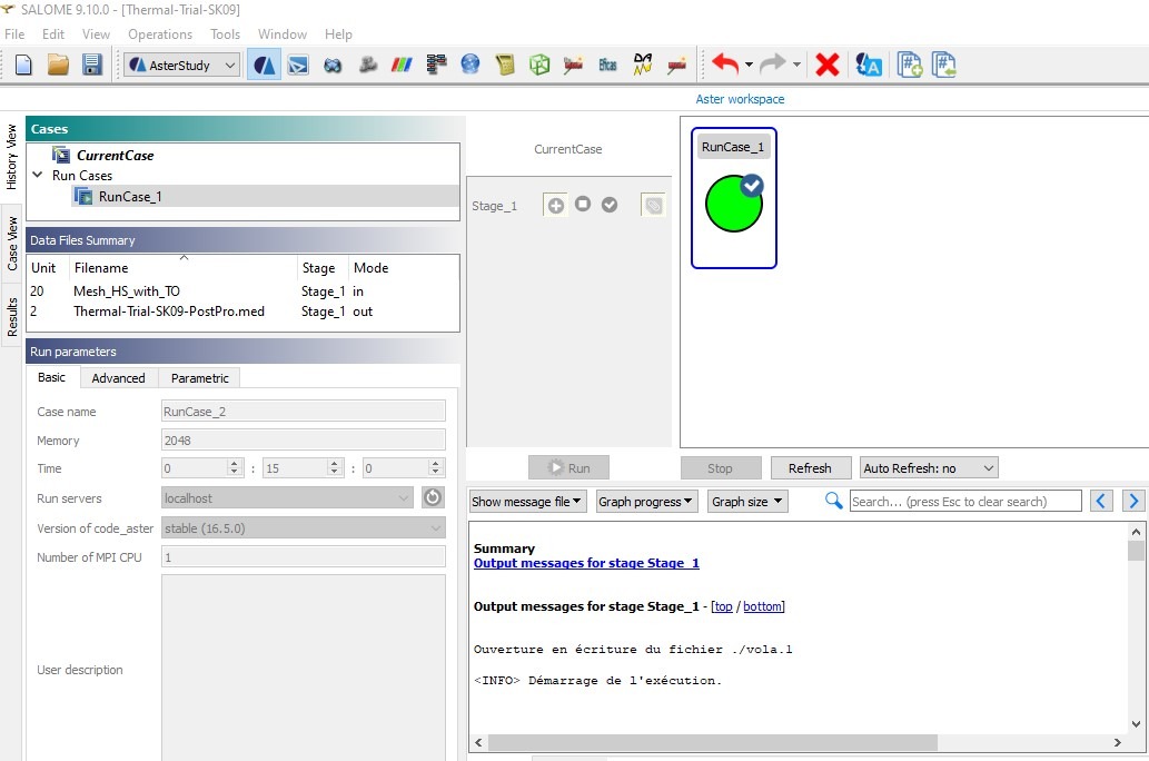

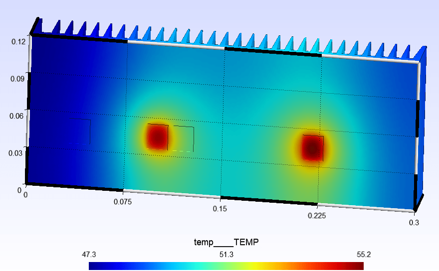

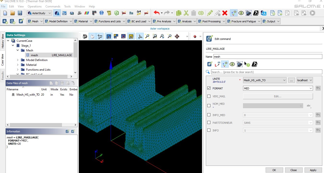

Then, redoing different calculations, with 6L6 amp used as a reference for comparison, i have
Thermal Power @transistor 30Watts | | | | |
Setup | Tmax | Tmin | Tmax Vertical (High) | Tmax Vertical (Low) |
Reference Theseus 4U (6L6) | 55.3 | 41.4 | 47.9 | 51.4 |
Theseus 4U Mosfets@Center | 52.5 | 43.5 | 45.7 | 48.8 |
Theseus 3U Mosfets@Center (to build?) | 56 | 46.5 | 50.8 | 52.2 |
AlephJ 4U (if 1 Transistor=30w) | 63.4 | 53.5 | 55.1 | 59.7 |
Aleph20 3U Ranshow (if 1 Trans=30w) | 71.1 | 59.7 | 68.3 | 68.3 |
So, compared to the 6L6 placement of the transistors on the left side of the 4U-300mm heatsink, a 3U-300mm with mosfets in the middle/centered would:
a. have a Max Temperature only 0.7degrees C higher than 6L6 placement
b. have a Min Temperature 5degrees higher.
=I am tempted to think it is acceptable.
One can see that centering the mosfet (Reference 6L6 compared to 4U Mosfets @center) brings down the max temperature by 2.8degrees, min temp by 2.1degrees.
Better positionning the mosfets can balance a smaller heatsink and later, instead of keeping the "Ship Of Theseus" mosfet PCB placement, i could try to see if thermals can be optimized by having the transistors placed somewhere else (using wires instead of direct welding to the PCB)
ps: Aleph estimation are only for fun since i don't know if they do dissipate 30watts. The 30watts were for the Theseus with know voltage and current going through the transistor (thanks to Mark Johnson)
Thermal Power @transistor 30Watts | Outer Temp | 35°C | Outer H 15w/(m².K) | Inner Temp | | | | |
Setup | Tmax | Tmin | Tmax Vertical (High) | Tmax Vertical (Low) | Delta Tmax | Delta Tmin | Delta V. High | Delta V. Low |
Reference Theseus 4U (6L6) | 55.3 | 41.4 | 47.9 | 51.4 | Reference | Reference | Reference | Reference |
Theseus 4U Mosfets@Center | 52.5 | 43.5 | 45.7 | 48.8 | -2.8 | 2.1 | -2.2 | -2.6 |
Theseus 3U Mosfets@Center (to build?) | 56 | 46.5 | 50.8 | 52.2 | 0.7 | 5.1 | 2.9 | 0.8 |
AlephJ 4U (if 1 Transistor=30w) | 63.4 | 53.5 | 55.1 | 59.7 | 8.1 | 12.1 | 7.2 | 8.3 |
Aleph20 3U Ranshow (if 1 Trans=30w) | 71.1 | 59.7 | 68.3 | 68.3 | 15.8 | 18.3 | 20.4 | 16.9 |
Did you make any actual comparison temperature measurements, ie. original location on left side, and then relocated so that devices were symmetric (left to right) in middle of heatsink, and perhaps a bit lower than symmetric (top to bottom)?
You don't identify the simulation colours with respect to temperature, so those results don't really tell much imho. You may get a more significant improvement by installing a copper spreader or two - especially if the copper spreader interface to device doesn't use an insulator pad (ie. the insulation pad is between the copper and heatsink).

1) [Simulation color] For each picture, there is the legend showing which color is which temperature (extract attached). That's how i got the temperature value in the table
2) [Actual Comparison Temperature] No, i have not made this because i can't, as i haven't purchased the 3U-300mm chassis and would like to guess if it would work.
I know 6L6 config with transistors on the left is working, because he was showing it, without mentionning thermal issue.
= no being able to do measurement is why i went to simulation
3) What i have done as measurement=using my M2x inner/outer temperature to have a guess at possible inner/outer temp for the simulation (yet, this is a rough approximation because my M2x is 4U-400mm and each transistor might work differently than Theseus).
If i wanted a better reference than 6L6 Theseus, i would need to:
a. know the power dissipation of M2X transistors
b. model and calculate a 4U-400mm heatsink
Maybe i will do that in the futur.
(Aleph simulation are rough as well, deduced from standard Aleph and a user (Randshow) who has a 3U-300mm but mentions it is running very hot.)
4) [Copper Spreader]
a. Thanks, that's a good idea (which i could later simulate easily once i find the right part and have its dimension)
b. I was thinking of somehow adding others HS on the inner side (not ideal but with some openning in the top panel...could help = everything to avoid going over 120mm or putting a fan)
c. Also i wouldn't want to go to 400mm because i would like to keep the Theseus size "contained". (and it cost more to have more panels drilling per UMS specs)

Ta, I missed the simulation legend at the bottom.
It's likely that some copper bar would make a reasonable improvement in transferring heat out to where the main heatsink is sort of idling at near ambient temp.

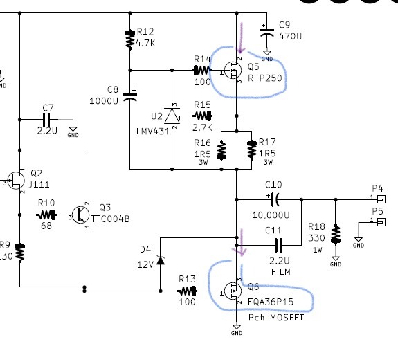

Do you know what insulation voltage is needed for each FET, and do the FET drains need to be isolated from each other? Spreaders are great if you can get a sheet of insulation to suit mounting the bar to the heatsink. Mounting the FETs direct to flat copper with some paste gives the lowest Rth (apart from soldering to the copper), which is a key attribute. Your simulation may be able to indicate the nett benefit - which may or may not entice going down this road.

I plan to use Keratherm sheet between transistor and heatsink, but the reference is already using it (according to the picture).
As for "Do you know what insulation voltage is needed for each FET, and do the FET drains need to be isolated from each other?", i don't know what are insulation voltage! But that's an opportunity to learn.
Schematic of the board is attached, as well as the data sheet of each transistor.
Looking quickly i have not found "insulation voltage" in the spec, but i am not very knowledgeable with electronic mosfets.
Same regards FET drains isolation.

The supply voltage is what you need to handle, not the specification of the FET - the insulation only has to deal with the voltage in the circuit. And the two drains definitely have to be isolated from each other or you'll short out the power supply since one is connected to each rail.
Generally we always isolate devices from a large heatsink to preclude any chance of shorting out the amp circuitry by the heatsink touching something else. Often the heatsink is electrically part of the chassis.
Then, yes, per the circuit schematics, the drains are not connected to each other.
I will always insulate any wire (if i choose to use wire for mosfet & PCB connection to spread the mosfet farther away than permitted by the PCB) so they only connect to what they are supposed to connect to.
The IRFP250 is nice in that it has a plastic body and mounting hole, making it easier to mount, and maintain insulation from the FET metal base to the heatsink when a thermal insulator pad is used. Mounting the FET to a heat spreader, using no isolation pad, makes for better thermal conduction, but electrically isolating the heat spreader from the heatsink may be the harder path for you to take.
I would use electrical isolation for the lower FET, even though the FET drain is at ground, to avoid ground loop risk.

Small(ish) update: moving 1 of the mosfet to the right on the "roughly centered" 3U-300mm config lead to a max temperature similar to 6L6 reference (-0.1°C @tmax). So, it should be OK if i wire the mosfet to have the freedom to put them where i need (instead of following the pcb localization)
Theseus 3U Mosfets Optimized 1 | 55.2 | 47.3 | 50 | 51.3 |
Hi.
If some are interested to play with simulation, 1st with a trial on a simple case, to see if the tools are working... (i would later post the "Modushop" type of heats ink calculation i did... as archival)
1. Preprocessing, Solver integration, Post-Processing was Salome-Meca, with Code-Aster solver integrated https://code-aster.org/spip.php?article303
2. Windows version (that one used), recently updated https://code-aster-windows.com/download/ [i am updating everything to 2023]
a. download and install Code Aster (will put it in the right location)
b. download and install Salome (should recognize where the solver, Aster, is)
3. Another post-processor, lightweight: https://gmsh.info/
4. Example/Tutorial is "Thermal-Trial-SK09.hdf"
"Mesh-Only" inside can be openned with Salome mesh module or GMSH "Mesh_HS_with_TO"
"PostProcessing Only" can also be openned "Thermal-Trial-SK09-PostPro"
But with the *.hdf openned in Salome-Meca, you should have everything
5. Go to Salome "AsterStudy", "History", click "current case" and then "run" in the bottom middle
6. A few pictures are given. This is just to see if things work, physics on this case is not checked (heat is going through the hole wall...not the possible location of the mosfets).
To play, hot temperature of 150 degrees can be modified in "BC and LOAD"-> "loadst", cold temperature around and exchange coef in "BC and LOAD"->loadst2
I am not expert in the domain (later cases were done differently for the model and conditions), it is just if some would like to discover this a bit and "play" with it
