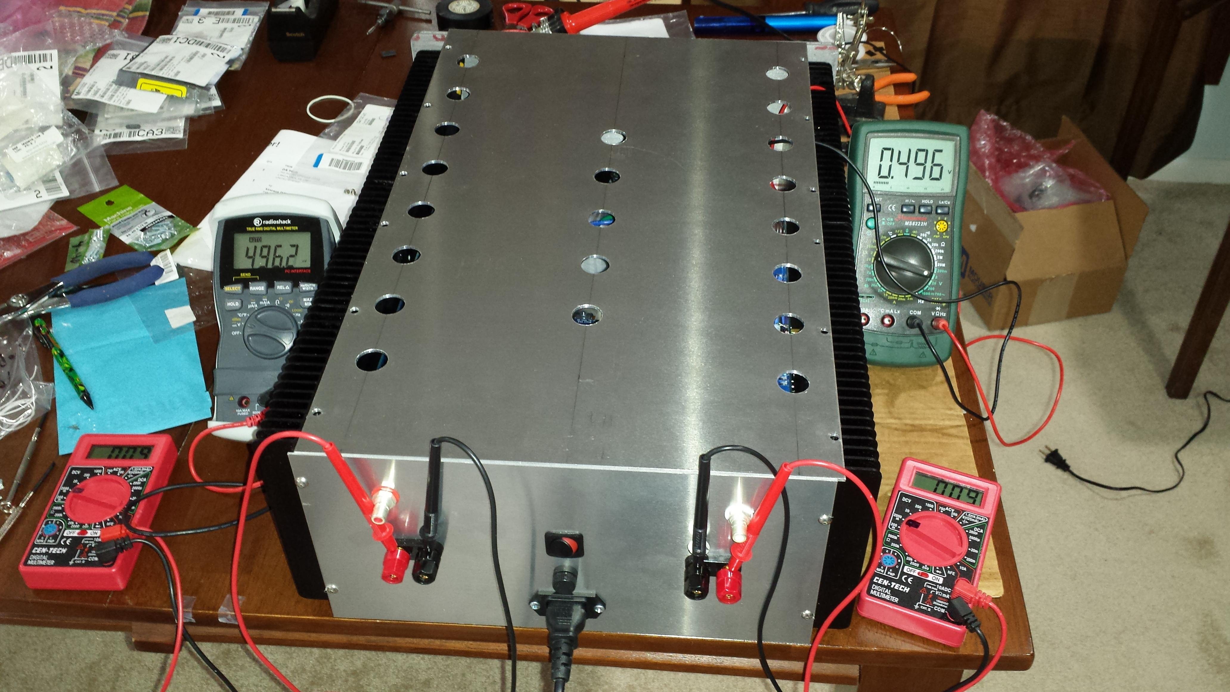

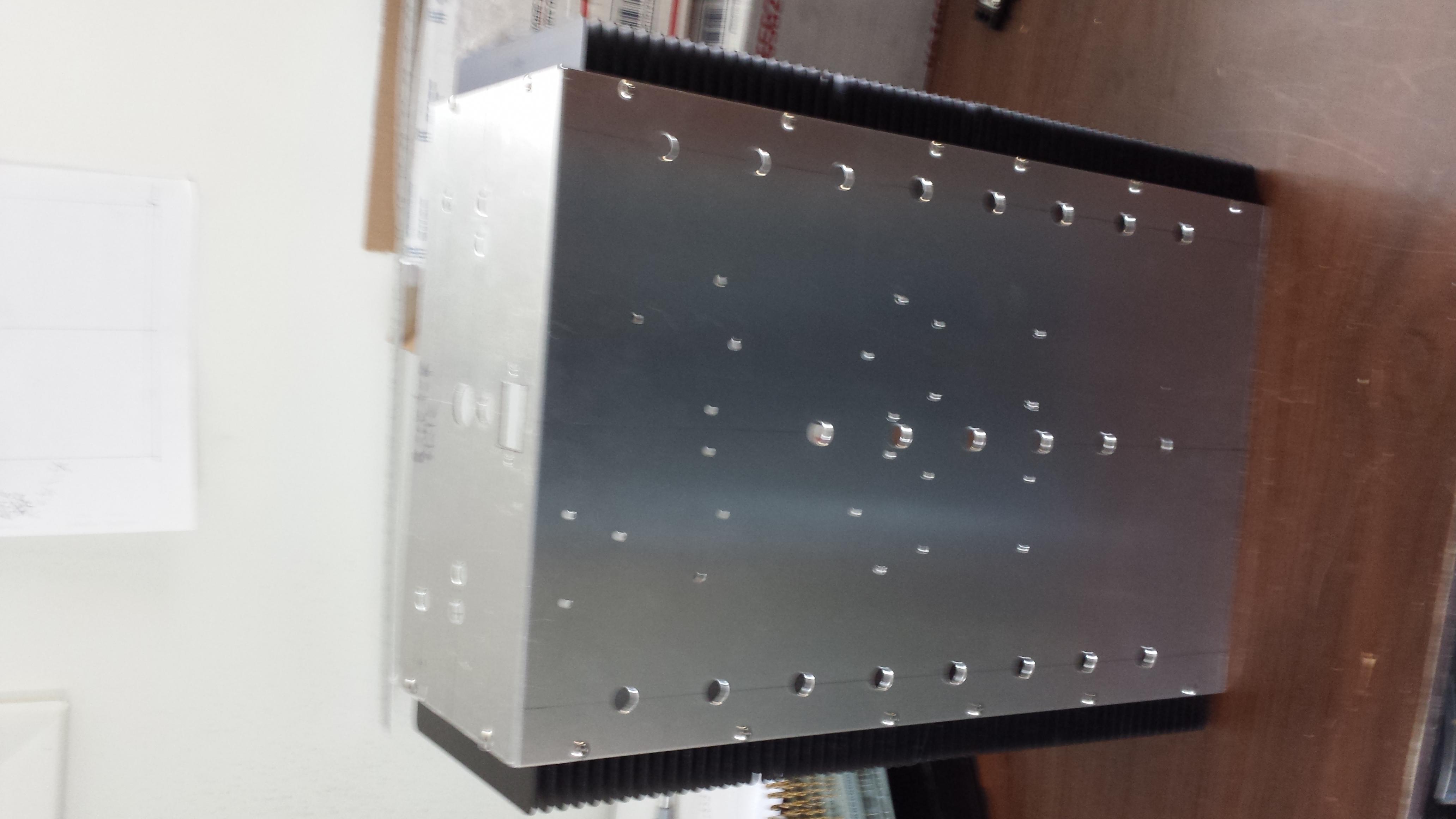

Send us a pic o the HS and maybe have a ruler in front of it as a reference.
