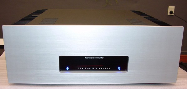

But, regarding cabinett to the amplifiers. I have built two The End Millennium power amplifiers from LC Audio a couple of years ago (still very happy with the result!), and just for fun I visited their web site today. I was very excited when I found that they are selling the cabinet alone (without powersupply and amplifier), at 5000 DKK.
Looking into this, I see that the cabinet uses four heatsinks rated at 0,33K/W. That would make a cabinet that has a total Rth of 0.33/4 = 0,0825, pluss the Rth of the cabinet itself (front plate, and top and bottom plates)? This would be enough for either an Aleph 5 or an Aleph 4!?

Vidi, I have a Zapsolute in one of those chassis. They are indeed too expensive if bought alone. My guess is that you can use one for an Aleph 5. If you go for an Aleph 4 you would have to build monoblocks and use both. The heatsinks of the LC chassis are really top quality.

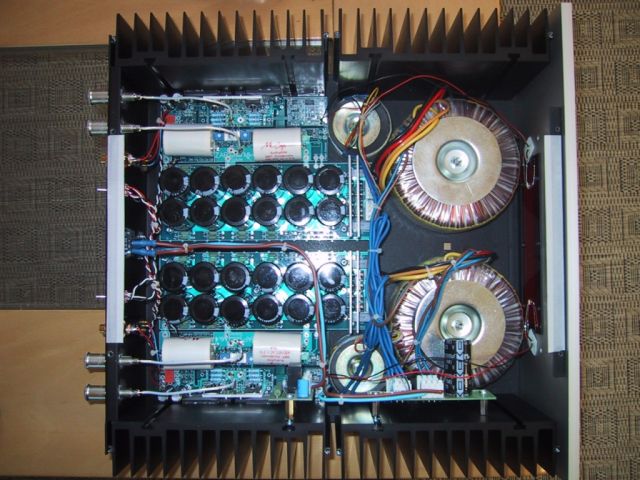

Steenoe: Do you mean that I have to use two of the cabinets (one for each Aleph 4 monoblock)? According to WuffWaff, (and Aleph 4 user manual), I will need to get rid of about 400w of heat. Using the mentioned cabinet, with an Rth= 0,0825, will give me a temperature of 33 degrees above room temperature (to a total of about 58 degrees). Isn't this enough cooling? I have not considered the insulators and junction Rth, is this the reason to choose two cabinets?
The reason that I prefer to use a pre-built cabinet, is that I do not have any experience doing metal work, so buying a pre-fabricated cabinet would enshure me a good result. (But, this is not in the spirit of a good DIYer.. :D )
Time will tell! I will ask the students of mechanical engeneering if they can help me out with the metal work!
Buhl: It may not be to late to get som snow in Lillehammer! Lets hope for the best!
I asume you know about the webcam on hafjell, but I post the link here! :)
Hafjell Webcam
Looking at the chassis, I wouldnt think that it can dissipate the heat from a 100 watt stereo Aleph:hot: These amps do get very varm. An Aleph 5 would be (just) doable. I bet that will get warm too. I didnt calculate anything, but having build several of these amps, i cant recommend using only one chassis for the Aleph 4.
But you can ofcourse try it out and see how it goes.
Steen:)
somehow heatsinks always get hotter than calculated with the specified Rth. This has something to do with the temperature at wich Rth is measured (mostly higher than 55°)
I also think that the chassis would be ok for an Aleph5, maybe you can even up the bias a bit wich would be good for your 4 ohm loudspeakers.
If you manage to set the bias to 2.6A as in the Aleph4 you will have just as much power into 4 ohms and dissipate a lot less heat.
