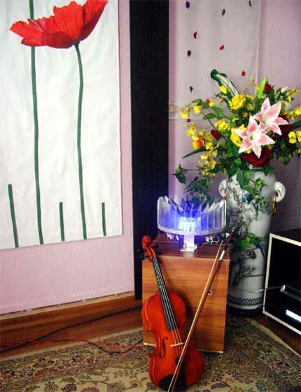

update heat sink with class A amp
dear all,
i just tried my heat sink by using class A amp. Today nothings to do due to Dx-turbo rebuilding so i was wondering testing for class A amp.
i build Aleph-3 30 watts last time so i put 6 mosfets on it.i think watts should be more then 30w due to high ampire, i am using 10 ampire. i used one channel on my heat sink, i was surprised lots. after and hour run the temp is only 34c and my amb is now 29c night time.
i think the heat sink is working very very fine.
picture is attached. pls don't see the mass....ok...i just was testing heat sink parformence.
thank you
michael
