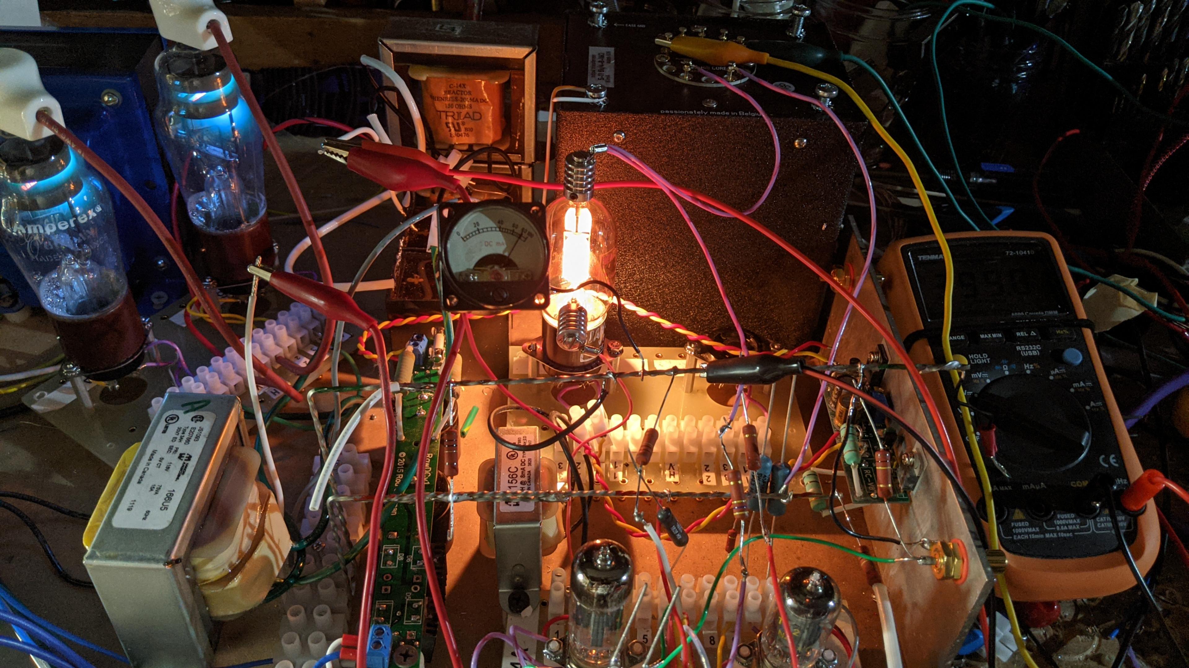

Thanks Rayma. Thinner is much easier. There will only be one board with two devices on each bulkhead. Distance between the devices is set to about 2 inches by the board designer. You can see the distance as they are mounted on the aluminum plate towards the right in the picture.

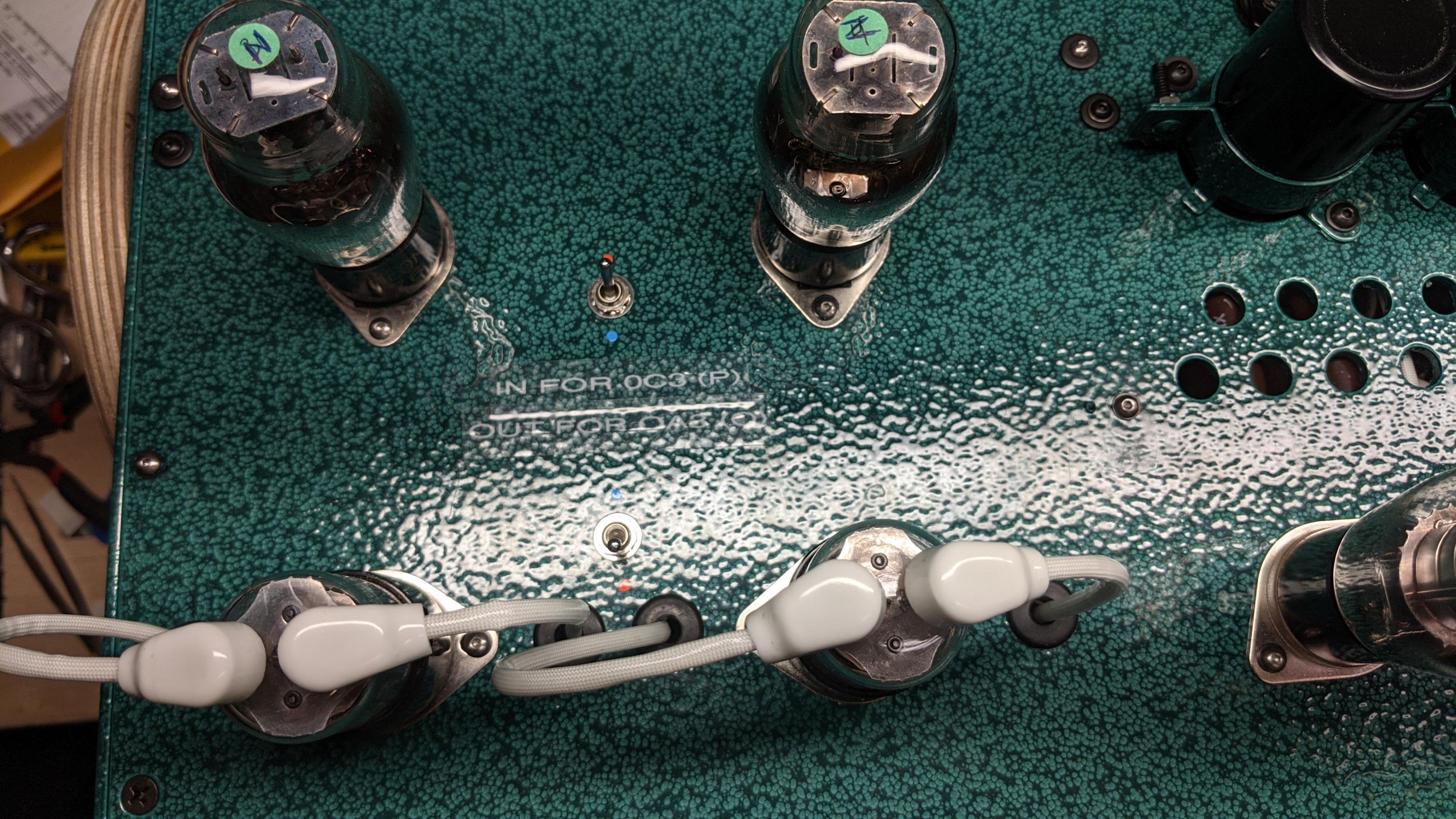

Chassis will be aluminum 3mm in thickness.
Coleman filament regulators. Many people here use them. Rod Coleman posts here regularly.
The powder coating is a grainy thick coating that I'll apply ONLY to the outside.
The regulators will be mounted directly on bare metal with appropriate electrical insulation.
In essence, they would be mounted on the bare underside of a chassis like shown below
