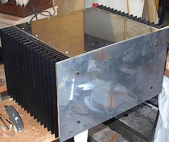

How about two of these...
How about two of these per channel for an Aleph 2?
L*W*H = 300*300*40 (mm)
Thermal resis. 0.29 C/W
You can find them at www.rs-components.com
Product number 264-670.
Price each £58.85 (ex vat)
/loovet
/loovet

I would just say that my own estimate of heatsink requirements is that they should be 2500-3300 in^2 for one channel of an Aleph 2. That's assuming that you manage to spread the devices around on it (them) and that they are no taller than about 10-12 inches. 2.54cm=1inch.
That's without figuring in the area of the back-side of the sink.
This is based upon lots of reading of what others have done and the results they have gotten, NP's own comments and my estimate of the surface area of the heatsinks on the commercial product, and his comments in response to questions like this. Also, my own experience with a Zen 4 and scaling it for the dissipation of an Aleph 2.

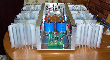

I used 6 of the MM5061-6 heatsinks on each of my 2's. My calculations come out to about 600 watts of dissipation give or take, and these beasts do run quite cool for sitting at .65 volts of drop on the source resistors. I reccomend these as they dissipate the heat very well, only thing is a bit more effort to construct the chassis.n With the panels in place each amp weighs in at 68 lbs!! Each sink cost me $25.00 from MM Metals which I thought quite reasonable. About $320.00 with shipping...wait was long though...about 10 weeks.
Mark
Mark
