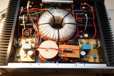

Today I finally mounted the new coils for my Zen Lite. The problem with the heat from the coil seems to be solved. As Indra1 suggested I used two coils parallel. I bought two Mundorf L100 coils 8.2 mH.
The coils still get warm but now the temperature is about +50 C.
I also took the opportunity to increase the value of some capacitors.
I use small fans to cool the amplifier due to the construction. The chassis with heat sinks is a bit too small so it feels like a good idea to use fans.

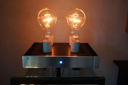

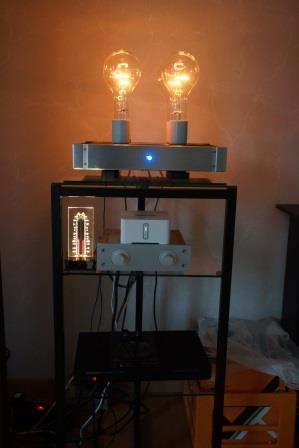

I took some pictures of the amplifier. Preamplifier is seen under the small Sonos box
Thanks for all the help.
