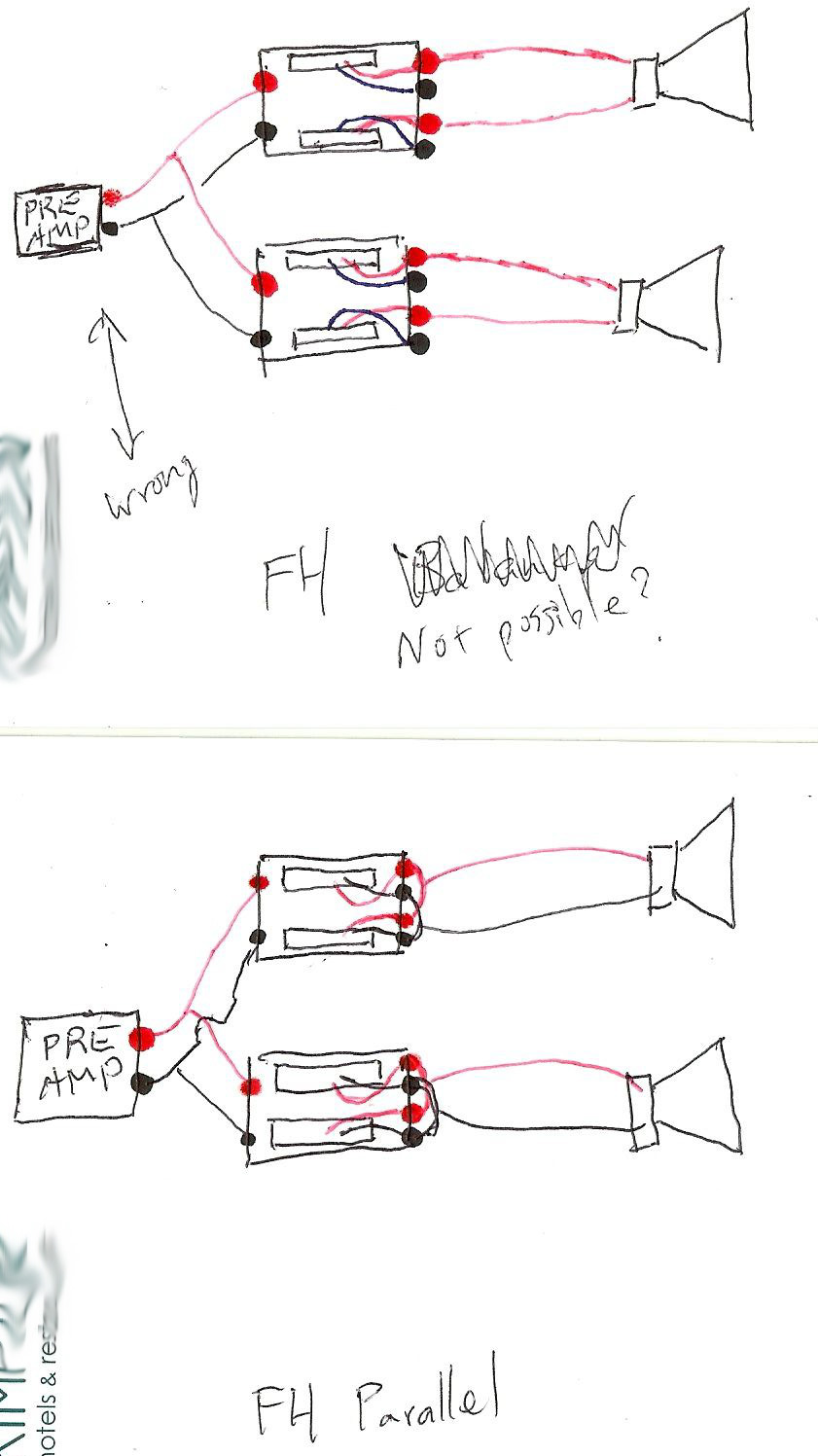

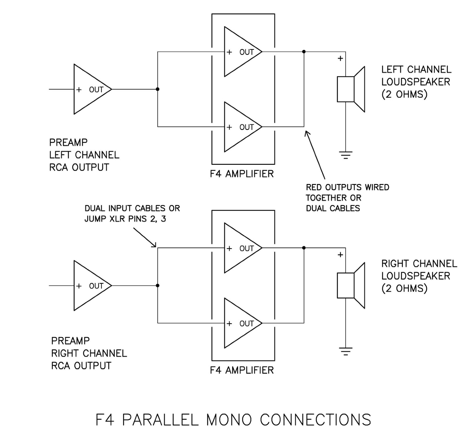

If I'm building these as described - borrowing from the First Watt Owners and Service Manual. Here is the diagram for driving 2 ohm speakers.
I can post additional links if this isn't the best route... it's just the one that is almost making sense to me at this point.
The outputs + are tied together at the amp, or bring two pairs of speaker wire.
Like most commercial speakers I have a + and - terminal on the back of the cabinet. I would like to confirm what I remember from a phone conversation a couple of years ago. Both individual outputs + would occupy a terminal on the back of the speaker... But that conversation was based on the old plan of building a balanced preamp... not two single ended monoblocks.
Using the above diagram for SE, it appears to me that the ground must return to the amplifier's "black" terminal.

Is this another way of interpreting the wiring schematic? (original first)
upper part of your drawing is , well , rubbish - neither parallel nor proper bridged
lower part of your drawing is sort of correct way for parallel
now ........ if you obtain one F4 (with adequate preamp) , you can make few tests and decide:
-is it normal 50W/4R connection enough
-or you need 50W/2R (two channels paralleled )
-or you need (almost) 200W/4R (two channels bridged)
for first two tests you need unbalanced pre capable of 40Vpp output
for last one test you need bal. pre capable of almost 80Vpp output
for last two tests you'll be able to conduct just one channel test , if you have just one (common type - meaning 2 SE channels ) stereo F4
