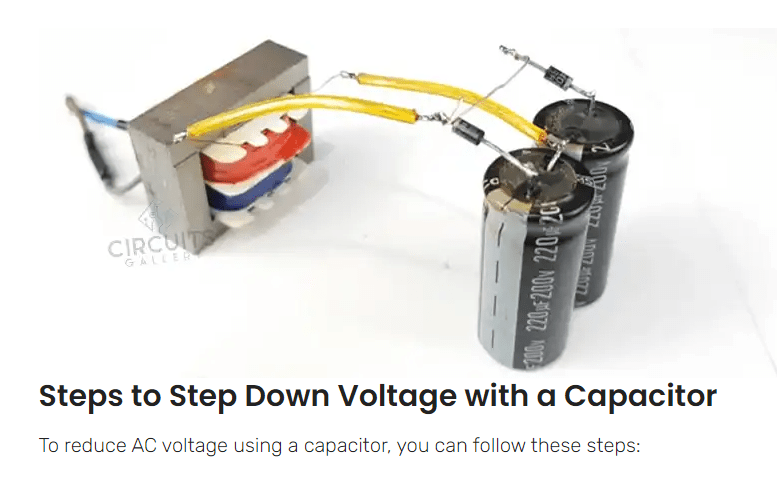

This is what I am after, I found while searching the net. But I do not understand the conversion formula.
https://www.google.com/search?clien...UKEwja6ve1_aOBAxWlcWwGHQVXDDUQkeECKAB6BAgIEAE
But for reference this is what I need to achieve
34 volts into Raw Power Supply (I currently have 42V)
44 volts out of Raw Power Supply

Hi, I have been trying to build up a 240VAC transformer unit to run a phono stage. The trans is rated at 36V & 300W, but when connected to the mains it is massively putting out 48V.
So to reduce the voltage to the required 36V, I inserted a 240V voltage reducer, before the phono trans mains lead. (I bought for another project into the mains circuit, but did not end up using it) To get the Trans output down to 36V I had to reduce the mains down to 180VAC.
I have tried the phono amp out in this format I it works very well, however the trans gets very, very hot (still touchable, but only just) so I have only used it for short periods of time because I do not want to burn the unit out!!
