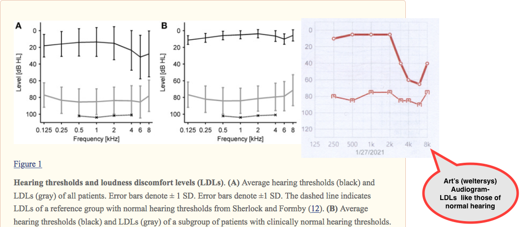

Your audiogram does not seem to have any LDL symbols as can be seen on mine in the OP, the lower line with the “m”-like symbols that indicate loudness discomfort level (LDL), the intensity of sound at which you would report sounds to be uncomfortably loud. The LDL is measured to determine your dynamic range of hearing, the range from the softest to the loudest sound you can tolerate without discomfort.
If your LDL was not measured, that could be the reason you describe the hearing aids prescribed ten years ago as "agonizing", they may not be properly adjusted for your remaining dynamic range.
There also have been advances in technology in the last 10 years, the aids you were prescribed may not have been capable of individual frequency band dynamic compression available in premium hearing aids.
If your audiologist did not conduct an LDL test previously or during the last test, I'd suggest finding another audiologist before waiting for an MRI.

In the “Audiometric Characteristics of Hyperacusis Patients” study you linked, LDLs are little different between those with hearing losses compared to those with normal hearing. Note the LDL pattern of my right ear is slightly above those with “clinically normal” hearing thresholds.
Reported in the study results:
“With an increase in high-frequency hearing loss, LDLs are also slightly increased in the hearing loss region, albeit to a much smaller degree than the HTs… hearing loss can be ruled out as a determining factor for hyperacusis…when hyperacusis patients were tested with natural sounds like dog barking or baby crying, LDLs were often considerably lower than for pure tones, suggesting that natural sounds might be more suitable for quantifying sound sensitivity problems.”
