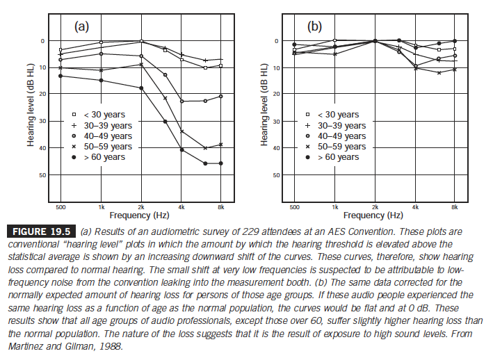

From Toole, "Sound reproduction":
Even with such extreme HF loss, they still use the same ears to hear real sounds in everyday life, and thus still have the same reference as young people with undamaged hearing.
I can't remember the last time I heard a lawnmower next door, or a garage door slam and though "someone needs to turn up the treble".
I agree wholeheartedly. That said, I can also see some merit to the argument. If an old surgeon had shaky hands, maybe he should get it fixed(if possible) or just retire. An old recording engineer may want to get hearing aids if they want to continue working.

Marcus, are the 30, 40, 50 etc years the age of the engineer, or the number of years he has been in the business(I sort of vaguely remember having done that test).
