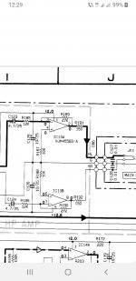

You get some talk over class AA...I was only curious about op amp implementations in Technics SL-P990 and they are touching all meaningful topologies there.I have it used in my DENON DCD 1560 cd player as I/V converter as well.
https://www.manualslib.com/manual/1001309/Technics-Se-A100.html?page=5#manual
It looks like a Fontana Bridge: https://en.wikipedia.org/wiki/Fontana_bridge (so compensated current injection?)I'm curious what the bridge circuit does.

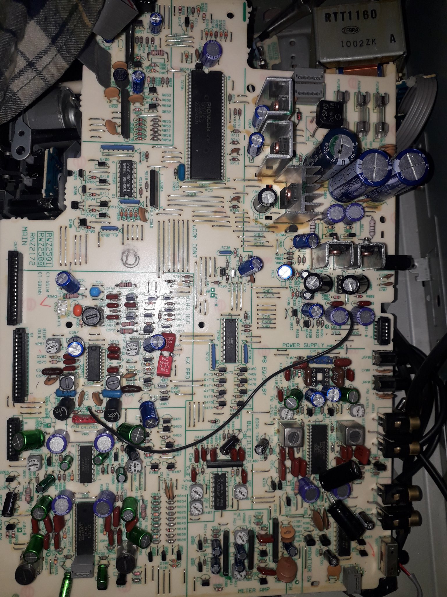

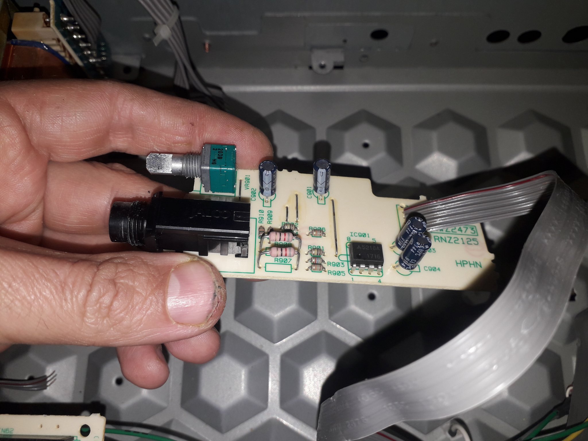

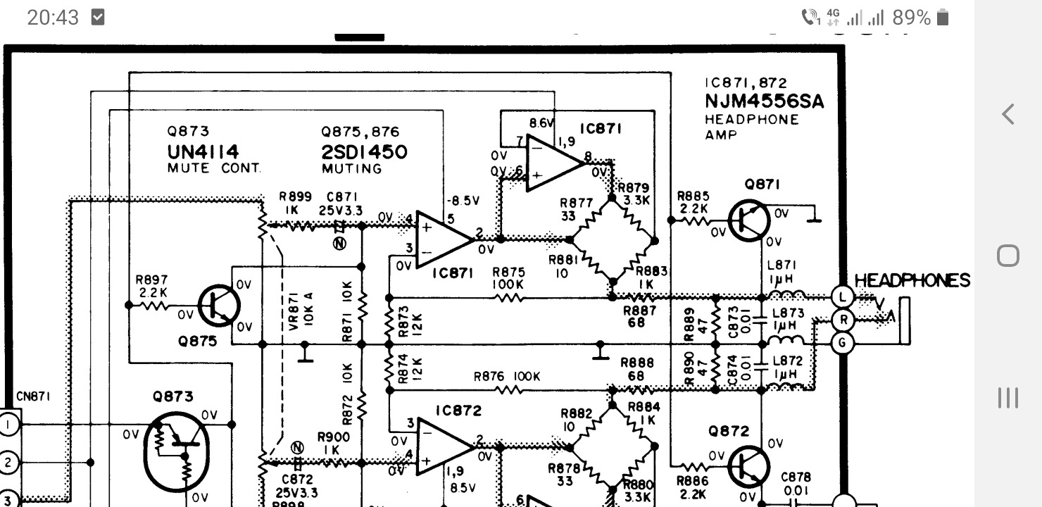

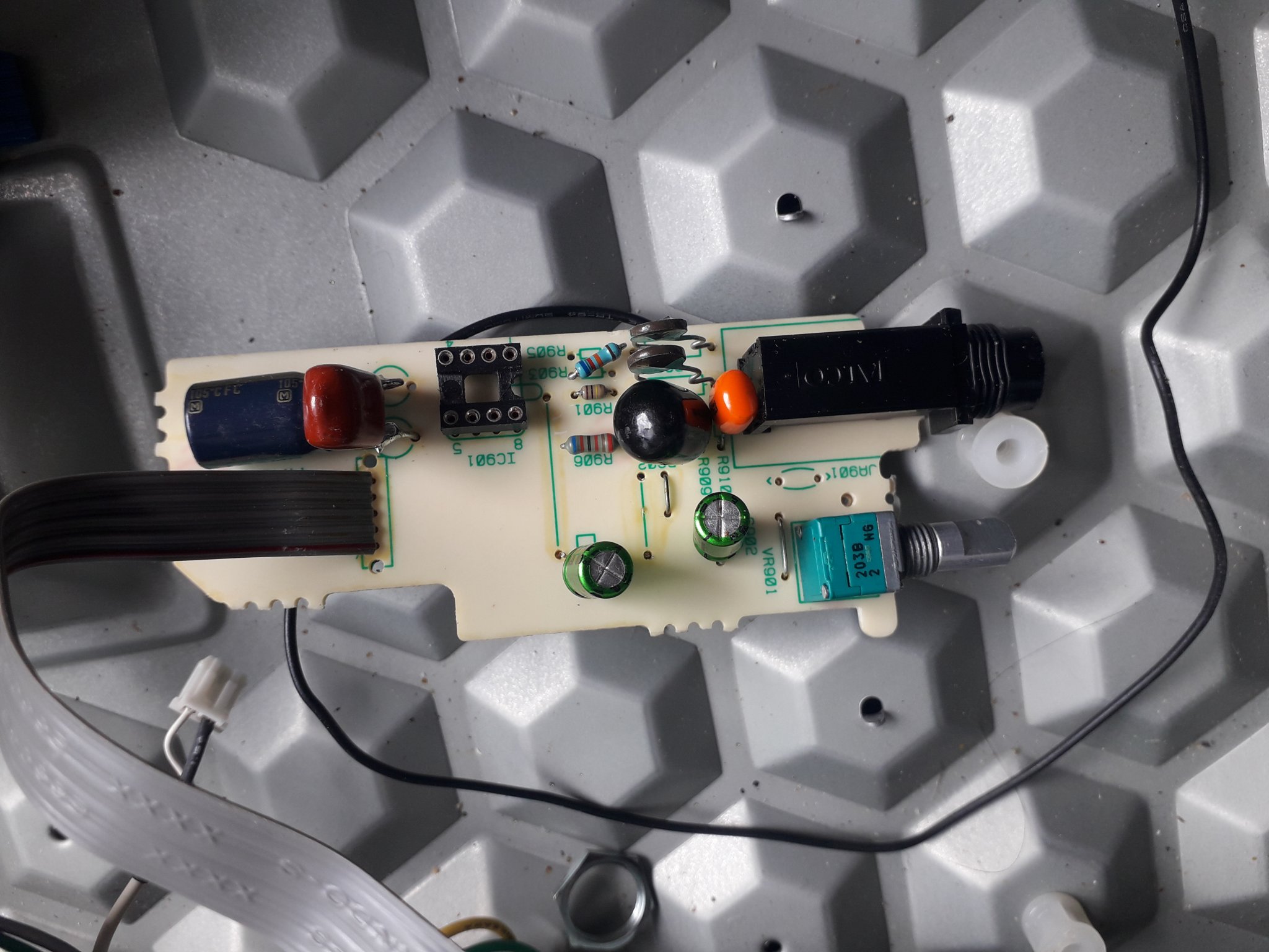

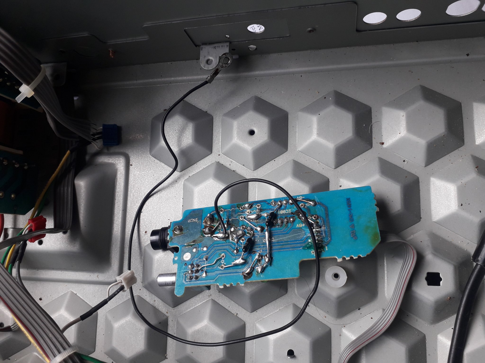

When I make an expensive refurbishment to a cassette deck or a good cd player I also need to have the right headphones preamp to listen the results , so I always transform it into Yamaha's heasphones amp with a small difference, I use at least 5x gain so that I can use virtually any op amp. Then I do the ground mod so that no output or supply noise gets into the input...I usually use my headphone's output instead of line output based on capabilities and on the fact that ususlly it's also provided with a volume control which the line output doesn't necessarily have or when it does, its output impedance is raised significantly from the fixed one.
This time I'm trying some NTC resistors for the 150 ohms series resistor output, just curious to see the results...
If I haven't said that enough I found this particular headphones amp from yamaha kx990 to be the best sounding with njm4556 of all topologies except the Technics class AA buffer.The last photo will be the original headphones section in my kx 400 which is identical with the one in kx 990, but there's no schematic for the kx 400.You wouldn't believe it sounds really good just by the look of it.
