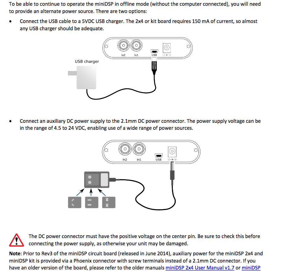

1)so the power supply that comes with the minidsp is no good?
2)then is active crossover the solution if i want to keep the passive crossover?
1) As far as I know, the miniDSP comes with no PSU, power is provided either through the USB connection or the 2.1mm DC power connector. You get what you pay for..
2) Not sure what you are asking- if using a passive crossover, you can get by with one amp channel per ear, but will likely still need DSP to get the desired response. Using separate amplifiers (bi-amping) for each transducer would eliminate the need for passive crossovers.
As far as amplifiers, they deliver voltage, the Hypex FA122 can produce about 24.5 volts-one watt into 600 ohms.
Using "little" amps that can produce the required voltage into the load would be more cost effective.
Depending on the transducer impedance, something like the Behringer HA-400 4-Channel Stereo Headphone Amplifier (approximately 40 mW into 100 Ohms), at only $25 might be adequate for the project. Mono bridging a pair of those amp channels would give you another 6dB headroom if more power was desired for the LF transducers.
