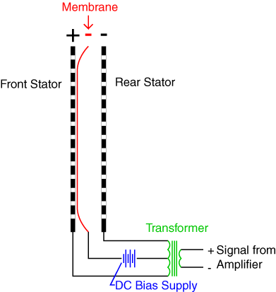

balanced dynamic h.p. are bullsh*t. 🙂 literally same driver, but with little different wiring... this is definition of snakeoil.
for example stax must be balanced, because you have front and rear stator..
but there is nothing similar inside of typical dynamic headphones..😀
you still have only one voicecoil LOL
