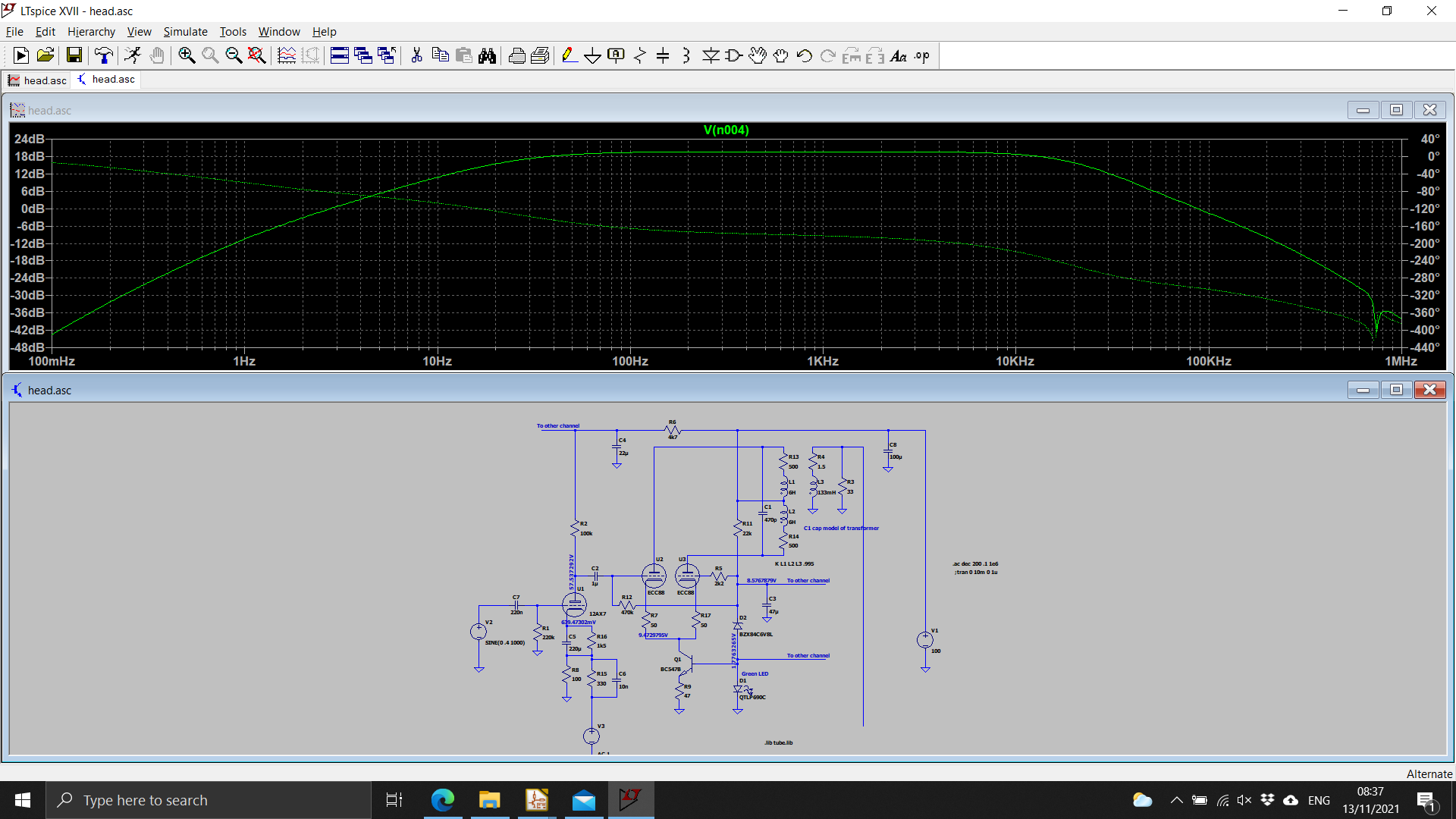

Headphone schematic and layout
Just amazing went to China PCB Prototype & PCB Fabrication Manufacturer - JLCPCB followed the very well explained data on how to format the gerbers. Zip them, upload them to the website and all sorts of magic just happens. £5 + £15 shipping for 5x and 6 days later they are here!

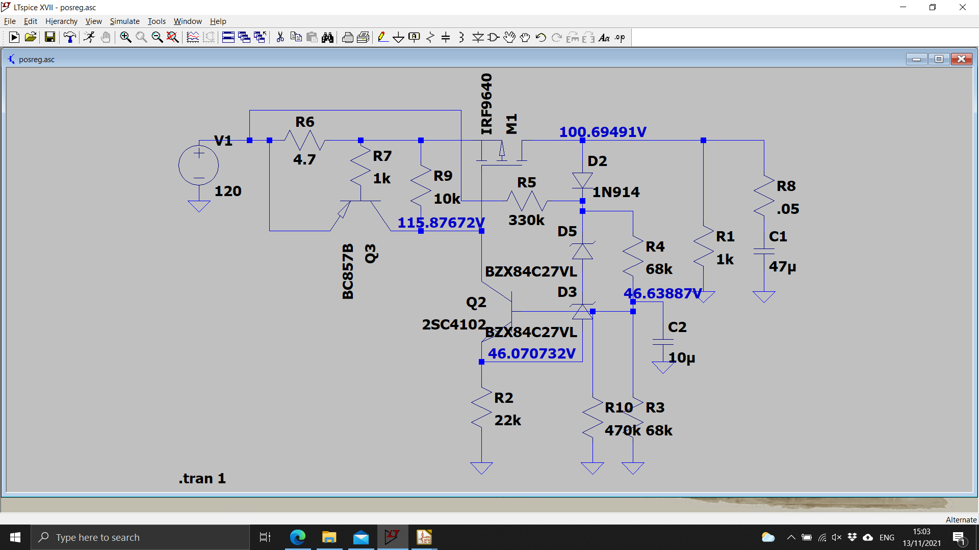

Assembled the board - one channel fine one channel distorted. Missed a very short track from the plate of the ECC88 to the transformer connector. Bother - easy to fix. Had done some swapping of the valves when trying out a 90deg rotation and forgot to do the schematic DRC.
Only tried of bench supply but regs are working so will need to check hum with mains transformers.
I would also change a couple of footprints I used the difficult to solder inline TO92 to TO92L. As a test board have learned a lot. Very pleased with KiCad and the China PCB - would suggest giving it a go.
View attachment headamp.pdf
.. and a big thanks to all who helped.
Some measured results to compare using the RS £15 OPT.
All measurement into 33R load.
20Hz: +/-1.8V OP sinewave
1KHz: +/-3V
20KHz: +/-3V
Distortion 1KHz @ +/-1V
(2nd) -58dB
(3rd) -52dB (.25%)
Frequency response -.5dB 15Hz-30KHz
