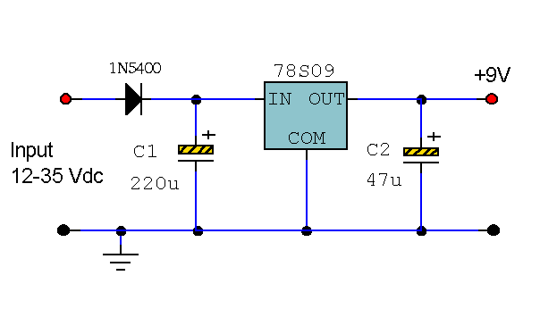

Yep. Use 78Mxx/79xx or others with good noise specs (study datasheets from actual mfr), or LM317/337 low-noise circuits (including Cadj).
I was struggling with how to regulate -ve rail but worked it out about the same time your message came in - once i had worked out what search terms to use it was easy. Thanks for all your help. I might be ready later this afternoon to put a parts list together for shopping this week. I've decided I'll have a go at making a small pcb to mount it all on. I will also look into these LM317/337 as i will have to buy multiples more than I need for this project the adjustable variety might be more use in the long term if I have spares.
Your help on cap values much appreciated.
From in an earlier post you cautioned "Plus, when picking up a supply inside the amp you always have to watch out for grounding issues. Power supply ground + shielded cable = potential ground loop." Can you tell me what I should look out for with regards this? Wasn't palnning on using any shielded cables - or do I use a coaxial from the preout?
Will report on how it comes together - hope I don't blow anything up
LM317/337
After looking at these LM317/337 I am going back to LM78xx/79xx on account of how much hotter the adjustable regulators seem to get. Am I correct in my reading that non-adjustable types disipate less heat? The heat sink size required on that LM317/337 is bigger than what space I want to occupy.
