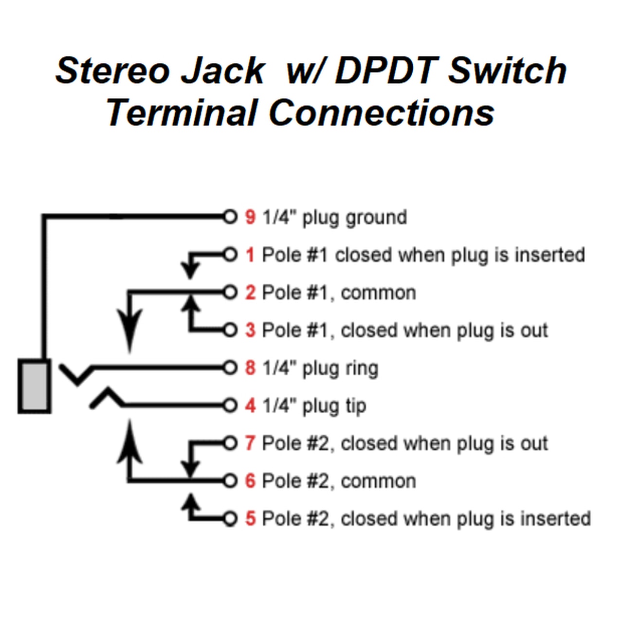

I have a NAD 1240 preamp with a broken headphone jack. It is a solderable PCB-type, I believe the part # from the service manual is
L451Y017H01 PCB TYPE 9 PIN JACK HEADPHONE
This is the actual part that is broken (I stepped on something, lost balance and steadied myself on the first thing I found--the 1/4" heaphone plug sticking out of the preamp). Unfortunately, signal to power amplifier goes through this jack and the accompanying PC-board (# L241A066H12), so not good!
I doubt NAD stocks these, as I purchased the preamp new in 1987...
Does anyobody know where I can get a hold of such a phone jack? I can look for a similar vintage dead amp/preamp, but these are scarce here... Let me know. Cheers!

That's probably unavailable today. If you don't use the headphone jack, it's possible to wire across
the switches in the jack so it does not cut off the signal at the RCA jacks. This can be done either
right on the jacks's switch contacts, or between the preamp circuit's output and the RCA jack.

If you do use the headphone jack, after shorting the switches you'll have to turn off the power amplifier
when using the headphones.

In Switchcraft lingo this would be open tip ring plus *two* isolated transfers, which is not on their 2-page list of codes.
There is enough info on the HiFiEngine manual to permanently juice the RCA outs, losing the feature of silencing them when a HP plug is inserted.

As I cant find the original part ( obsolete ) The UK at Farnell has a whole range of PCB phone jacks so the USA version should have them too --just checked they do.
Mouser has a better display and you can pick your contacts .
I never found it much of a deal changing them if you are not worried about cosmetics .
> 9-Pin 1/4" Stereo Jack for Guitar & Bass w/ DPDT Switch - GuitarElectronics.com
Well spotted. Pins all wrong but all the function is there, and real affordable.

Thanks for your replies. I've had the service manual for it since the 1990s, I've done surgery on the preamp before... I managed to glue the jack back together (cyanoacrylate). It all works as before, but it's a weak point.
I can certainly rewire it, or replace it with a generic switching or non-switching jack. The preamp is already modified anyway: there is an easy way (via convenient jumpers) to insert a re-purposed tape monitor switch to bypass the opamp tone control/preamp, turning it into a passive unit. I found no degradation in sound when fed from my CD player, and the phono preamp is ahead of the inserted bypass.
