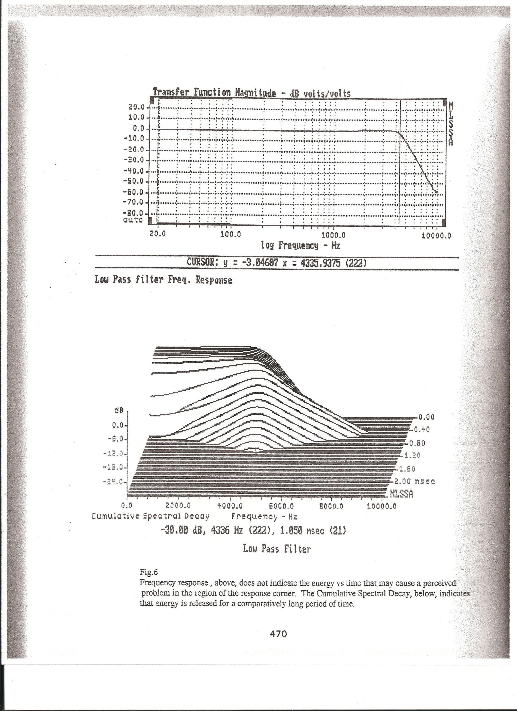

In my limited experience, a narrow peak in a frequency response in more annoying than a wide peak.
A narrow dip in a response is less annoying than a narrow peak of the same magnitude.
The overall flatness of the response in not as important and distortions.
If distortions are produced in an effort to flatten a frequency response, I would choose the less flat response. Is digital frequency modification distortion free? Clarity of sound in paramount.
MLS water-fall plot of active LP filter -
Yes to all of the above.
Note that a flat frequency response with filters (crossovers) can be low distortion as well BUT it still is not percieved as Flat. This is due to the Q of the filters adding energy to the response at the cross-over freq. The total energy at the filters corner has its audible affects.
Thx-RNMarsh
