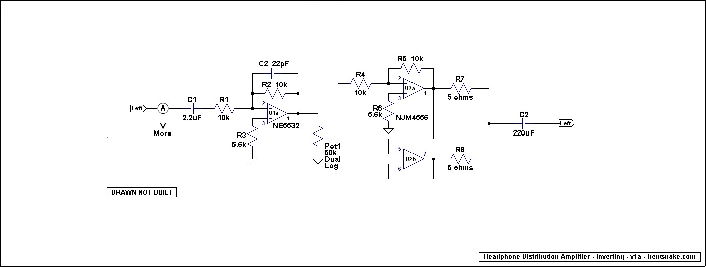

I'm looking for some help designing a simple headphone distribution block. Here's the problems I'm trying to solve:
1) Distribute stereo signal from headphone amp to up to 4 different headphones
a. Headphone impedance varies from 30 ohms (earbuds) to 300 ohms (HD650’s)
2) Independently control volume on each output
3) Desire (not absolute): Passive circuit – simplicity has high value
Here’s a schematic (sorry for the cruddy image) I found that is probably close but obviously missing pots and any insight on resistor value in respect to above impedances.
Questions:
1) What resistor values should I use?
2) What size pots should I use?
3) Should I design different signal paths for each impedance?
4) What is the net effect when output 1 volume is changed on output 2,3,& 4?
5) What am I missing?
I've read somewhere that there's a rule where your impedance should be 1/4 your resistance.

Basically, the main purpose of your project as I see it is to nullify, to some degree, the result of connecting parallel loads to a headphone output. Adding more resistance(s) in parallel is obviously not the most effective way to do that. Being 100% passive, one can expect only so much isolation among branches using practical resistance values. In any case. With the different possible headphone impedances, rheostats seem to me to be the better option. You may need to experiment a bit to find the optimum values; the ones I gave were just suggestions.

Non-switching jacks are alright. The dual pots you are able to find can have some bearing on the final product also. The wide range of headphone impedances to deal with passively puts this a little above simple; four op amp voltage followers would probably be simpler IMO.
Nothing wrong with your original concept, but if there is no need for a passive solution, active devices can make things easier and the result more satisfactory.
So yes, a distribution amp. You need buffers, to maintain a load on the single headphone output and isolate the multiple headphone jacks with their potential wide range of load impedances.

In order to get a reasonable and constant input impedance, low interaction between phones, low, identical output impedance seen by each set of phones, plenty of drive, individually adjustable volume... a distribution amplifier.

Meanwhile, another county heard from saying you can't get there from here. Your goals are reasonable, but I don't think you can get what you need with just some resistors. One problem is the impedance load presented to the audio source.
Another is having sufficient current available to drive 4 headphones--and varying headphone impedance.
Yet another is the volume control problem. Depending on configuration, one volume control adjusted to zero might ground the whole circuit, killing all 'phones.
The circuit below is not a build-it project, it's just to show you what kind of thing you're looking at. Just to mention a couple of points, note that:
a. C1 should be omitted if the preceding audio source has a capacitor output.
b. U1 is an isolation stage, U2 is a high-current driver stage (the NJM4556s are in parallel).
c. Inverting configuration is used purely in an attempt to work around the NE5532's annoying bias current. If a similar circuit is built and DC errors are found to be small, then C2 can be omitted.
d. Non-inverting configuration could just as well be used, and would have some advantages, but in that case C2 would be mandatory. Which I personally think is just fine, but some people get excited about that kind of thing.
The NE5532 costs in the 50 cent range on eBay. I semi-recall that the NJM4556 goes for about 80 cents when you get it from Mouser or similar, but that will involve something like a $5 shipping charge (so buy some other stuff at the same time).

Bentsnake's solution is much better and still uses easy to get, cheap parts. Be cautioned that an inverting amplifier's frequency response can be affected by a high impedance source (like a tube preamp). It is good practice to use a non-inverting buffer on the input of an inverting amp; this makes its application universal. In fact, some inverting circuits (not this one) are unstable when the input is open or connected to a high impedance source; this makes the buffer virtually mandatory.
