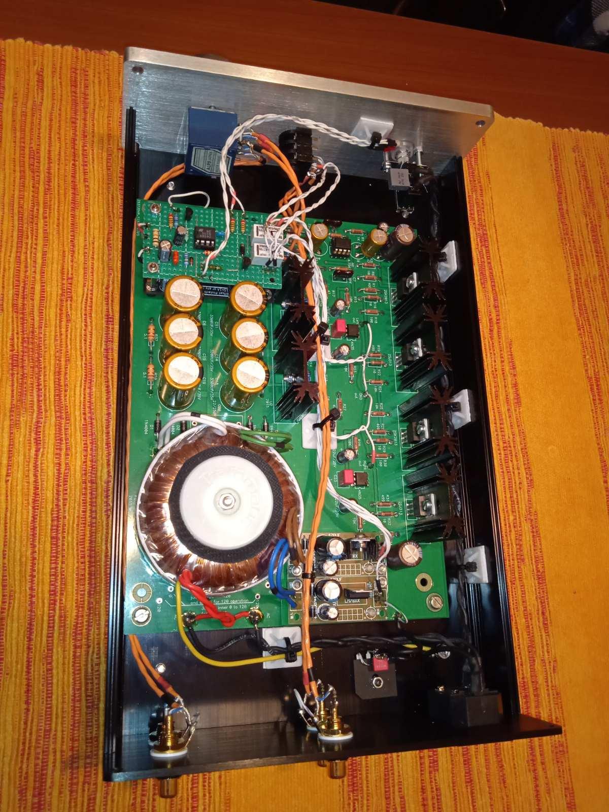

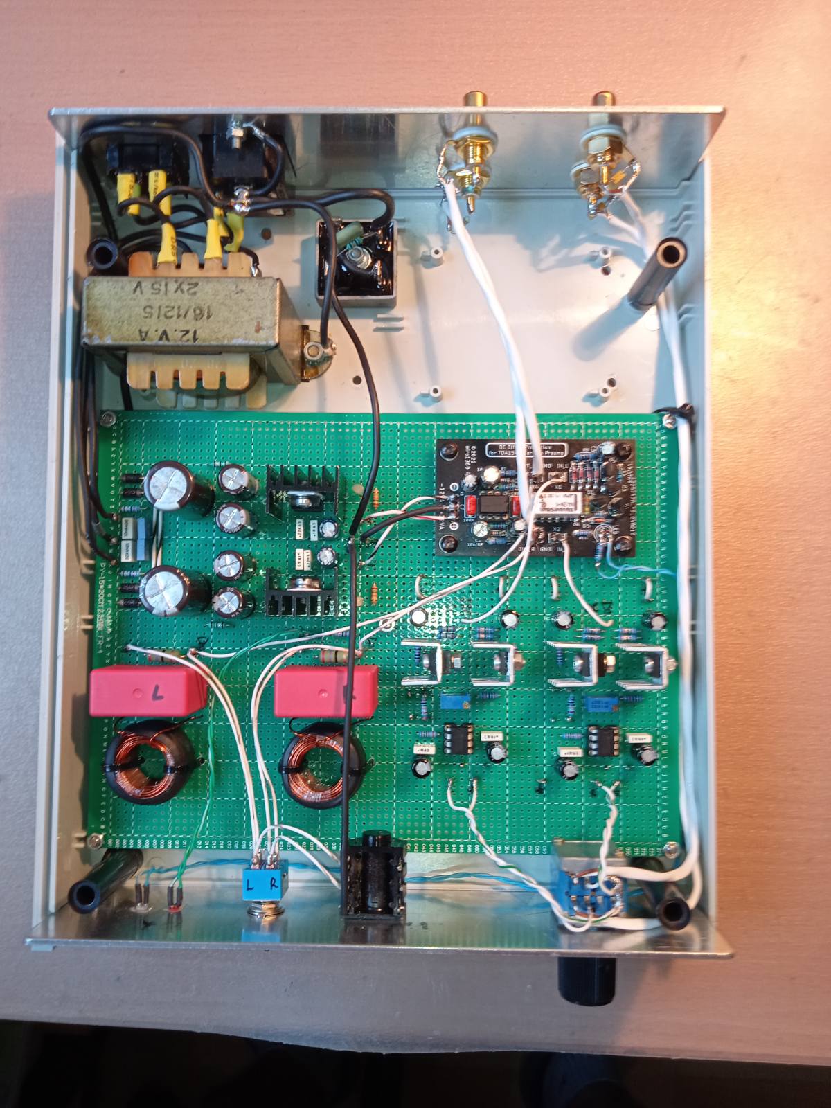

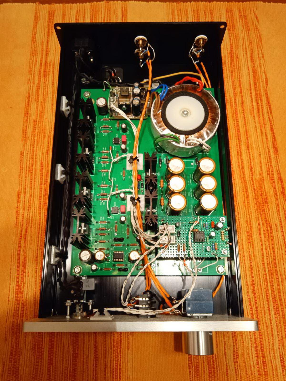

The Omicron is the way to go if you ask me. It has a discrete A/B output stage and includes (lots of) negative feedback of the output signal in order to reduce all kinds of distortion. It has been built by many by now and proved to be an excellent headamp on both measurements and audition.
If you need more power, have a look at the Krell KSA-5 clone with my mods. It is not as good as the Omicron, but it can drive normal loudspeakers and sounds pretty decent. The gerbers of the (original) PCBs are available, BTW.

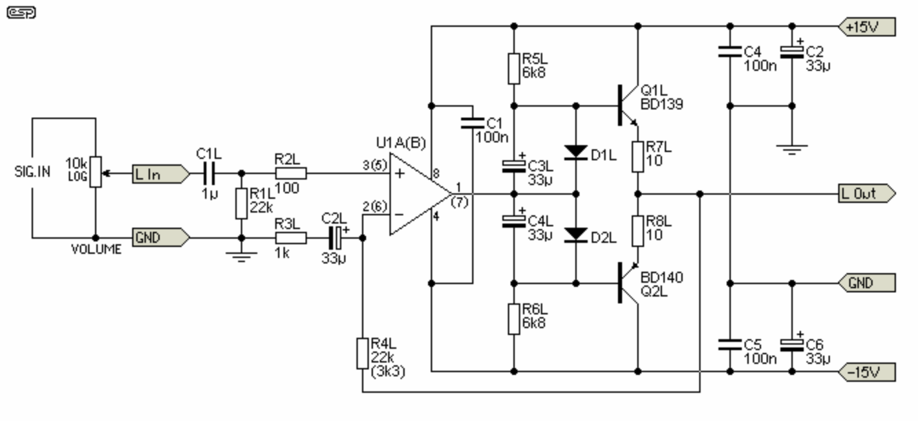

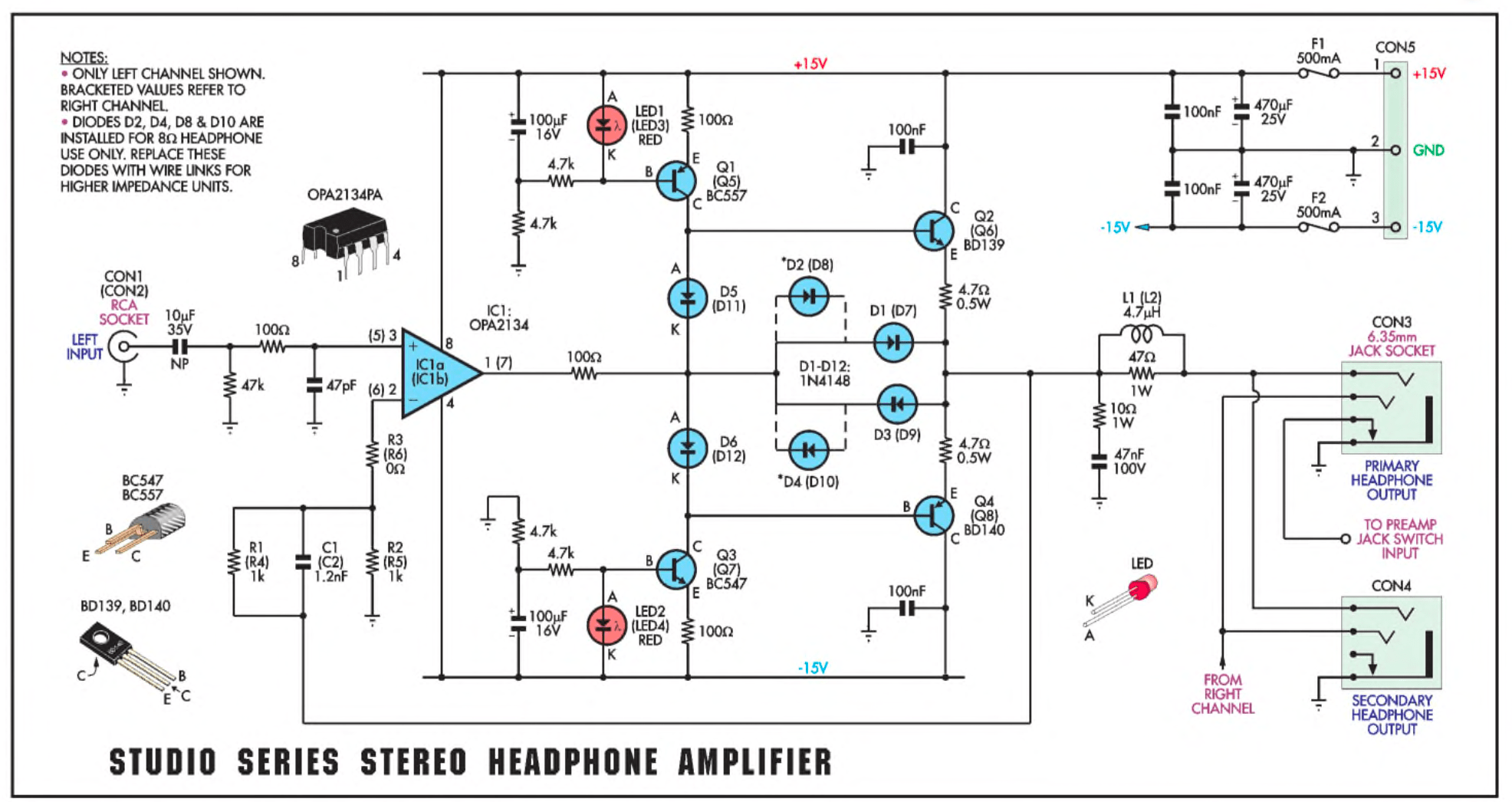

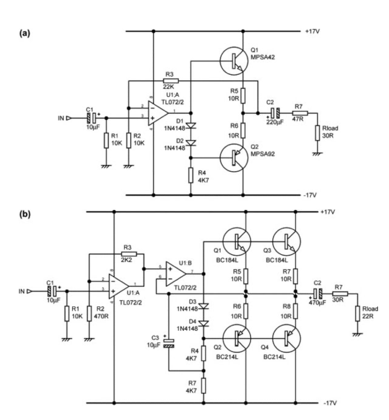

That's the headlamp that has been floating around for long time. For example, it has been published by Douglas Self in hiss Small Signal Audio Design:buffer a descent op-amp and it should be plenty for headphones
by Rod Elliott:
by Silicon Chip and Everyday Practical Electronics:
and probably by others. It works, but its performance is limited, so don't expect miracles.

@alexcp Thanks for posting these circuits. The first two look similar to the Omicron. Is the Omicron superior to these? If so, what do you think makes it better.The Omicron is the way to go if you ask me. It has a discrete A/B output stage and includes (lots of) negative feedback of the output signal in order to reduce all kinds of distortion. It has been built by many by now and proved to be an excellent headamp on both measurements and audition.
by Rod Elliott:

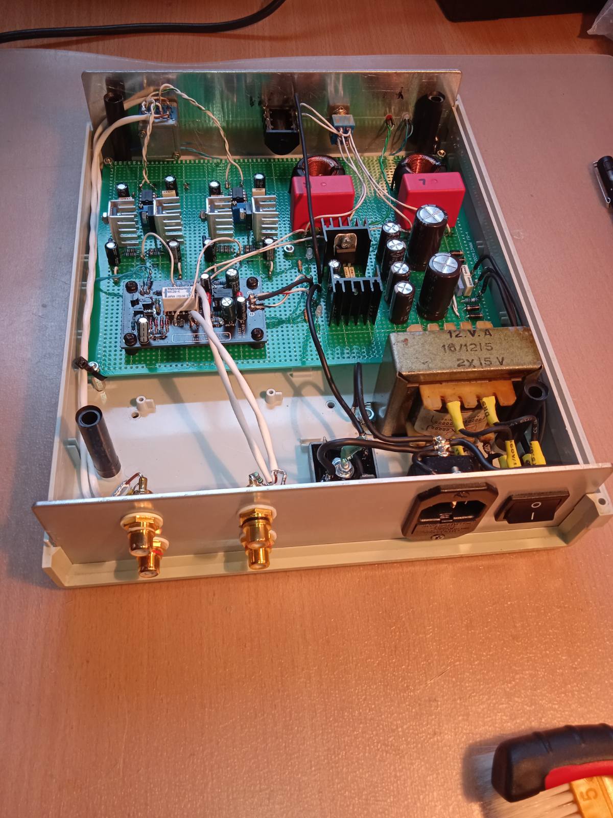

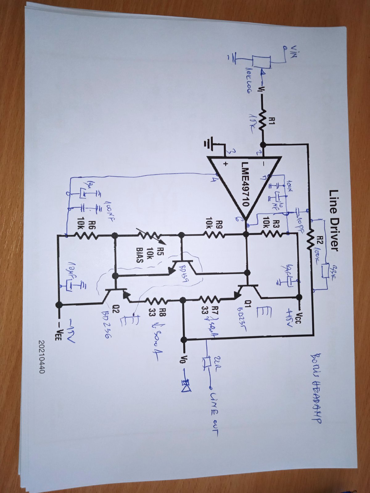

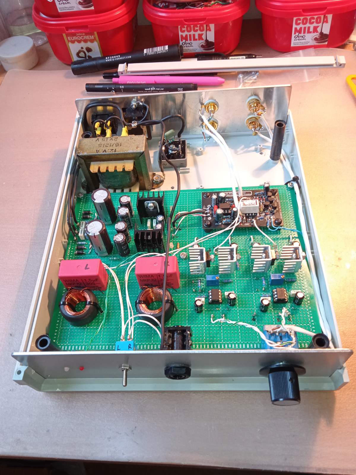

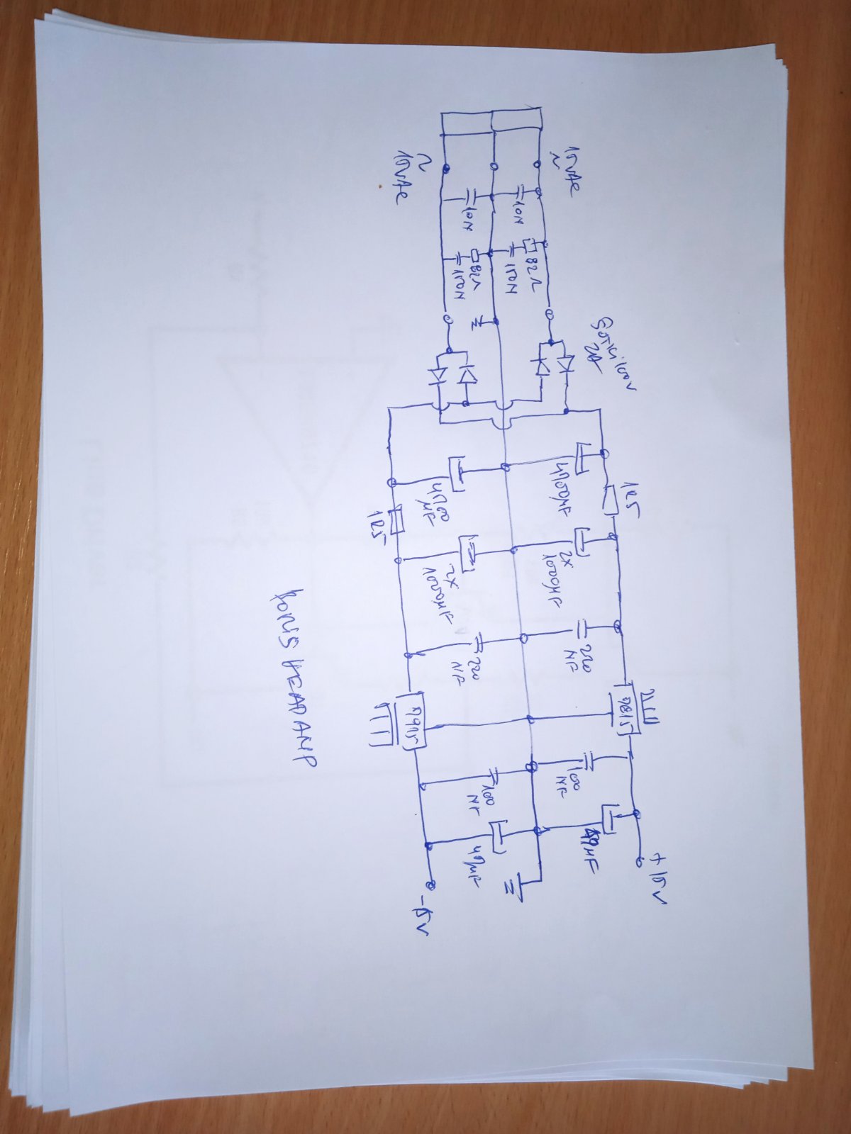

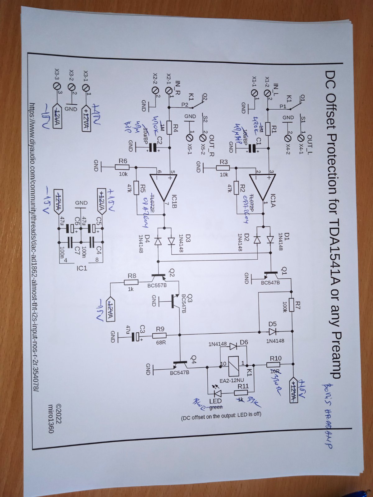

Or something like this, a little simpler and cheaper. Quiescent current is 30mA. It can be more, with a stronger power supply and bigger coolers. A non-inverting schematic can also be used. The power supply is 7815/7915. DC protection is by @miro1360. A higher supply voltage can be used, up to the OPA limit. Other (stronger) output transistors can be used, I had these available in matched pairs. Compensation must be adjusted for each OPA and output transistors (10pF or more). For awkward loads (capacitive) Zobel compensation may have to be added to the output.
Yes!Is the Omicron superior to these?
(Depending on what you define as "superior", if course)
Much more open loop gain, more negative feedback and less distortion.If so, what do you think makes it better.
Ah, they all look similar - there is an opamp at the input and a complementary emitter (or source) follower at the output.The first two look similar to the Omicron
The main difference is that the Omicron is a composite amplifier (that is, its two opamps work in a single feedback loop). Because of that, Omicron has at least two orders of magnitute more loop gain and proportionaly less measured distortion. (Thank you @stv!)
There is a school of thought that says the amplifier's distortion below a certain threshold is unimportant (inaudible, masked by the distortion of the source/cans/something else, etc.). However, the difference has been very much audible to quite a few people, some of them quoted in the first post of the Omicron thread.

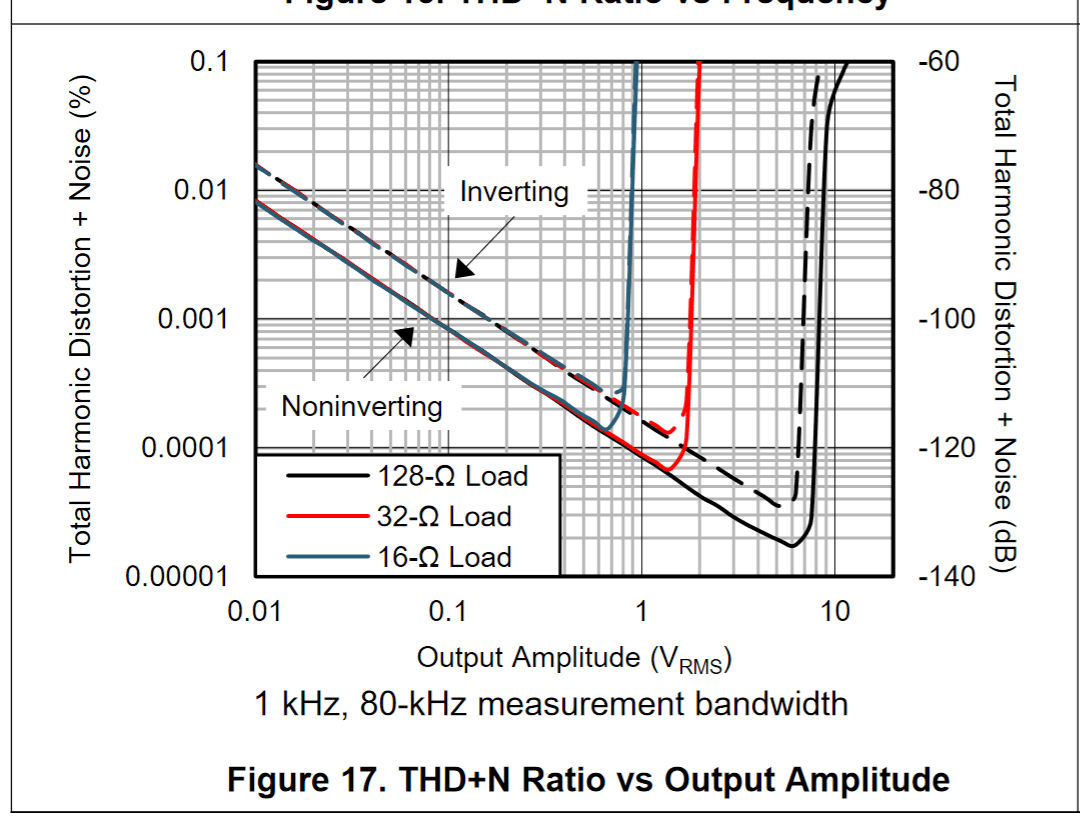

OPA1622 is an easy solution for portables, also for planar.
And of course Class AB, as requested.

Neurochrome rated the hat with OPA1622EVM 360mW for 50Ω, < 0.01 % THD+N.@yys310 Ideally 2W per channel,
Seems that it won't reach the output you desire but still worth trying...the OPA1622EVM from TI only costs ~25USD.
