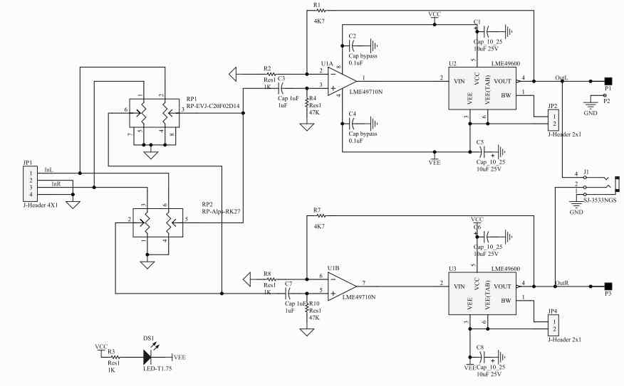

Hi All,
I've not yet built the design because I wanted to get your thoughts and to check that I haven't done something seriously wrong.
This is my very first project so any feedback at all will be much appreciated. The more honest, the better 🙂
Many Thanks
Stephen
Where is ground? You connect + and - power from the supply to the opamps but where is the '0' reference point? Change JP3 to a 3 pin connector and bring the power supply ground to the amps. It's also a good idea to have a different number of pins on your connectors so that you don't accidentally connect to the wrong thing. Sometimes it just doesn't work but it really sucks when you let the smoke out because of an avoidable connection error.

You Right! I haven't updated the diagram just yet but I need to after I added the decoupling caps on Vcc+ and Vcc-.
I have 2 questions about grounds though. Do I connect the centre tap ground to the chassis and do I connect the signal ground the the chassis too?
Good tip about the connectors. I might just add some coloured heatshrink around them before soldering them to the board.

DIP is another limitation. A lot of newer op-amps that would be suitable only come in surface mount form factors (and some are only single channel).
Another popular DIP op-amp you could try is the LT1364. It has a minimum output current of 50mA and a short circuit current of 100mA. Just be aware this device is quite a bit faster than the 2134 and will require special attention to layout and bypassing.

You may connect the center tap to the chassis as a shield but don't use the chassis as a conductor. I would tie the center tap to the PC board and use a 10 ohm resistor to tie the signal/power ground to the chassis. The chassis will shield the system but not allow large ground loop currents AND if you ever toast that resistor you'll know something is really wrong.

As an alternative to looking for high-current opamps or buffers, you could consider something like the '47' instead:
HeadWize - Project: Apheared's Project Scrapbook by Michael Shelton
This parallels two opamps to drive more current. You could extend this to use a quad opamp per channel. The 47 ohm resistors ensure that the output current is shared between opamps.

That was an excellent piece of information 🙂 I really appreciate the the theory. Definitely help choosing components.
I'm starting to lean toward the BUF634 as a buffer stage which has high current, 250mA, and high bandwidth.
If no one can see any problems with using a OPA2134 then a BUF634, then my next job will be to find a UK supplier with a reasonable price tag........

you must read Walt Jung before ordering parts.
He details, extensively, the design of composite opamp amplifiers.
signal gnd = feedback gnd = load gnd
also you can save 1/3 on amplifier parts/cost while improving performance and efficency by dropping the "3-channel" output gnd when you're building a perfectly fine dual supply

The Pimeta’s "3-channel" topology is fundamentally flawed - most technical reasons given for it are simply not true or can be bettered by proper layout
"active supply splitter" can be useful when wanting to use single V supply - the single active gnd should be used for input, feedback and load gnd
but "3-channel" puts the gnd “buffer” amp in series with the load - with the input and feedback grounds separated from the load gnd - this means all of the error of the "output gnd" buffer is in series with the headphones - giving distortion and "output gnd" impedance crosstalk that is worse than with a good "passive" gnd of heavy conductor with signal input gnd, feedback gnd "star" connected with the load common ground pin of the TRS connector
A "active gnd" showing star at output - can better "3-channel" performance:
