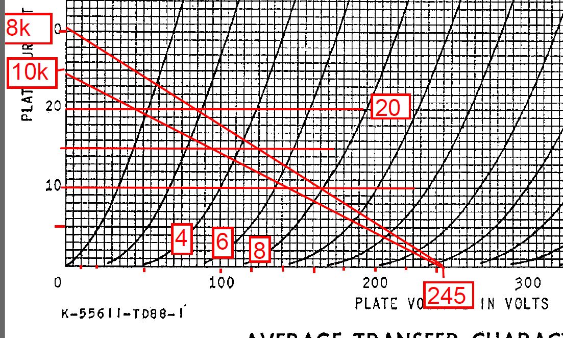

I have a Ming Da headphone amp, now obsolete, that I have a few questions on.
I modded this amp a couple years ago, but then stuck it in a closet. Pulled it out this weekend, and played with it.
It is designed for one 12ax7 in front, then a pair of 6H6N tubes that drive a pair of output tranny's, single ended. The 6H6N each have their two sections tied together in parallel, so one tube is for one channel.
Mods I made were to lower the heater voltage which was a bit high, around 7V, and to rewire the 6H6N to a 5687 tube.
Back when I did this, I knew very little about tubes. Now I know just enough to be dangerous.
Last night I figured out I only had 1/2 of the heater wired up, so I fixed that and thought it sounded pretty good.
I traced out a schematic, and in looking at it I saw I didn't have a resistor on the cathode. So the cathodes on the 5687's are floating, except there is a 100uf cap from the cathodes to ground. Even I knew this didn't seem right.

I also found some pics that show a 330 ohm cathode resistor, and someone else that said it was 320 ohms, so I think that is what ming da put in.
I swear I didn't remove any resistors, but it is what it is lol.
I also think B+ is 290V or around there.
Plugging in those numbers into the 5687 tube curve, seems like ming da was going for a -5V cathode voltage, and 15ma of plate current.
I was thinking of going for -6V with a 430 ohm cathode resistor, at 14ma of plate current.
Does this make sense?

So I screwed up, there is a 330 ohm cathode resistor installed, I just put it on my schematic, oops :/
I did measure B+, it was 245V, so I had to redo my tube curves. Based on my new curves, looks the 330 was as close as you can get in a standard value for the 4V curve at a load of 10k load resistance.
Found it was easier to markup the curves with acrobat, and attaching a picture to show what I did.
Even though it turned out I didn't have to make any changes, it was good since I learned a little more about tube amps and how to figure out the curves.
