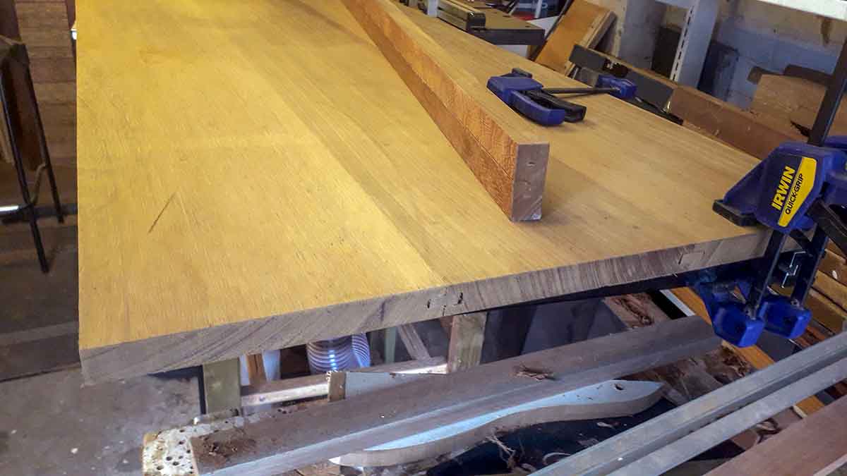

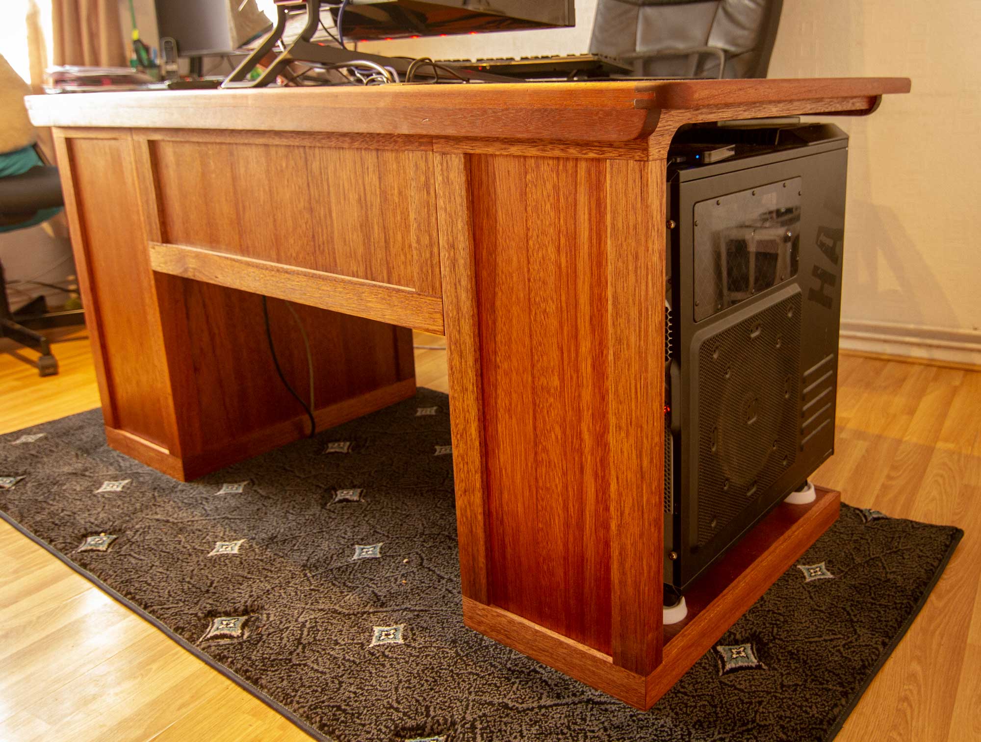

I've just finished building my new desk, and have enough timber to make some nice matching desktop speakers.
I want them to be small, full range speakers, generally for watching movies, YouTube and some background music (I have headphones for serious music listening).

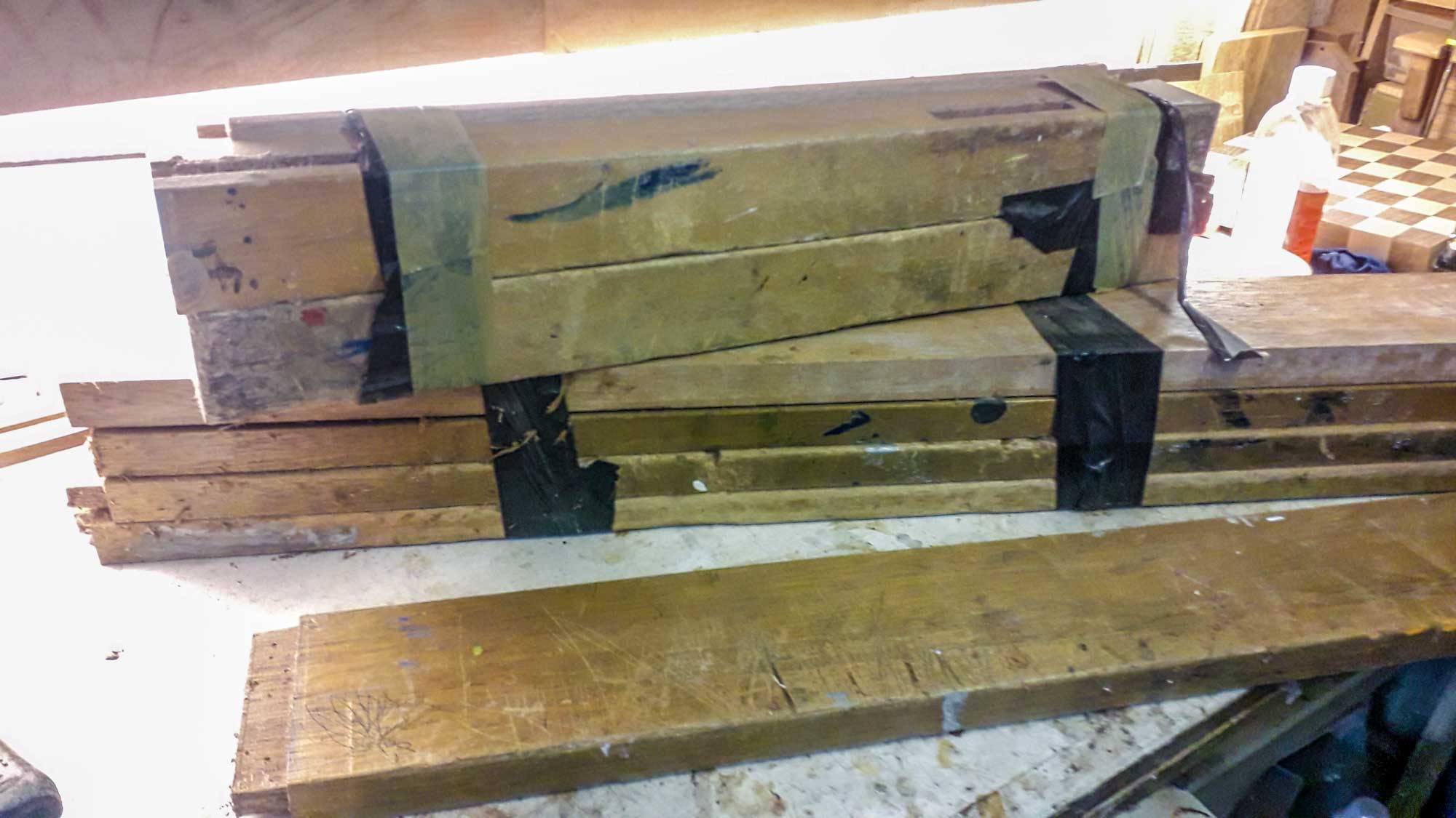

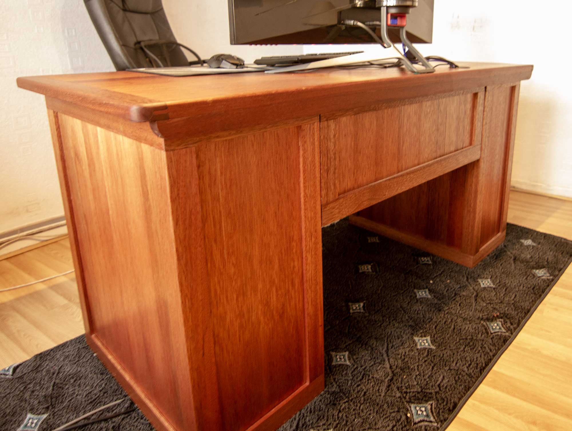

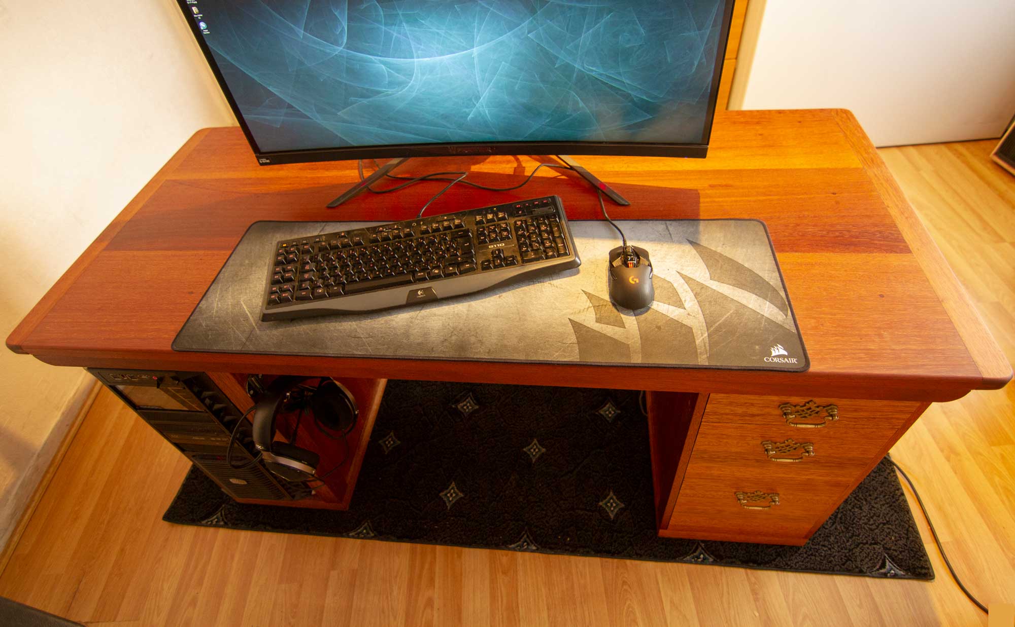

This time, as I said previously, I've just made a nice desk from some skip timber I found, and having a bit left over I'd really like to finally get them done.
That's a lovely looking desk.
jeff
Thank you Twocents
