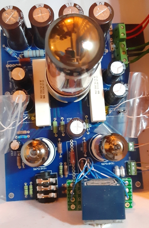

Here are a couple of pictures of the actual PCB.

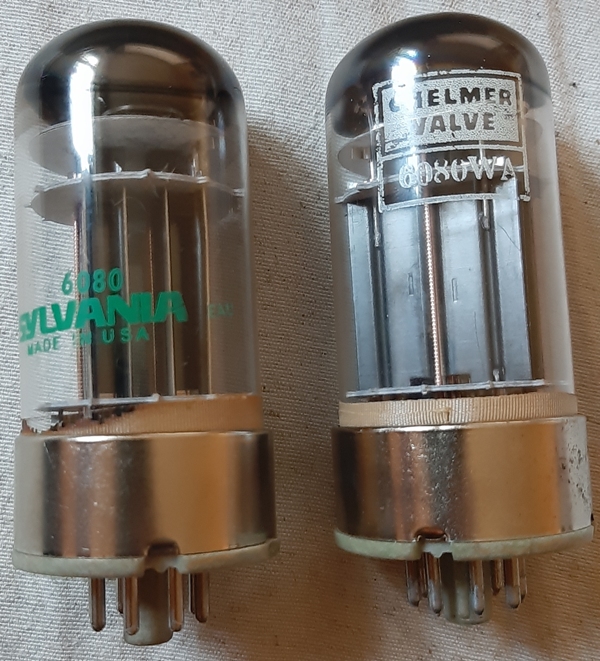

Actually, I got a couple of those 6080. They are the only ones I have for this kit at the moment..
One is a Sylvania (USA) which seems to be pretty common and the other one is a 6080WA by a rebranding company in the name of Chelmer (i think it used to be a UK company). It looks extremely similar to the Sylvania one, so it might actually be a rebranded one.
Both of them are used and the problem is I have no equipment or way to test these.
I haven't put them on the PCB for a test drive yet...
Actually the Sylvania one seems to ring and rattle a bit when I tap it lighlty with my finger. Both do, but the Chelmer seems to do it less.
I might post a video (with sound) so you can tell me your opinions on that.

A pic of the two tubes.

If you check out the information on the 6080 you will find out why they develop grid/heater/cathode shorts .
The grid/cathode spacing is very close, closer than a normal tube
they get very hot and that causes expansion of the cathode.
Have a look at the superior -6AS7G, its actually designed for single ended audio use -MUCH superior construction .
I have had a 6080 in bits and can vouch for this.

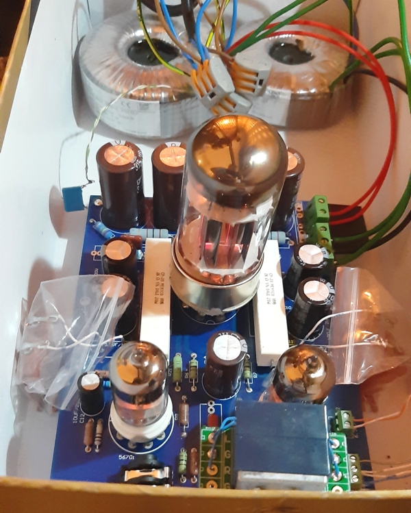

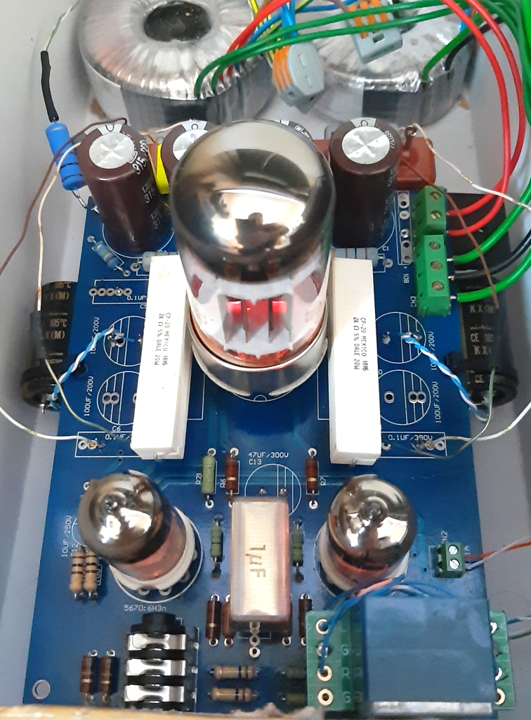

I've been using this amplifier with my Sennheiser HD599 pair and I'm positively surprised.
The amp is silent even at the highest volume and the sound I get from it is certainly to my liking.
Comparing it to my previous opamp projects (a Lehmann Black Cube clone with parts from Mouser) this tube amp sounds beautifully.
A more 'organic' and 'full' type of sound that is both smoother and engaging.
This is an OTL design and I wonder If I could do something to further improe the sound. As can be seen in the schematic, each channel's output to the headphones is coupled by two parallel polar aluminuim elecrolytic capacitors (2x100uF, 200VDC) that are also in parallel with a film capacitor of a much smaller value (0.1uF, 300VDC).
In the position for the 0.1uF film capacitor I've used a Cornell Dubilier 3.3uF film capacitor, in parallel with a 560nF Soviet PIO.
The amp sounds nice but I wonder if those two 100uF electrolytics can be ommited completely and be replaced with film capacitors of some smaller value. Maybe a 10uF capacitor alone or in parallel with a smaller value one?
Any feedback on the above would be appreciated greatly!
Thanks for reading!
Attached is a picture of the amplifier at a temporary box.

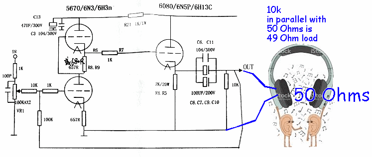

> what I understand the coupling capacitors form a high-pass CR filter with the following 10kΩ resistor to ground. ... Right now, with its 200uF capacitor value, the cutoff frequency is at fc = 0.0795 Hz.
You are not going to connect headphones to this headphone amp??
I use it with a pair of Sennheiser HD599 (impedance 50Ω).
So, from what I understand the coupling capacitors (C6,7,9,10) form a high-pass CR filter with the following 10kΩ resistor to ground.
A 200uF capacitor value, will result in a cutoff frequency of = 0.0795 Hz.
By looking at the schematic, are there any more ways those coupling caps (C6,7,9,10) affect the frequency response??
I'm no expert.
Still learning.
Thanks in advance.
I'm no expert.
Still learning.
Thanks in advance.
I use it with a pair of Sennheiser HD599 (impedance 50Ω).......10kΩ resistor to ground. A 200uF capacitor value, will result in a cutoff frequency of = 0.0795 Hz....
Wait, I thought you had 50 ohm phones?
The 10k (which you don't listen to), in parallel with 50 Ohm phone (which is what you really want to drive), makes a 49 Ohm total load.
Rule of thumb: 100 Ohms wants 100uFd to get to 20Hz. So 50 Ohms wants 200uFd (and 49 would be 204uFd).
Doing math I get 200uFd with 49 Ohms gives 16.2Hz for -3dB. Which is about 32Hz for -1dB, 64Hz for -0.5dB. OK, not fantastic.
The small-signal response will be flatter lower due to the NFB. But the NBF is small.
If you change to 10uFd then the -3dB point moves up to 320Hz!! Telephone quality bass. NFB may extend small bass toward 100Hz, but large bass is crippled by the too-small capacitor and be both weak and distorted.
There is no sensible alternative to electrolytic caps here.
PRR thank you for your expertise and help!
So, not fantastic at all..
I need good quality and large enough electrolytics.
If you change to 10uFd then the -3dB point moves up to 320Hz!! Telephone quality bass...
..There is no sensible alternative to electrolytic caps here.
Yeah.
I see there is no way around them.

Update on how things progressed so far and how this kit sounds:
After PRR kindly explained that I should calculate high pass with total load in mind (including my cans in the equation) I went all the way and increased capacitance.
I added more than 6x the original amount (200uF per channel), to the limits my final enclosure would allow (still having the kit in a shoe box for testing).
So, I installed 2x Nichicon KX 680uF (1360uF total per channel) in parallel with:
1uF soviet MBGCh PIO
10uF MBGO (might be replaced with 10uF ERO MKP1813)
0.22uF EPCOS film capacitor (might be replaced with a smaller value KBGO PIO)
Also changed a few resistors. The grid stoppers were replaced with Kayama carbon composition and the feedback resistors with Little Demon carbon films.
Soundwise, I am quite pleased and love the way this kit performs with my 50Ω impedance H599. I will also try them with my HD600 which are higher impedance.
And how it relates to the NFB?

By the way, what is meant by small-signal bass response in contrast to large bass?The small-signal response will be flatter lower due to the NFB. But the NBF is small.
