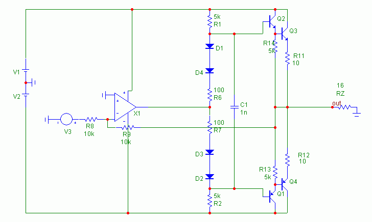

John, I did the same, but with LM1875.
Why use a current boosted opamp if you can use a power opamp?
Current boosted opamps when class AB are very critical regarding distortion, as the crossover distortion sometimes are too high.
