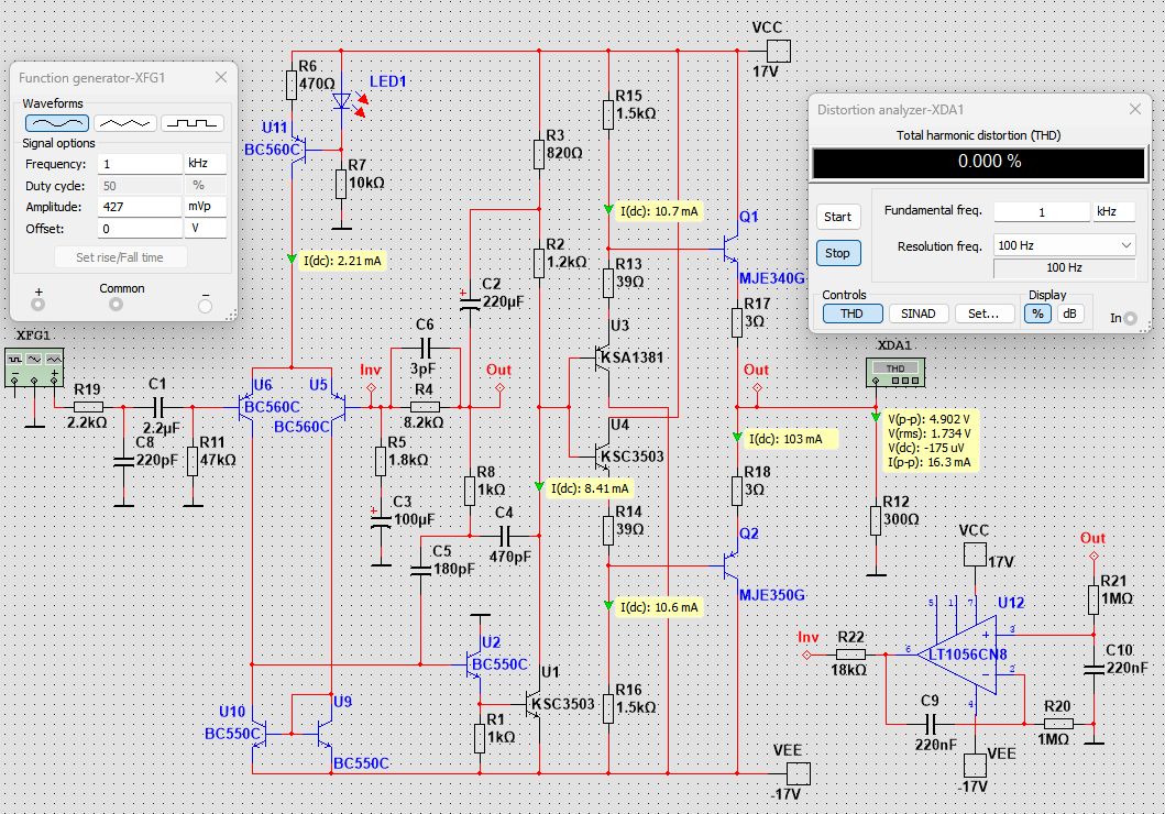

Headphone amp based on LineUp's Navaho amplifier
I'm still in simulations I think Toshiba/Onsemi combo tansistors are a good choice
Distortions at 1 kHz sine are too easy so..
