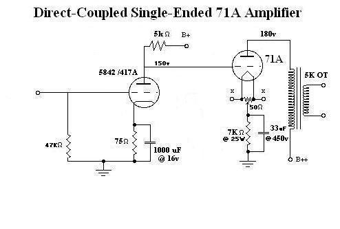

As a side question, what about RPower's 71A direct coupled design?
(Schematic attached.)
Oh, I've got another quick question as well. Is it a bad idea to connect headphones with an impedance of 32 ohms to 8 ohm outputs? dsavitsk, you mentioned that you were using a custom transformer with 32 ohm outputs. Does that transformer allow the amplifier to work with headphones of slightly higher impedances (50 ohms for example)? If so, about how high do you think it can go before the performance starts to degrade?
Eclair said:Ah ha, great advice! Perhaps I should give the 6W6GT a go initially. I guess I should probably start from the bottom and gradually go up the ladder. Direct reactance drive and parafeed sound like great choices as well.
Looks like a reasonable design except for the 1000uF cathode bypass cap. This will have to be of exceptional quality not to audibly degrade the sound quality, and bypassed with multiple smaller caps. (I made this mistake in one of my own designs, and ultimately found a moderately expensive BG electrolytic with several smaller BG in parallel to be acceptable.) You'd be better off with an LED chosen to provide the correct operating point. You can tweak the bias voltage to get the right operating point for both stages as they are interdependent being dc coupled.
