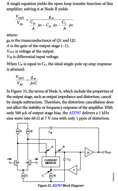

I find that a pernicious infinity has snuck invisibly in to your Fig 33 equation. No surprise. We knew the formula is not entirely realistic, after all it predicts an output in the absence of an output stage.
BTW, minor quibble, the Fig 33 formula may have a stray minus sign; when Cc=Cn the op-amp seems to be inverting?

@Scott: The AD797 is a clever design, of course. Not least the use of capacitors to provide output stage feedback, as opposed to resistors, making the system less voltage level dependent whilst facilitating bandwidth adjustment. Having user-adjustable internal stage feedback is unusual too, I believe (I rarely use opamps). The audible performance (not the primary target market) is capacitor dependent and arguably more problematic than using resistors.
FritzS’ question about the type of external C1 to use is interesting. It has me thinking about whether there are any subtle implications of paralleling caps via a current mirror.
I have a specific question.
In Fig 45, C1 is shown connected between pin 8 (node A in Fig 33) and ground. However, the dominant pole capacitor which C1 is "subtracting" from (Cc) is connected internally between node B and Vss (pin 4).
Why isn't C1 connected between node A and Vss (pins 8 and 4)?

Also, would connecting C1 to Vss provide some benefit to PSRR?
Are there any downsides to this?
This confused me earlier as these cap values are for C2, not C1. So I thought you were asking about capacitor types for C2.Now I will spend them the suggested 'Distortion Cancellation and Bandwidth Enhancement' caps, 47pF or 56pF (which are better?).
The data sheet examples use a max C1=33pF, presumably because higher values will cause increasing instability.
To optimize distortion you want C2 = 50pF - C1.
So C1 will not be the same value as C2 unless they are both 25pF and will probably need to stay below 33pF, unless Scott says otherwise.

With care in getting the bypass return current right it should not matter, easy to try. BTW if you look at the AD8010 data sheet the slightly unusual bypass arrangement was absolutely necessary to meet the video diff-phase spec. I spent a week building dead bug boards and cutting leads to a mm trying to get a normal arrangement to work.
On the bandwidth enhancement, yes you can make an oscillator at 50pf there is no net compensation. This part of the DS is a little esoteric and the values were empirical you'll have to experiment.
