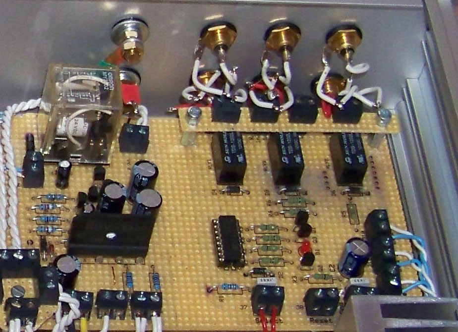

I don't do much pcb manufacturing but when I do I prefer
to wire all the components with bare wire. I print the parts
and traces layout on both of the sides of pertinax predrilled
board and follow the paths.
An excellent method. Hard to argue that it would be more time consuming than creating a proto pcb. It's been a long time that I've heard the word pertinax. 🙂
Lovely work! I am absolutely full of admiration for folks who can generate that kind of work from that process. I've tried the same, but inevitably end up 'planning' the build by drawing it up in eagle... and then wondering why I don't just make a PCB from that art 🙂

Thanks guys! I'd like to point out that my guiding idea to make
boards this way wasn't a belief that somehow wire is better than
professional executed stuff, but my hesitance to spend extra cash
on accessories to complete it in a traditional fashion. Certainly I won't
be pulling this kind of a stunt on a frequent basis. :smash:
