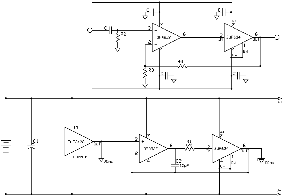

headamp design check.
I want a nice amp for my desk. Sure I could buy a kit somewhere, but that is not my style. It certainly wont help me learn very much.
This is what I have been working on for now. A basic concept with expensive components. I call it the kitchen sink.:clown:
Tell me what you think. Am I nuts?

So, it's a PIMETA but without the Jung Multiloop topology?
It's a perfectly sound concept - I have a PIMETA here using OPA827 in a browndog adaptor for L/R and OPA227 in the ground, all buffered with BUF634.
In short: It'll work really nicely if you can make a good board layout for it. The benefits of Jung Multiloop are pretty small, anyhows, but I'd go and analyse Tangent's schematic for the PIMETA, to see if you can understand the close relationship between that design and this one.
If you're not fussed about producing your own board, I'd do the aforementioned analysis of the PIMETA circuit, recognise that it's essentially the same and that you've gained what understanding is to be had, and buy the PIMETA board, as its layout is both excellent and compact.
If, however, you want to produce your own PCB, go ahead, knowing that this schematic is sound (although I'd like to know what sizes you had in mind for the caps on the opamp and buffer rails. Checking the PIMETA and Mini3 designs should help you determine those).
I tried to look at it but for some reason his site is throwing up an internal error message on the PDF's. At least it was last night.
Since size wont be a concern I might just build it on perf board. Mouser is the only place that has the 827 in stock right now and I can't really determine the package available. The 827 looks rather impressive on paper. Judging from the demand I would say that they sound quite nice.
LOL, the PIMETA is the same thing(no doubt way better). Looks like I'm in for one of those then. The parts selection guide pretty much explains the whole thing. I did learn a lot from making that schematic. It adds context to the concepts I have been reading about.
PIMETA here I come.
