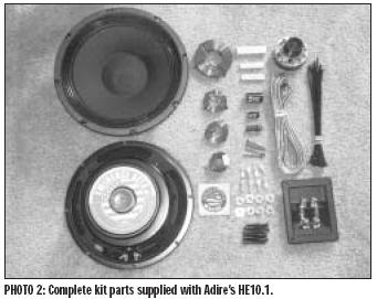

APT50 is the right driver. See photo (top right).

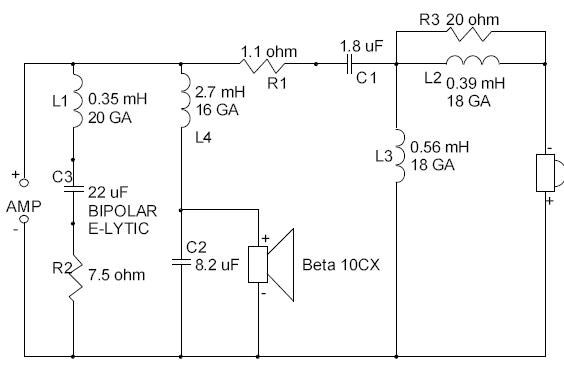

diyAudio Chief Moderator
Joined 2002
I did a little search for you. HE10.1 (the well reviewed first one) used what it looks to me like Eminence APT50 as various pics of constructors show and had a 0.39mh coil in series before the tweeter. Although its plans may say ACD1.
