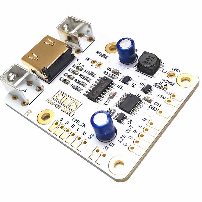

I need to convert HDMI to I2S signal provide to TAS3251.
Does anyone know what chip can be used?
I have found a board with this functions but I don’t know what chip to use.
Are there any compatibility issues with this board?

Here's part of my designing TAS6422 amplifier schematic.(Not evaluate yet)
I guess SOP device is DS90LV048ATM, and TSSOP device might be a 74LV541A or something like that...

Hi CyberPit,
May I know, is there any limit on the use of this voltage level conversion?
ex: cannot connect to TV, NB or STB .......
knee266-San,
This board is designed for DAC/Audio-Players which has LVDS-I2S Output. This format specification is just De-fact standard and it's different from Authorized HDMI(Such as Official Video products). If you want to connect with your DVD player, you need to buy a HDMI Splitter which have S/PDIF output and S/PDIF receiver for I2S output.
