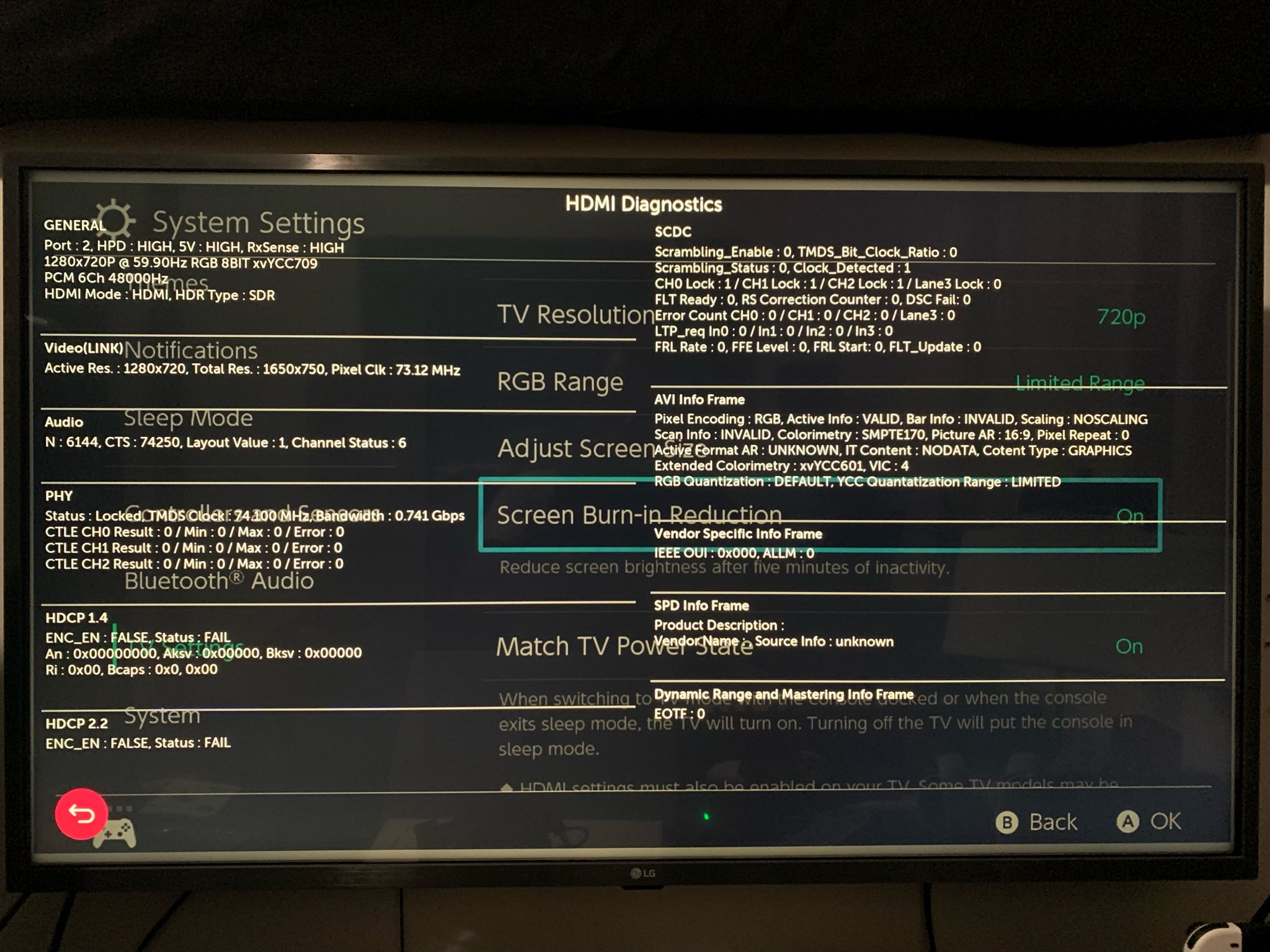

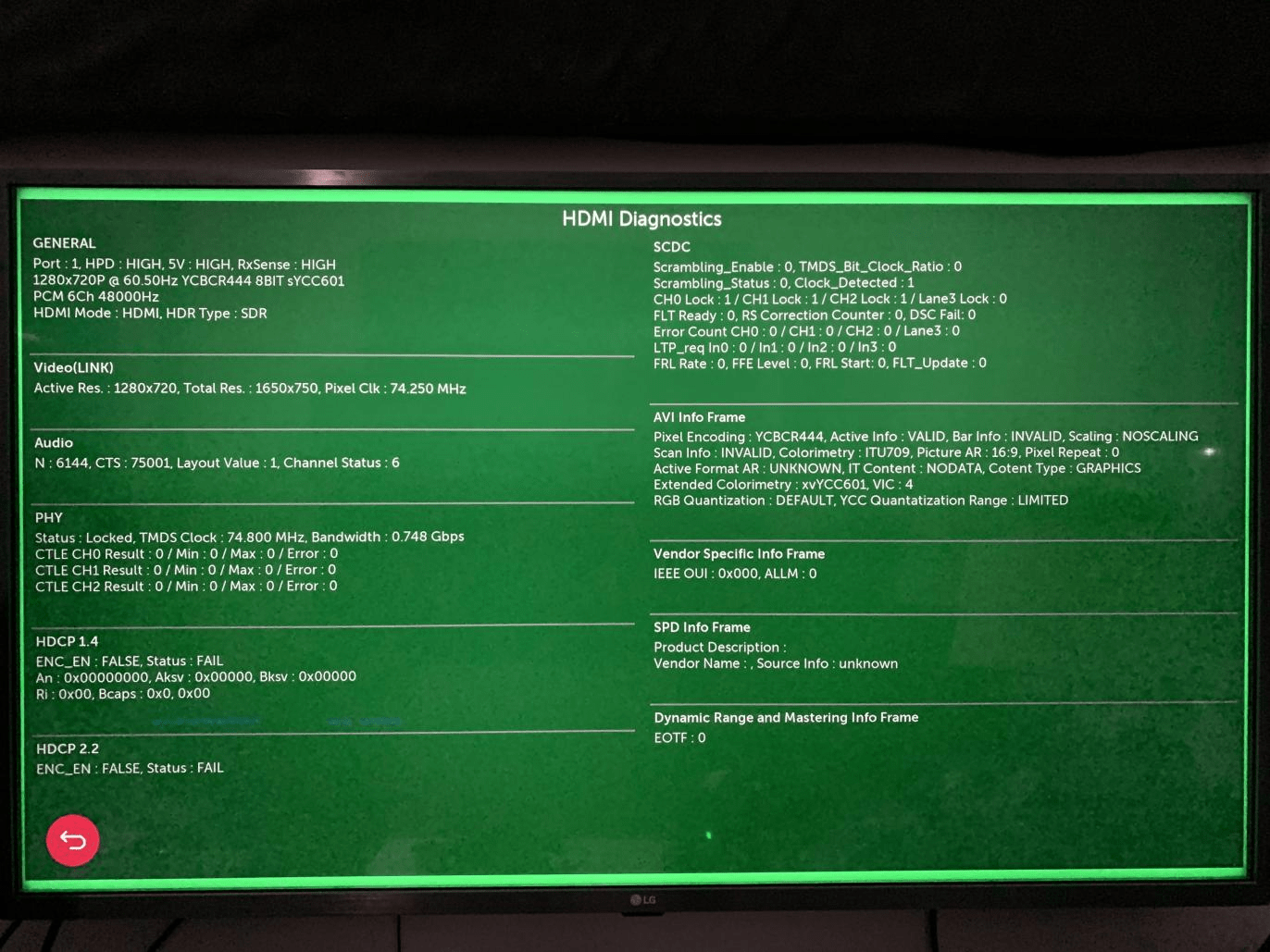

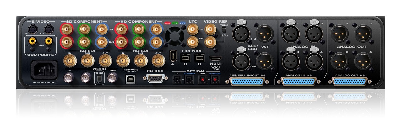

I finally got my MOTU V4HD in, and it converts 8 channel SDI to 8 channel ADAT no problem! The issue is that it doesn't recognize the signal from the 'Audio Only' port of the audio extractor I got from Aliexpress. I think it's because the video signal from it is 60.5Hz; (at least that's what my LG TV says).
So I'm limited to 720p until I find an audio extractor (or matrix/down-scaler) I'm reasonably sure with output an acceptable frame rate. (Also, the fan on the V4HD is a bit annoying. I'm wondering if I could swap it out for a quieter one.)
I'm not 100% sure what you mean. It's outputted from an HDMI port with a video signal, and the audio format seems to be exactly the same as standard PCM HDMI audio. The 'Audio Only' port works fine with my old Yamaha receiver, and it will report PCM as well.
Here's the diagnostic screen from my LG UM7300 for 'Audio Only':
Versus a standard 720 signal:
It's 'HD-SDI', and 720p works fine when using a normal signal (shown on the lower HDMI Diagnostics screen). The signal light on the AJA converter turns on with 'Audio Only', so I think it's an issue with the V4HD.
Anyway, I don't think there's any way for me to get this audio extractor working with my setup, so I'll have to try something else.
