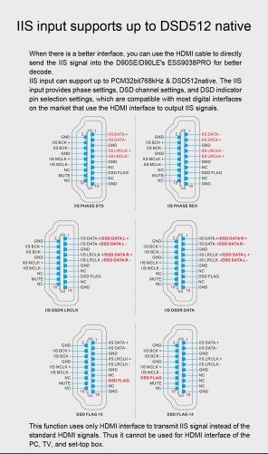

In my case Topping D90SE which has a HDMI / I2S, which is pin configurable as you can see here:
I intend to buy a 'HDMI to I2S box' and place it between my Sony UBP-X800 / HDMI 2 (audio only) and the DAC, connecting with two 1.4 HDMI cables.
I need to know the HDMI pin config for the Sony UBP-X800 in order to replicate the pin setting to the DAC / HDMI / I2S.

Some info on HDMI pinouts at:
https://www.electronics-notes.com/articles/audio-video/hdmi/hdmi-pinouts-connections.php
https://docs.google.com/spreadsheets/d/1h5PMUBkldkpt1rCnAR4ZHYGZNeCe-vwIFyKWYMZWsX0/htmlview#
However, if you want SACD from HDMI for cheap, its rather unlikely to happen. IIRC most of the cheap HDMI converters output 48kHz PCM only, even if people don't realize it. If the original source was SACD it gets converted to 48kHz PCM inside the source device, then is sent to the 'converter' box.

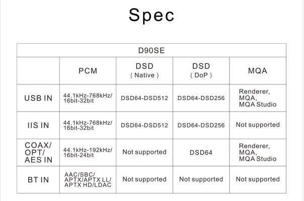

Aside from that, SACDs contain DSD data. DSD is more sensitive to jitter than is PCM so good clocks matter. Moreover, SACD is typically DSD64. IIRC there are also some at DSD128. The thing with DSD is that it doesn't start sounding really good until up around DSD256 and above (DSD256 is a sweet spot for some dacs). IME a well-recorded CD converted to DSD256 and played back with low jitter clocking typically sounds better than SACD at DSD64 or DSD128. Other people may disagree on that of course, just my personal opinion.

The issues as I see it comes down to if Sony UBP-X800 has a standardised HDMI (A) pin config (which, most likely, it has).
Next; does UBP-X800 send out anything but 48kHz PCM on HDMI 2 (audio only) ?
In the UBP-X800 'Audio Setup' I can choose 'DSD Output Mode' and chose 'Auto' or 'Off' for the HDMI - which indicate 'Auto' to be special - otherwise it makes no sense to give the choise in Setup.
What do you think ?
If all output was PCM 48 KHz - why give this choise ?
Is the conversion to PCM 48 KHz in itself a game stopper to get the I2S signal to the DAC ?

I have audio DAC Topping D90SE with eight chips ES9038PRO - should I avoid theses boxes for the same reason ? - or just change audio DSD output from Bluray Sony UBP-X800, to PCM instead of 'Auto' ?
