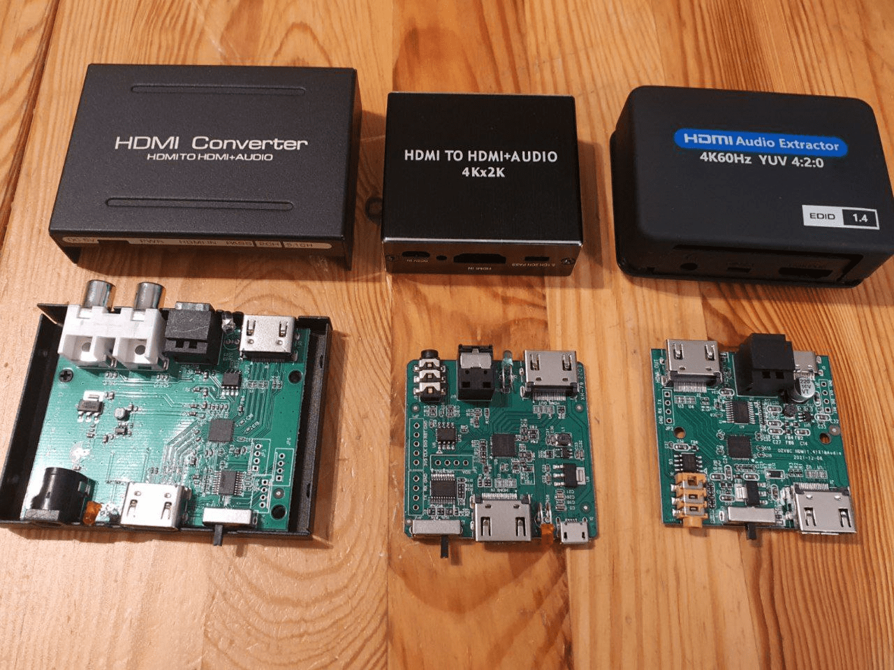

This is an interesting thread 🙂 I have three audio extractors from Aliexpress which I just cracked open:
From left to right:
  1. https://www.aliexpress.com/item/1005004614491741.html
  2. https://www.aliexpress.com/item/1005001497299425.html
  3. https://www.aliexpress.com/item/1005004750956100.html

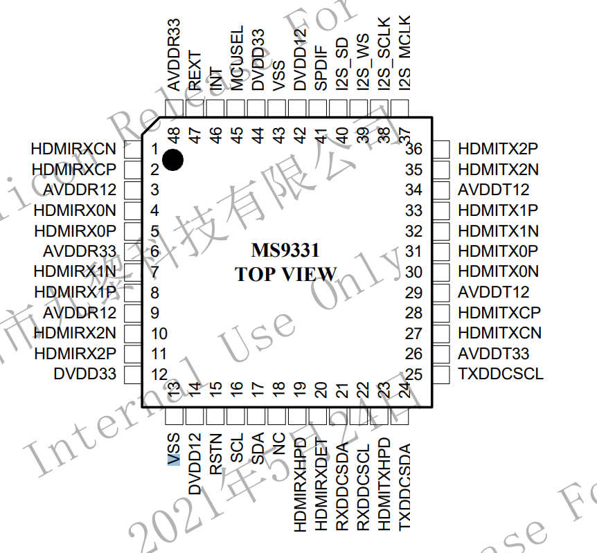

Upon further inspection, they are all based on the MacroSilicon MS9331 Chip. I have searched Google and Baidu for datasheets but there is zero information. All I could find was some general product information from some Chinese site, which I translated via deepl. I have attached it.
Pin 37 - 40 indicate I2S output which is routed to the MS7124 DAC on all three boards. I assume those boards could be repurposed for a cheap quick and dirty solution if you manage to break out the signals without EMC issues.
Now you might wonder why I have three of these boards laying around in the first place. The reason is simple, I all bought them one after the other and none of them really work. The first one only outputs audio when U turn it on before I turn on my projector, which is cumbersome because I have a central mains switch and the other two only let my source (PC) output 1920x1080i interlaced video.
I cannot find any more documentation on the IC, I would really like some I2C register documentation, because these seem to be configured incorrectly. The first one shows up in windows with the correct display EDIDs and the name of my projector which is great, the 2nd and 3rd one shows up with MS-HDMI-RTX, so these are easy to identify in case you don't want to crack them open.
So completely unrelated, I am actually interested which converters you have with the EP92A3E ICs. Can you post some links to buying them? I am this close to pulling the trigger on 10 different HDMI audio extractors which I already have in my Amazon basket and testing them before returning the 9 I don't like....
Cheers, Andre

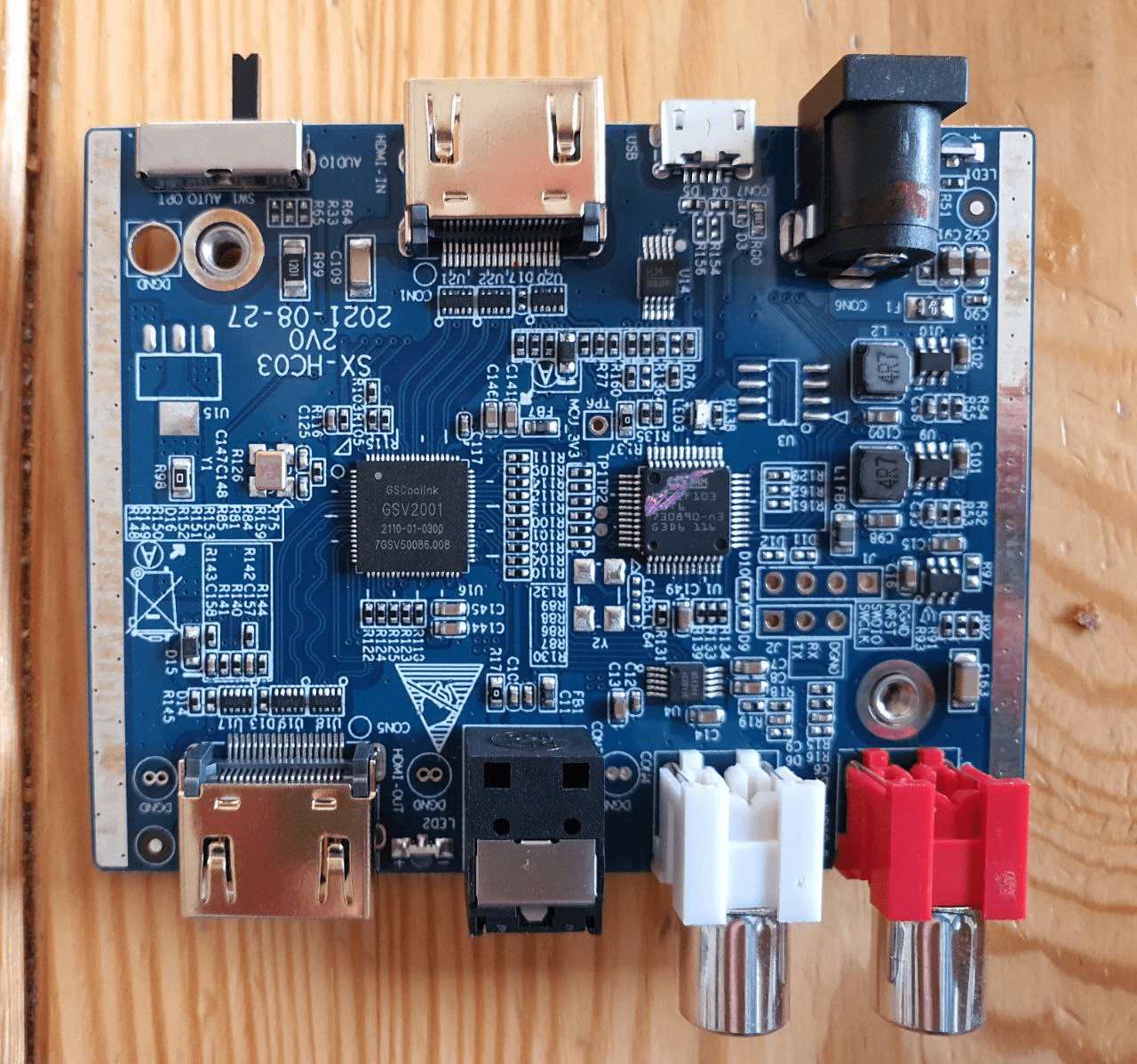

Thanks for posting the details. I wasn't able to get one of those on short notice so I spend a little more money than necessary and picked up a Lindy HDMI 4K60 Audio Extractor from a local store ... just to learn that at first, it also did not show up as an audio device in Windows 10.
Then I got really suspicious and recabled everything in exactly the same way and power-cycled all devices and ... it worked. Maybe it was a loose connection, or power cycling did a reset on some devices' EDID cache but in the end, the following two devices performed well for me:
  1. Lindy 18G 38361 HDMI 4K60 Audio Extractor (https://www.lindy-international.com/HDMI-4K60-Audio-Extractor.htm)
  2. HDMI Audio extractor 4K60Hz YUV 4:2:0 (third one in my post above)(https://www.aliexpress.com/item/1005004750956100.html)
I am using option 2 productively now, because it can be used without an external power supply, which all other devices I have tested so far fail at.
In any case, I immediately took the Lindy box apart and discovered yet another Chinese IC: a GSCOOLINK GSV2001. I searched for a while and could find no information whatsoever, not even a simple pinout, but here is a shot of the internals:
The MS4344 next to the Chinch out is yet another ADC that accepts I2S; you can clearly see the traces. THE ??32F103 is an Arm M3 Microcontroller from another Chine manufacturer. This device is firmware upgradeable via USB, but I couldn't find any firmware on the Lindy homepage, so maybe they added that as a precaution. This is probably what makes this thing so expensive.
Cheers, André

Apart from the Lindy one, the other devices do not really have a way to update the firmware by the user. All three devices from my first post worked differently in my setup, that's why I suspected the factory configuration of the IC to be differents. If there would be any actual datasheet or application note for the IC, we could at least talk to the chip via the I2C bus and change the configuration to see if it fixes anything. But without proper documentation, no way. AFAIK you can't just get the chip to spill it's secretes over I2C without knowing what to probe for. And that information would be in an actual datasheet which is likely under an NDA given the scarcity of publicly available information.

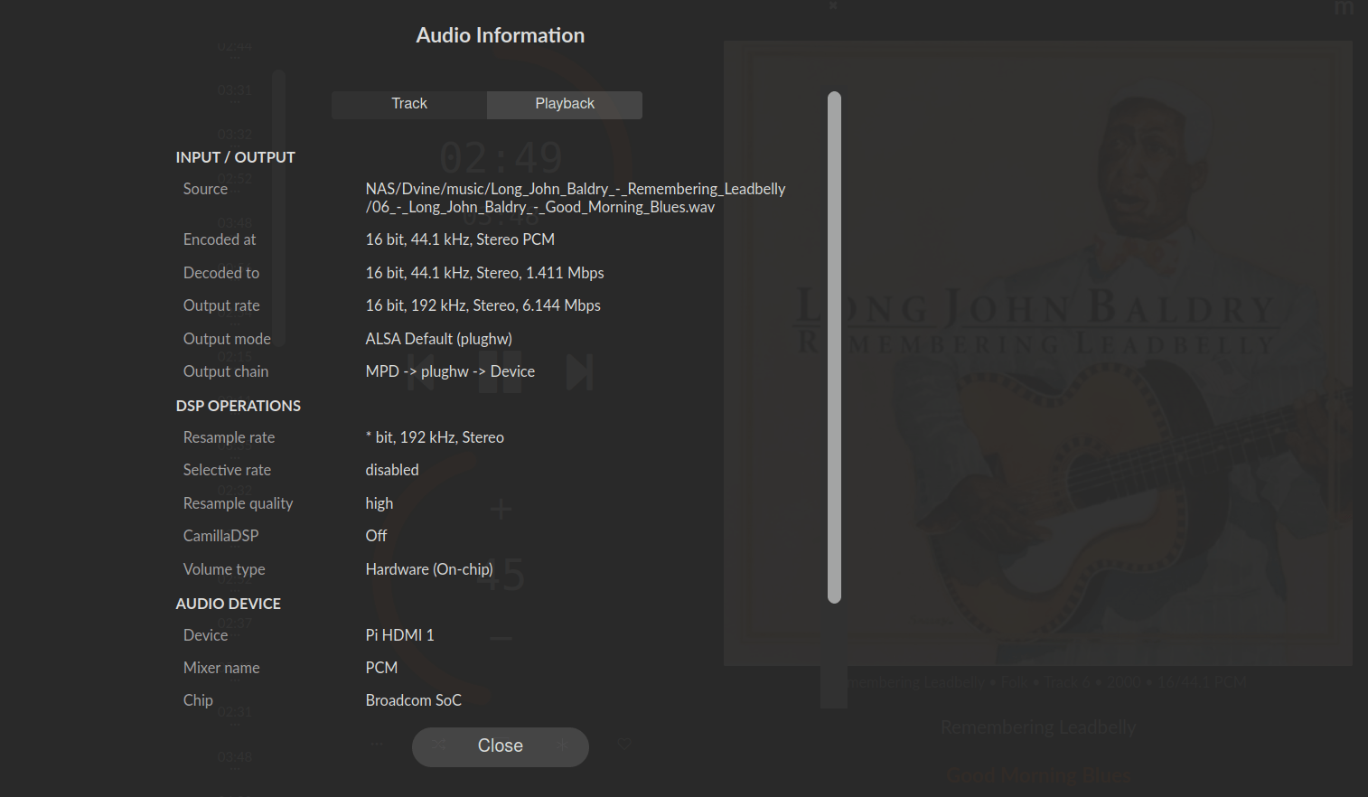

Maybe this one...which I have and just tried. Could not get it to de-embed without an attached screen (contrary to their advice) however, with an HDMI-4K dummy plug all worked.
Max 16 Bit @192kHz.
Raspberry Pi Zero 2W running latest MoOde Audio and using SOX to resample.
Tested the 3.5mm output and tomorrow will try the Coax out (fingers crossed for higher bitrate)

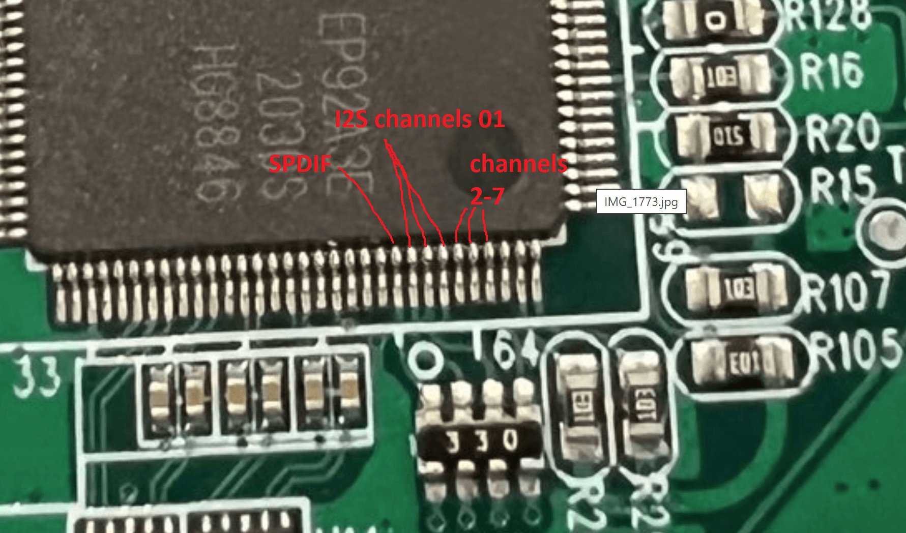

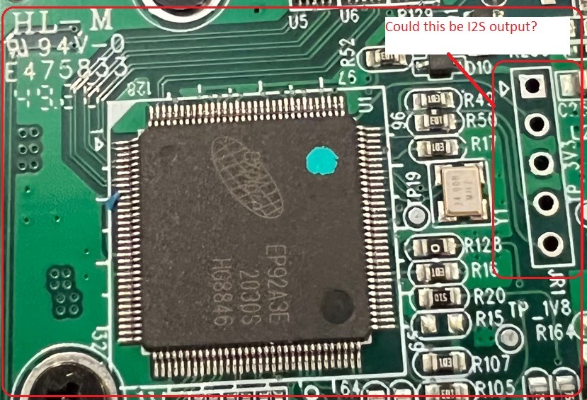

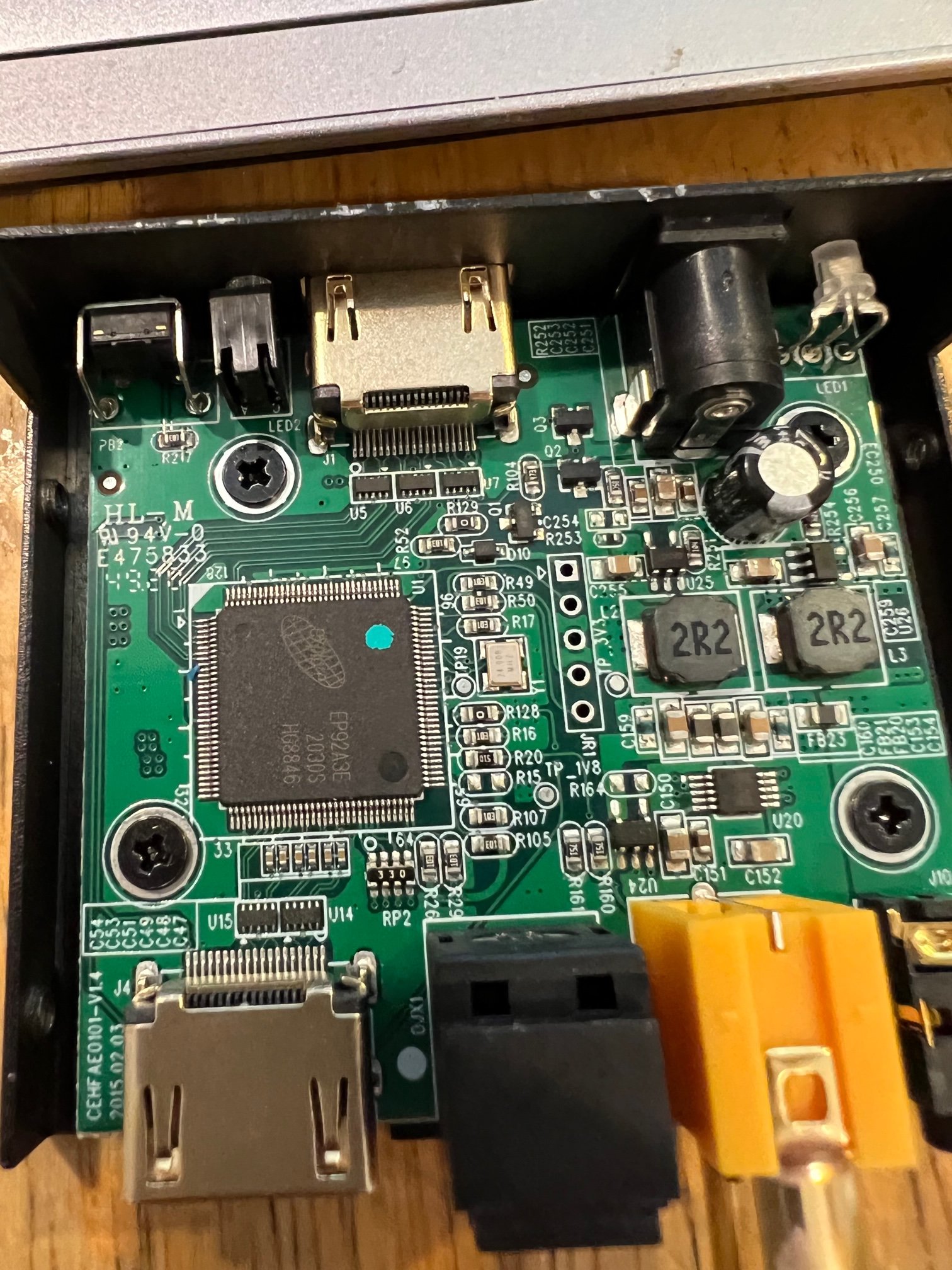

I'm looking to feed I2S from HDMI audio or specifically the ARC port of newer televisions to a Twisted Pear B3pro. After looking around a while I realized there's nothing out there (that I could find) diy wise that could do it. So I knew there were plenty of audio extractor boxes, most of them were toslink. If I was going to compromise I would use coax spdif out from one of these boxes. I had one of these from Amazon basics that cost $20 and it did the job well feeding my receiver for a few years. I decided to take the cover off and see what was insideView attachment 1084986
I looked up the chip inside and found out that it is made by this company
https://www.semiconn.com/ep92a3e
The cool thing is that is has I2S output but I could not locate a data sheet to see what and where those pins might be. I've sent an email to that company to see if they'll send me one. If someone knows where to find it please post it.
What's even better is this set of pads labeled JR1 has the right amount of pads for I2S. Could this be I2S? The unit in question is here
https://www.amazon.com/AmazonBasics-Audio-Stereo-Extractor-Converter/dp/B07KRWYN4R/ref=sr_1_1_sspa?crid=1CD2F4FRBU141&keywords=hdmi+audio+extractor&qid=1661568784&sprefix=hdmi+audio+extractor,aps,117&sr=8-1-spons&psc=1&spLa=ZW5jcnlwdGVkUXVhbGlmaWVyPUFRSFkyS0NVMUdXODYmZW5jcnlwdGVkSWQ9QTA2ODc1OTIyQ0pZM0UyVlNUR1I0JmVuY3J5cHRlZEFkSWQ9QTA0MjczMDMyUUFISE82S0UxVjZSJndpZGdldE5hbWU9c3BfYXRmJmFjdGlvbj1jbGlja1JlZGlyZWN0JmRvTm90TG9nQ2xpY2s9dHJ1ZQ==
I don't have the knowledge or tools to try and figure out what JR1 is. Does anyone have a schematic of this unit? I would think it's mass produced under several makers and models.
Any thoughts? Help?

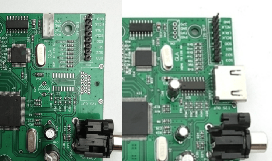

btw, to OP, i guess (and hope) it is not relevant anymore, but just in case, i believe the i2s pins on the amazon basics extractor are:
Yes, I found the schematic in the service manual of a soundbar with detailed pinout. Also have a modded hdmi extractor based on the same chip as multichannel spdif output for a raspberry pi. What I don't have is a datasheet.Let me know if you are interested.
Yes, I'd love to see it if you can send it. I really want to add some PCB to get at the raw 8 channel I2S if I can. I'm using a Dolby Decoder IC, but it's a bit dated and the HDMI approach seems a lot more flexible. I have some datasheets around for various ones, so if I can send you anything I'll try to. But drop me a DM if you can send me anything, thank you!
