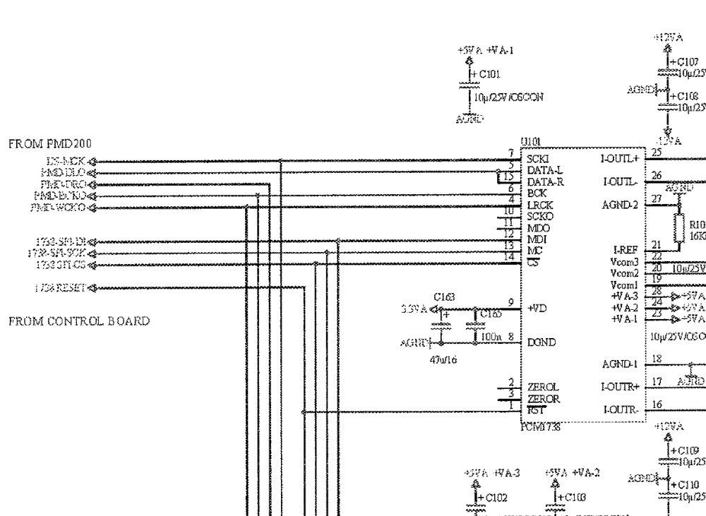

This Classe CDP10 used the PMD200 and then used 2 x PCM1738's in quad diff output it has 8 x i/v amps!!!!.
I also have a Cal CL15 that uses the PMD100 with dual PCM1702's
Red Book verses HDC the Classe CDP10 has a bigger difference between the two discs. The PMD200 showing it's better sounding and has the bigger difference than the PMD100.
