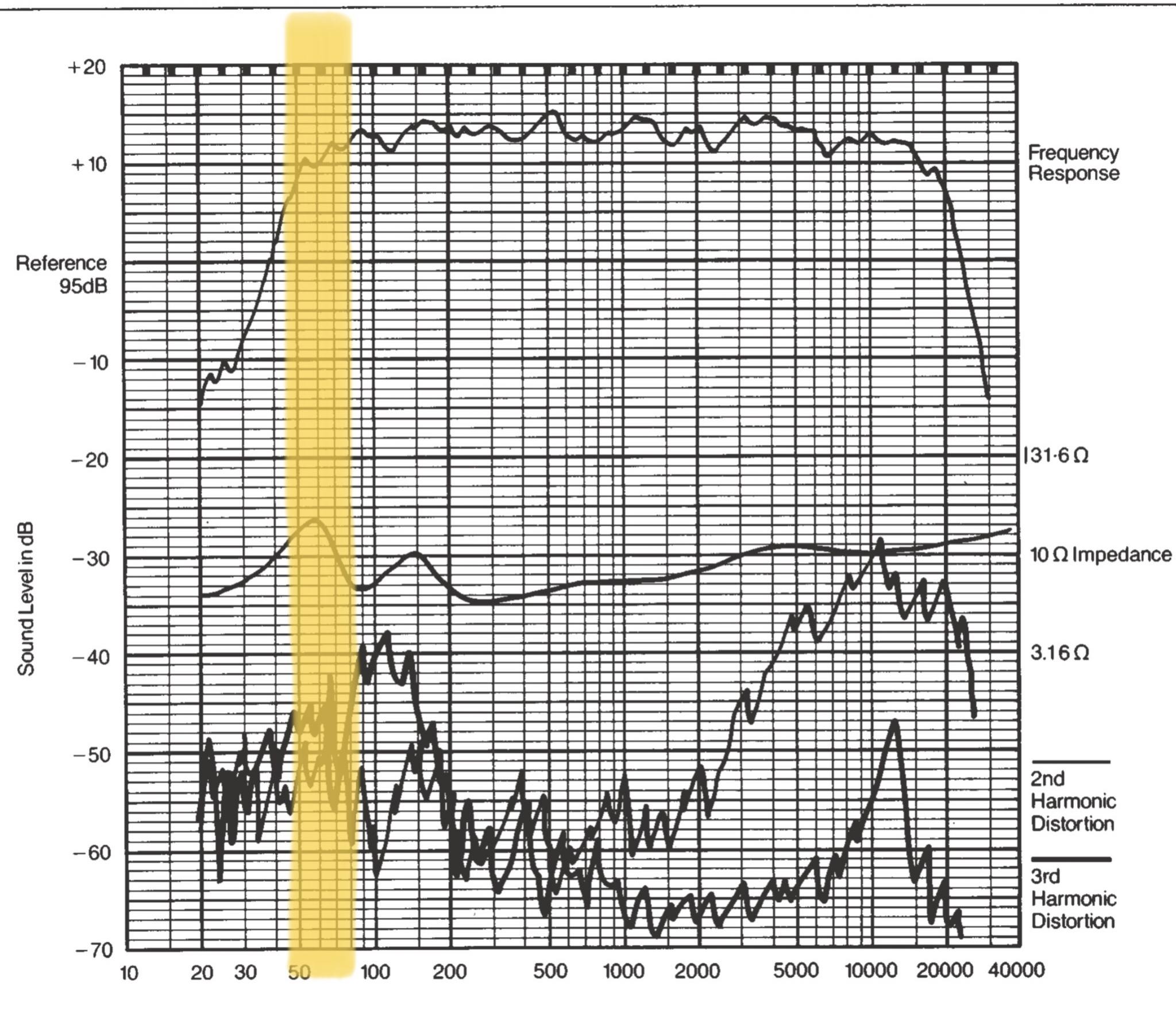

Well after going back and checking the old Turbosound info. It seams if you read the fine print And check there own graphs there 45hz clams on the tsm4 Are well off and only just reached 55hz.... with the TSE2x15 that I’m trying to copy with the HD2x15 it calmed 60hz to 500hz, unfortunately they didn’t print a graph with it, but if you look at the TMS3 graph witch is identical to the TSE2x15 in every way, just had 2 tse111s glued to the top, it does reach 60z, maybe 55hz at a push.. I think with modern drivers it could definitely do 55Hz to 250hz.

I know from experience that you can't. I used those old Turbosounds, and they are not fit for the bottom range, they are midbass aka kickhorns (90 to 300Hz) that needa sub below them. If you want a W bin as sub, you need something bigger like those EAW's.
