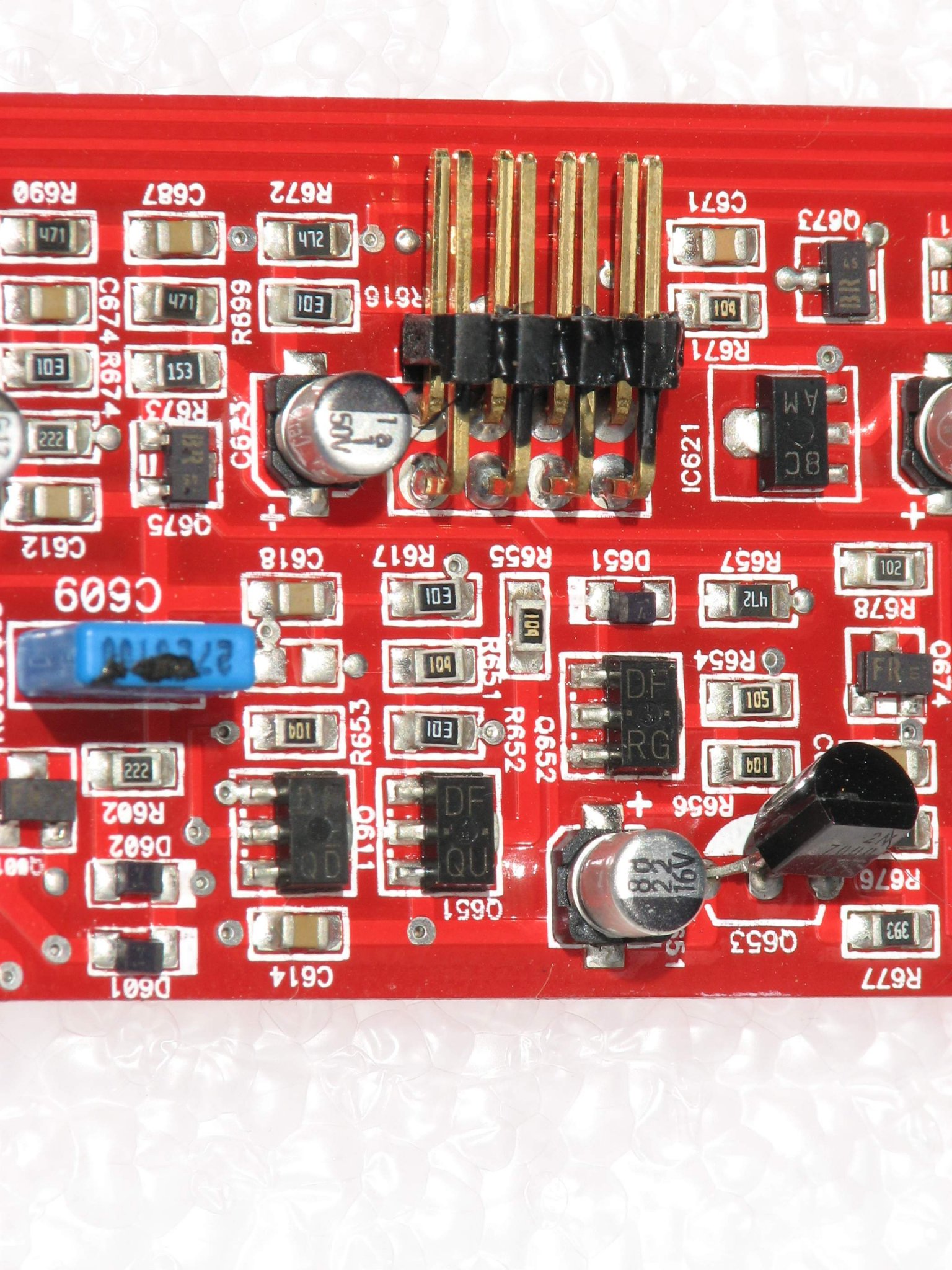

P punch45x2 Member Joined 2020 2022-12-01 11:01 pm #1 2022-12-01 11:01 pm #1 Hi guys. Getting ready to work on an Orion hcca25001 and the power supply card is missing a component on the power supply daughter board. The silk screen is messed up but it is q6-- something. Any help is appreciated pic is attached Attachments 16699355320136271150367289362881.jpg 472.4 KB · Views: 87 16699355609802947529380312164968.jpg 403.9 KB · Views: 95 P Perry Babin Member Joined 2003 bcae1.com 2022-12-01 11:23 pm #2 2022-12-01 11:23 pm #2 From a smaller board but very similar. Compare to the adjacent parts in your board. Attachments IMG_9530x.jpg 501 KB · Views: 57 P punch45x2 Member Joined 2020 2022-12-01 11:53 pm #3 2022-12-01 11:53 pm #3 Appears correct is that a 2n7000? P Perry Babin Member Joined 2003 bcae1.com 2022-12-01 11:56 pm #4 2022-12-01 11:56 pm #4 It looks like it to me. You must log in or register to reply here. Share: Facebook X (Twitter) LinkedIn Reddit Pinterest Tumblr WhatsApp Email Link
