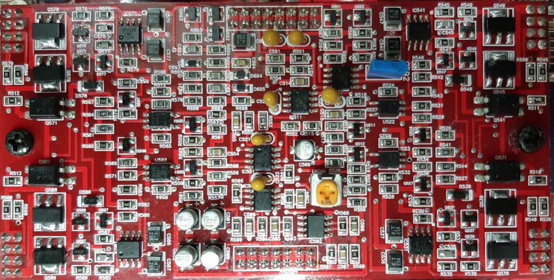

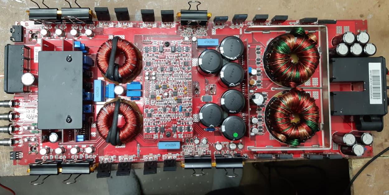

This amp (Orion HCCA25001) came in after another repair shop gave up on it. Not sure what all they did cause when it came in, not even the power supply was working...
I now have power supply working. I replaced the drivers on the output card as well as outputs and some gate resistors that failed. I also replaced all 10 regulators, and the 4 transistors that mount to the heatsink, just to be safe.
Once powered up, I get the blue protect light blinks a couple times, then comes on solid after the soft turn on click. Stays solid for a bit, one quick blink and stays solid again. Amp pulls about 1.8a of current.
With no remote I do notice there is 0.1a of draw just having it connected. Not sure if that's a thing or not. IC793 does run even when the amp is off. Soon as main power and ground is added it turns on. 5v reg for something...
I do get a wave on the gates of Q311, Q313, Q371, Q373 once the soft click happens but not on the other 4 outputs. I've never worked on one of these before, so not sure what's going on with it. 🙁
Anyone familiar with the protect light staying solid blue? with a slight quick flash once and awhile?
Thanks in advance.

I have essentially no experience with these so If I don't help, it's not because I'm ignoring the thread.
Some of the amps of this series had problems opening the 10 ohm resistors on the output of the regulators.
The clipping behavior of some of these amps isn't as expected. I've never seen a solution.
I had one of these successfully repaired. I'm glad all of the PIC/DSP and the crazy IC's were in good condition
Check my thread here -
Orion HCCA 25001 - resurrection issues
I had to replace all of the voltage regulators and respectively all the resistors in the circuit.
Also replace ALL the gate resistors in output section. In my case 2 of them read as they should on the DMM, but the gate drive could NOT pass normally.
I don't remember anything about LED flashing.
