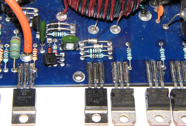

Ok. I installed some irf3205's today and replaced the 56's and 06's. As soon as i go to power the amp on it blows my 10 amp test fuse and the power supply outputs get hot instantly.

There is one rectifier on each side of the sink. This one is marked U1620R. Yours may be a different number. There shouldn't be an FET in that location.
Is this board layout the same as yours?

Is It possible that my board never had these? I looked threw the stack of what I took out at unless i lost it I never had then in the first place.
This is a Revision D board And the serial is 4840954. If that helps.
I took a second look and my board is different.
Can you send me a photo of that area of your board?
