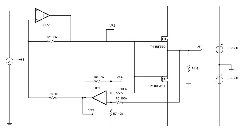

Did you already have Spice results?
I like to comment on this:
- The error correction loop is a positive feedback loop (as it is the way Hawksford described it). Therefore, the stability depends on the neg feedback gain staying higher than the pos feedback gain. But that should be clear in the sim. If the output sticks to one of the rails, there trouble in paradise.
- The original Hawksford error correction avoided some stability problems by keeping the pos feedback loop gain exactly one. Your IOP1 has a gain of one, but the IOP2 doesn't. At least, that is what I assume, I don't know what that device is of course. So if you want to use the original Hawksford error correction you should bring the output of the IOP1 directly to the IOP2 input without resistors, and specify IOP2 as having a gain of one. (I can do that in the Proteus sim, don't know if you can).
Then you will see indeed a perfect gain of one amplification, independent of the load, independent of the active devices. (Assuming ideal error-less IOP's). Of course, changing to real-world opamps etc will cause it's own errors.
Jan Didden

Both op-amps are 'perfect' parts with infinite gain. I have results from 'TINA-pro' and I'll try it also in B2SPICE.
As it's so simple it's easy to put it into your version of SPICE to try it out.
I don't see any stability problems, but using real op-amps (OPA445 for the driving high-voltage part, and OP27 for the error amp) then the error-correction falls off quickly as the frequency increases.
By the way, the value of the 1k resistor (R8) feeding the output of the error amp into the summing junction is critical. If you do a distortion analysis with the correct value, and then vary the value slightly each side the distortion rises quite quickly. This is to be expected with error-correction I guess.
IOP1 (the diff amp) has a gain of 0.1 (10k and 100k resistors).
This matches the gain around IOP2 with the values of R2 and R8 as shown.
(A gain of 0.1 in the diff amp allows a standard +/-15V rail to power it) IOP2 has to be a high-voltage part of course.
I'm looking at this architecture to see if I can devise a power amplifier circuit to replace the amplifier boards in a couple of Quad 405 amps I own. I would like to keep the zero-bias output stage but replace the Quad 'current dumping' with an error correction version.
