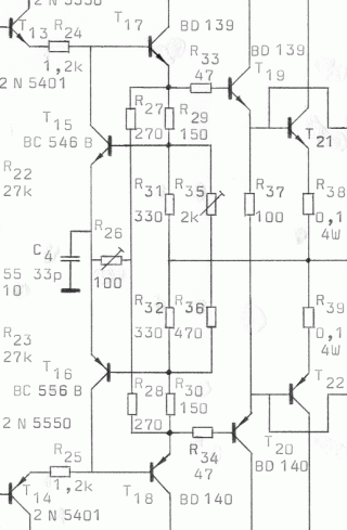

A compensation needed?
Hi Hawksford’s gurus!
I need some advise in my last amplifier http://www.diyaudio.com/forums/attachment.php?postid=747297&stamp=1129732489
It seems to all work fine, the amp is stable. Bottom I attached 1 kHz square wave test with 6.8 uF with 1 ohm in series at the output.
Regulation of the error correction (EC) is working well by trimming pot R26 (470 ohm). In the range of audio frequency EC is very stable and after adjusting I can not observe any differences between output voltages with 2 ohm and without any resistance at the output of the amplifier.
But with the rising a frequency much more than 30 kHz the correction increasing also and than a voltage without load is slightly greater than with a load. But amp is still stable and all works fine.
Is here a need a frequency compensation for error correction as I see in Cordell paper or Steven design at http://www.diyaudio.com/forums/showthread.php?postid=330446#post330446 as a capacitor from emitters biasing transistors to the ground? If so, what value should I start?

Thanks Jorge and Steven, I will try.
Do you think if this really necessary? Why do not have better damping factor for tens and hundreds of kHz?😀

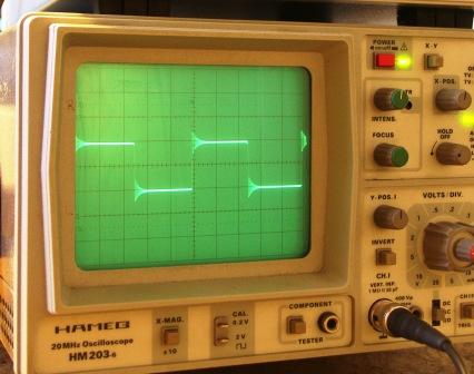

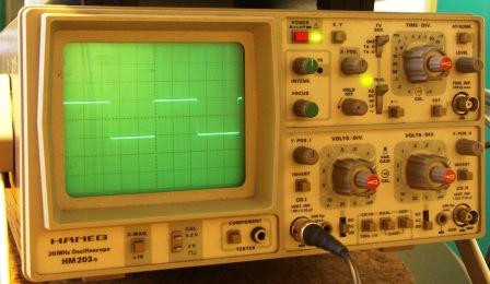

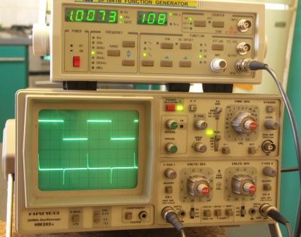

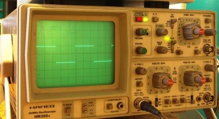

Hi Jorge and Steven,
I tried caps (from 22pF to 150pF) from emitters of biasing transistors to the ground but it did not solve the problem. The capacity of 150pF was too much and there was an impact to frequency overall.
I finished with 180pF capacitors across collectors and bases these transistors and it seems to be a better solution. There is a slight increasing in error correction in the range of 100 kHz to 200kHz. Beyond that, EC is decreasing. I didn’t see any oscillations and amp is very stable. Driving a capacitive loads is not a problem. Up to 100nF no ringing. I have tested the amplifier with different capacitors and 4 ohm resistor at the output.
The first picture:
Signal: sq. 4kHz and 33nF
The first picture:
