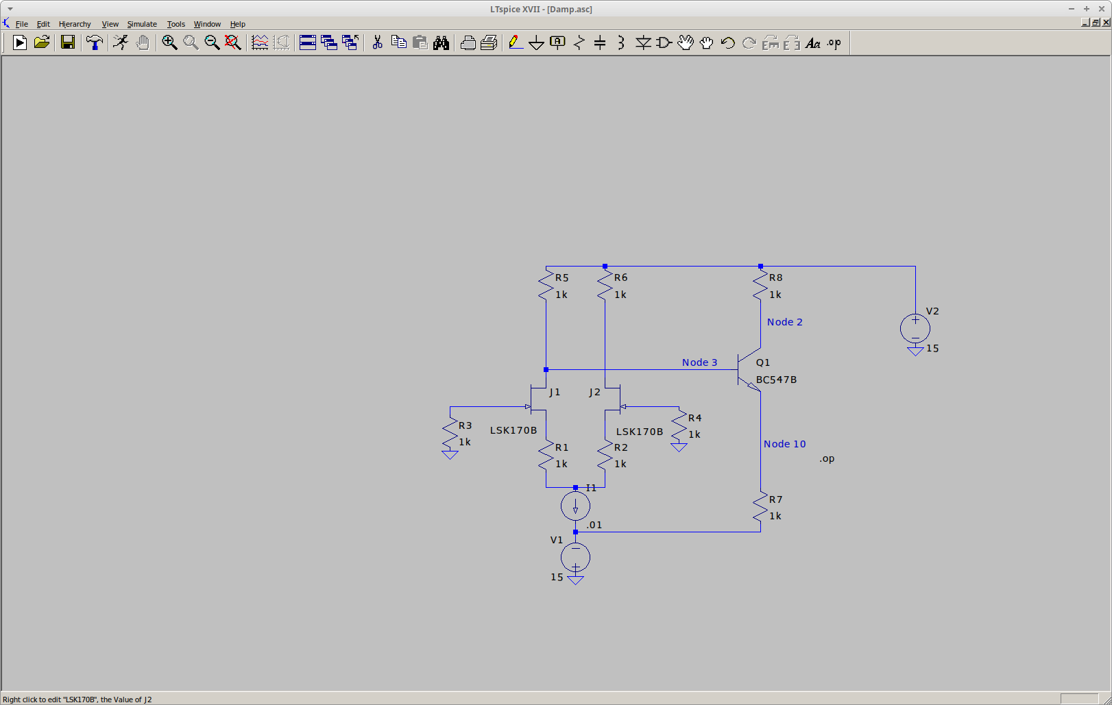

When the inputs are balanced each JFET is conducting 5mA. That translates to a 5V drop across the 1K load resistor(s). So you have (about) 10V on the base of Q3, producing a 25V drop across R7. Neglecting base current in Q3 that means you have a 25V drop across R8, so Q3's collector will be equal to (15 - 25) = -10V. This means that Q3 is in saturation because the base-collector junction is forward biased: Vb = 10, Vc = -10.
This is all just back-of-the-napkin. The voltages won't be correct because once Q3 goes into saturation the effective resistance at Q3's base will be much lower than (beta *Re).

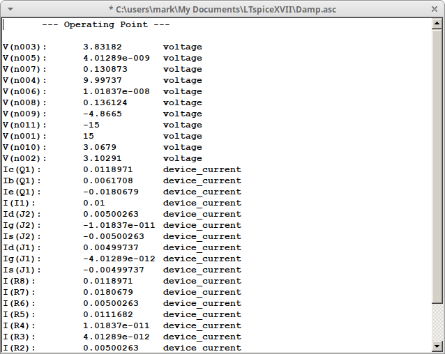

To confirm my hypothesis, I did a quick simulation:
Here's the schematic:
In this simulation, Node 2 is Q1's Collector, Node 3 is its base and Node 10 is its emitter. Vc = 3.102, Vb = 3.831, and Ve = 3.0679. From this we can see that Vb > Vc so yes indeed, Q1 is in saturation.
Your amplifier will never work with the values given. You will need to change resistance values and/or current source and/or supply voltages in order for it to work the way you wish.
This is why some basic evaluation, A.K.A. "back of the napkin" sanity checking is helpful. At least at first, until you learn a few things about circuit design.
Good luck with your quest, and keep on trying!
